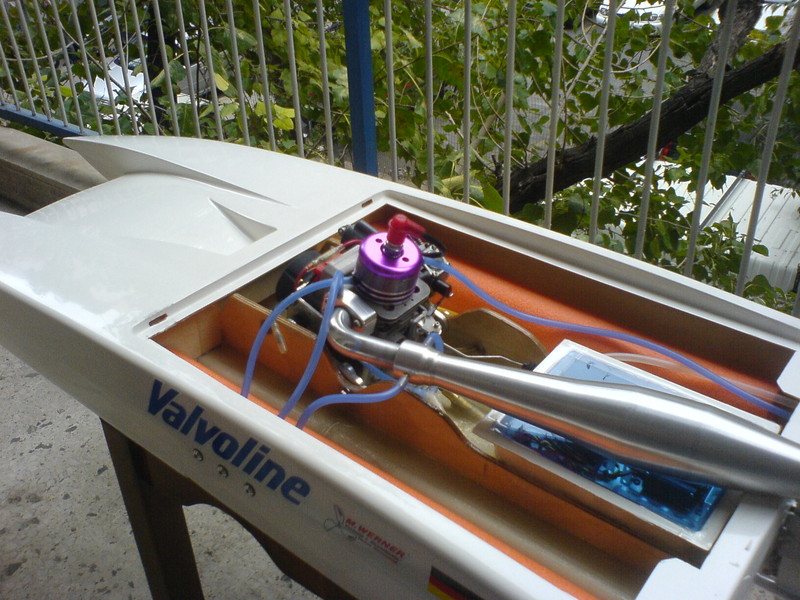

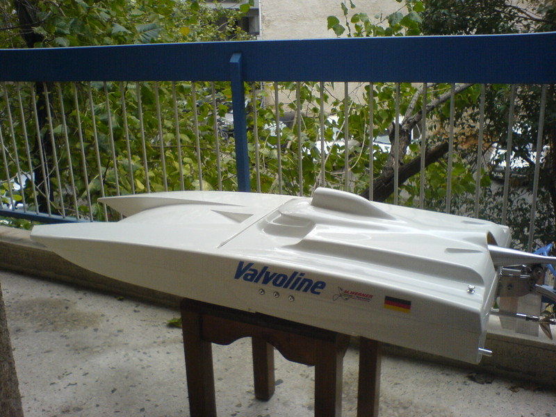

margi replied the topic: Re:Conquest Help needed....
Finally it is ready..Hope you like it..Not painted though:(

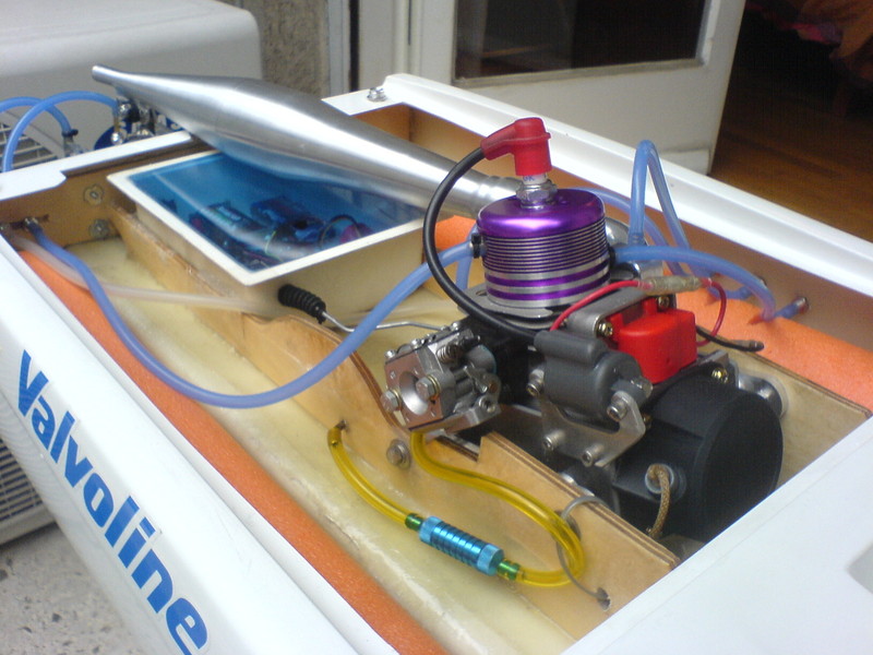

And from the inside...B)
Another Point of View..Sergey I am waitng for your comments..

marc replied the topic: Re:Conquest Help needed....
Boat looks great! Pipe looks very close to the radio box lid, but that could be just the angle of the pictures.
#4831
Thank you very much Marc..:) It is the angle that makes it look so close..;)

Glad to see a finishing part, thank you for your trust also. Fine work, well done.
Fresh, clear and clean, no any dirt would will find a place what to hide in the clear inner area. I like it!

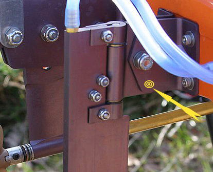

You have a hot engine and hot pipe, please provide a cooling inlets. 1x3 cm hole in the front area is enough for engine. Do not forget about header and pipe also. 1 cooling window must be.
For additional fixing of rudder (for avoidance of problem and hardware bending), you can add 1 non-hardening M3 [1/8"] bolt. It's easy and work well. ( sorry, I place a pic before bolting.)
excuse me for extra tech- tips ;)
