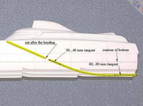

Ok Sergey..I will upload more photos when I have done more work on it..Tell me something else Sergey.In order to bend the brass tube, should I heat it first?If not, how should I bend it?:huh:
#4617
Zitch replied the topic: Re:Conquest Help needed....
Marios,
never use a heating! only by hands.
Before bending you must have a normal hole in the hulls bottom.
Also you must have a strut on the transom in proper position. I take a tube both hands, and very accurately with bid fingers start a bending in the place, 100-150mm after rear side of tube. No any local, very strong direct pressing! Only soft moving!
Important, what for avoidance of overbending, please seat for first time, fix your hands with help of lags and belly. ) please do not LOL ) Each 3-5 degrees with control on place.
After the bending you can cut excess part of tube. For first time cutting, please, stay a 10-15-20 mm of vestige, for spare case... After the full control and checking your tube, you can cut a vestige.
Small tip.
If you ordering a long tube with cat / boat, you have a chance to get a 2 normal flex shaft tube ;)

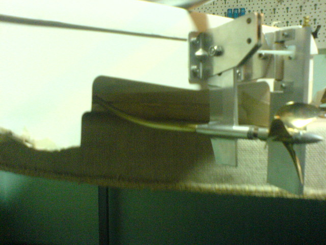

margi replied the topic: Re:Conquest Help needed....
Sergey new pictures from the Conquest..

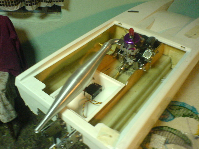

#4728
We haven't yet glued the radio box..

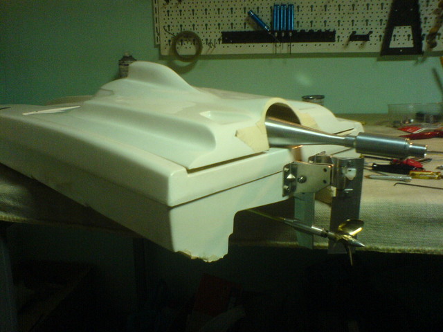

#4730
#4731

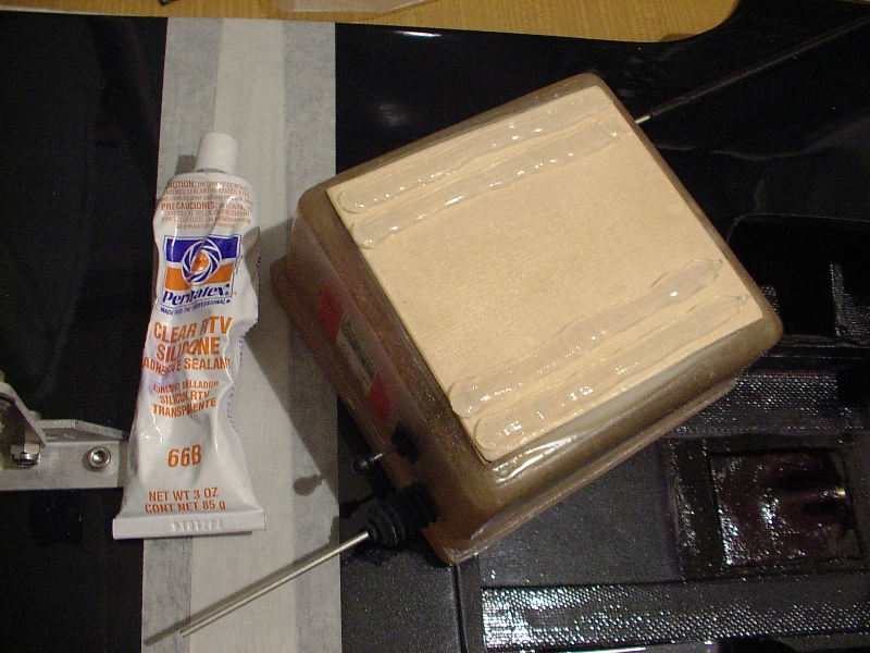

Hi, Margi,
Wonderful !
If you want to try a semi permanent method of radio box fixing, please use a PERMATEX 66 silicone. For change, repair, or same, you can remove it without rest, with knife or steel stick.
Please do not forget to use a fixing glue for hardware bolts. Without tread lock it unscrew...
