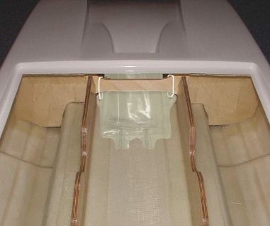

Hi Zitch..I have seen many of your works in your site.Great work you have done.Where exactly have you placed the fuel bag in the orange Conquest??Thank you..
#4515
Zitch replied the topic: Re:Conquest Help needed....
Hi Margi,
glad to see your interest!
I find no any good view photo and I try to make a "photo" with tank. 10 minutes work in the Photoshop )
#4535

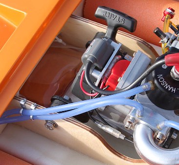

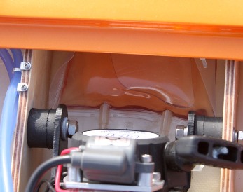

Margi,
specially for you - 2 fresh photos of tank. No problem! 10 minutes run with full throttle.
And, I want to say, I am DONZI addict man ) and I have a several ideas and experience with DONZI 49. If you decide to build it, welcome!
#4561

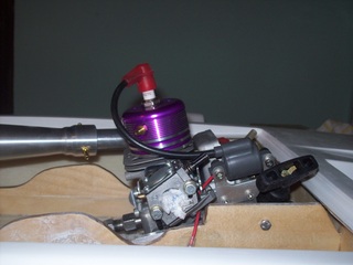

margi replied the topic: Re:Conquest Help needed....
This is where I placed my Butch engine with the regular Aeromarine mounts.
#4589
Hi!
How I find out, the engine have a short limits for mounting. So you can have a problem with cover. If you do not hesitate a big holes in cover, no problem. But a holes - is way for water also...
With orange cat I met problem with long carb's needles. I cut one (outer), but second needle, on maximum engine walk, beat in the cover.
May be, a coil will need to moving also.
I am recommend you a moving engine back, each mm with checking of cover, and fit a big flat washers under bolts.
With best regards
Sergey
#4601
Hi Sergey.We have checked the cover and it closes very well with the only problem being the recoil starter,but we found a solution to this problem.You are right about the flat big washers.We haven't put yet but we will..Thank you very much for your interest:cheer: .Marios
