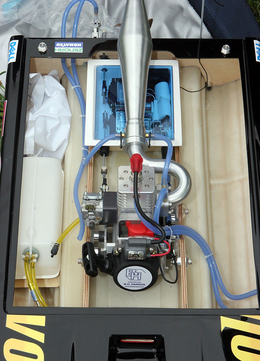

Hi guys!
this is my building,
the black cat I build for client which love to run along and a huge time.
Usually he runs a gallon of gas mix per day. No any problem with engine fuel feeding.

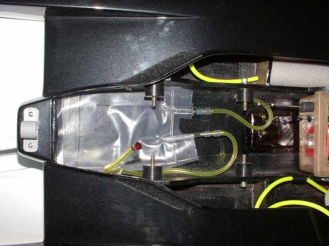

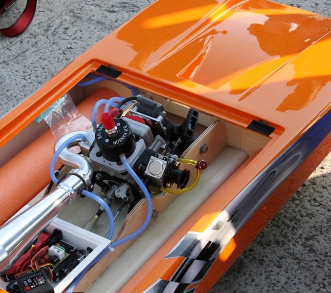

I place here a new project with new fuel sustem, Orange Electric Conquest cat, for newbie, which runs a short time. I use a 16 oz fuel bag from Hanson. No any cut off of wood needed. 2 nylon band, 1 short line of gas tubing.
Also I place a photo with my Hydro fuel bag. Thanks Marc for good review of yellow Insane!
