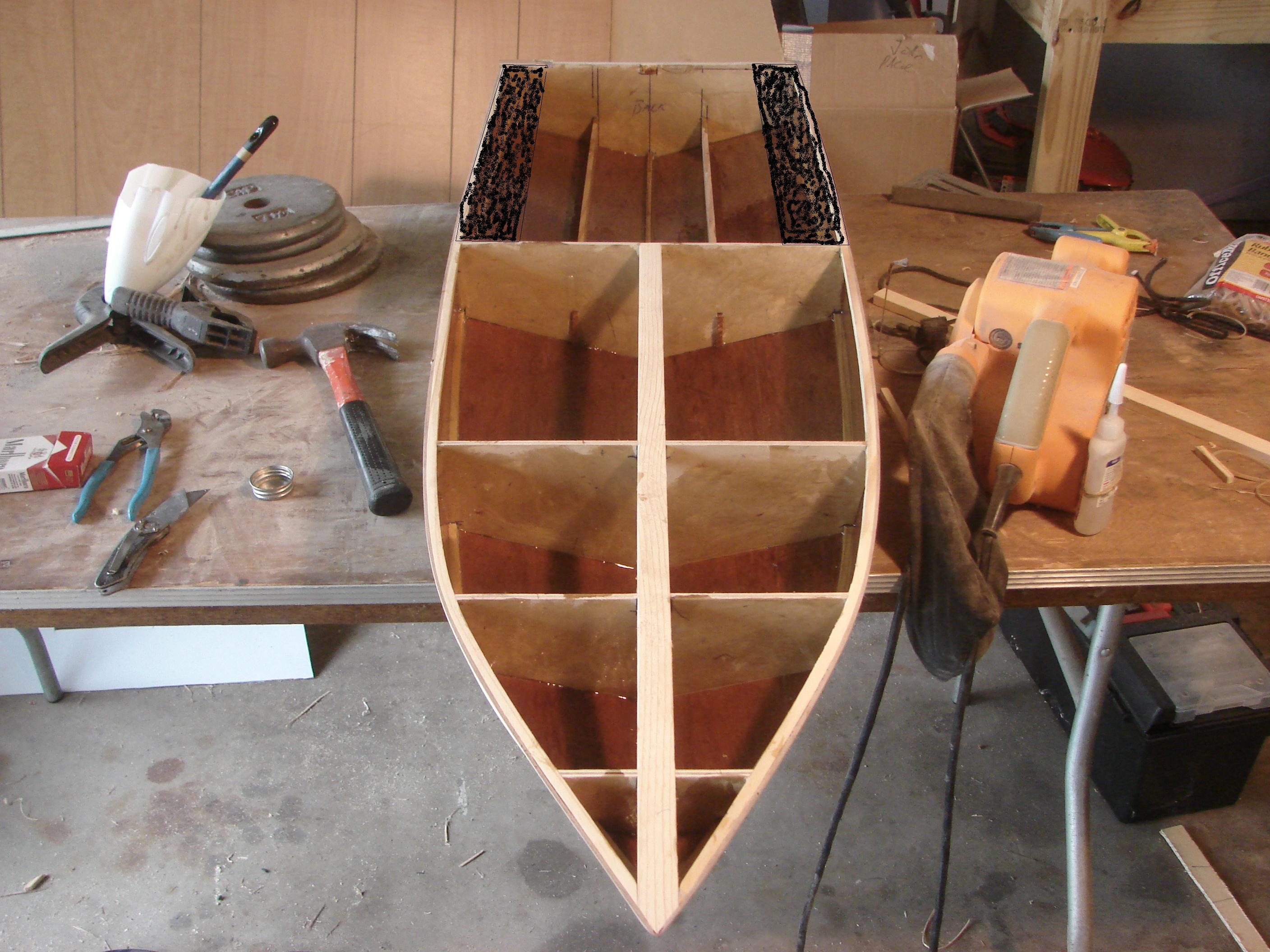

isuzudude replied the topic: Re: A Simple Plan!
If the inside of the sponsons is set at 5", Weedies are a little wider that Zens and others... So you might have to widen it out, maybe leave about 2"- 2 1/2" around the outside, and the rest opened up.
#13912
Maybe something like this...I know it's a mono, SORRY!!!!
#13913
Then make a cover hatch that closes in tighter around the engine, that can removed for access to install and work on later... B)
#13914
Ozpulse replied the topic: Re: A Simple Plan!
Ah! the inside of the rails is at 6" now! ;)
I should have put some dimensions on the plan!lol
When I build the first one and find the balance point I will add the cutaways to the rails.
A Homie should slip straight in at 6" the 30cc I have here will anyway! ;)
Will also do another plan with the rear cut down for those who dont like the boxy rear end. But hey its supposed to be a simple quick build so we can get down to the fun part! :laugh:
