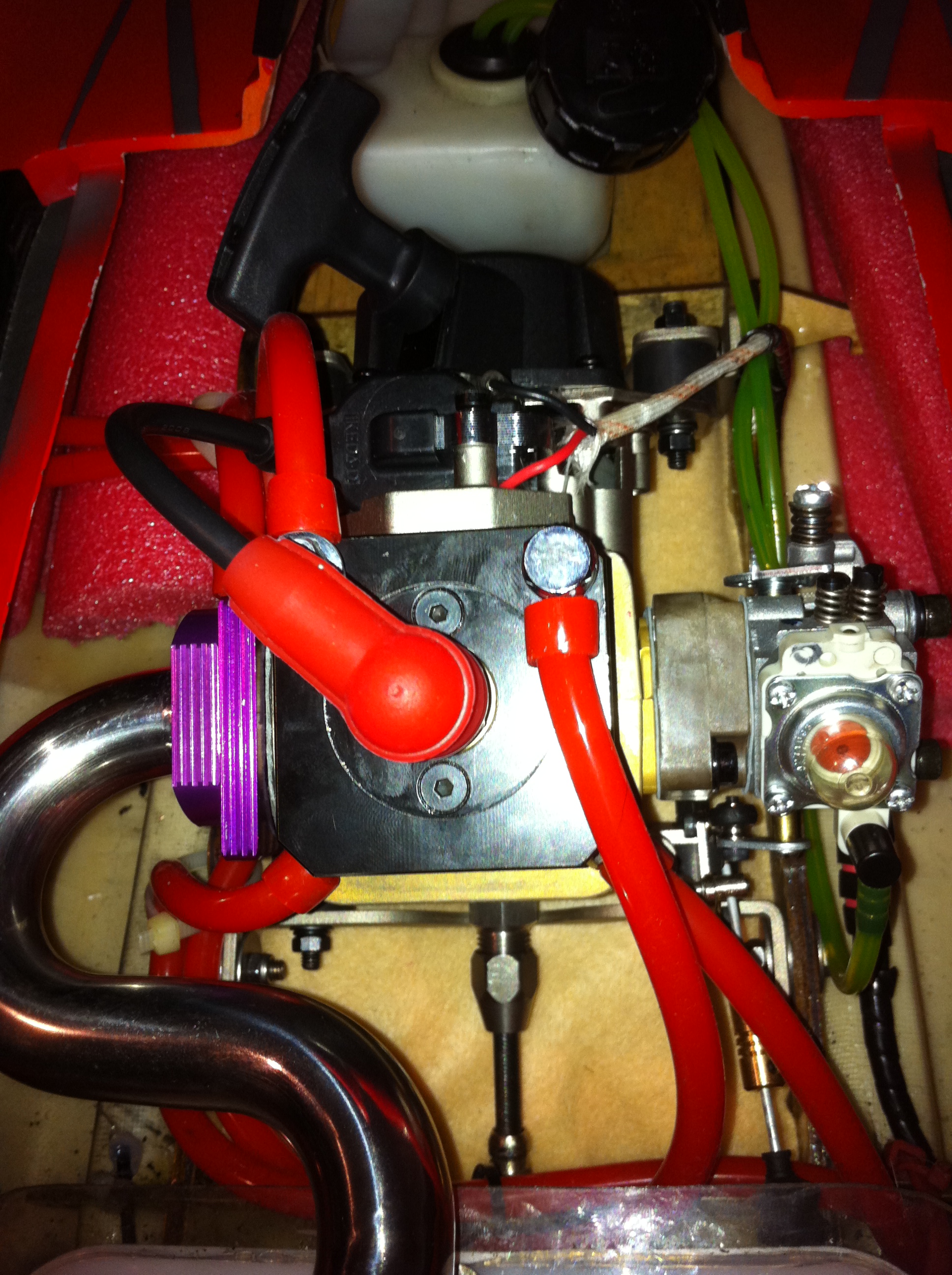

im not sure how you will be starting your engines, will you be using the pull starters or setting up an electric starter??
i have the same engine in a tunnel cat and to save yourself stress down the track put some decent starter cord in them.
the stuff thats in them will break very quickly as i found out.
these motors have very high compression and are a bugger to start. id wished id bought a zenoah instead.
#14159
I installed mine in an Enforcer mono hull, so I could get some run time on them first... If you plug the carb with your finger and pull real slow until it is REALLY wet, then give 1/4 throttle and yank hard one time. Mine starts on the first pull just about every time after I figured this out!!! B) And does it without yanking the boat up off the stand!! Hope this helps!! :woohoo: There's an article on here I read, is where I learned that trick..and it works like a charm!!!

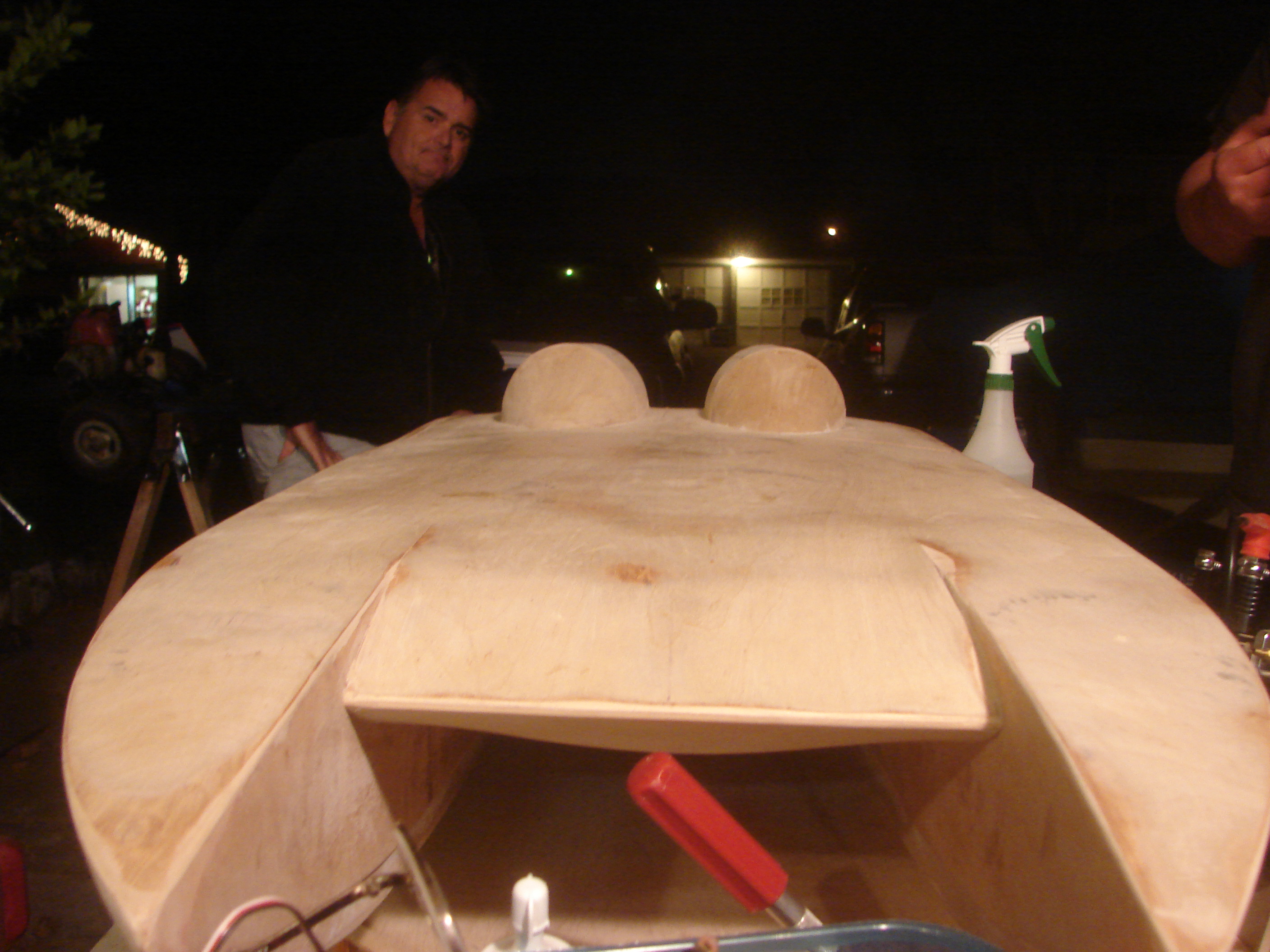

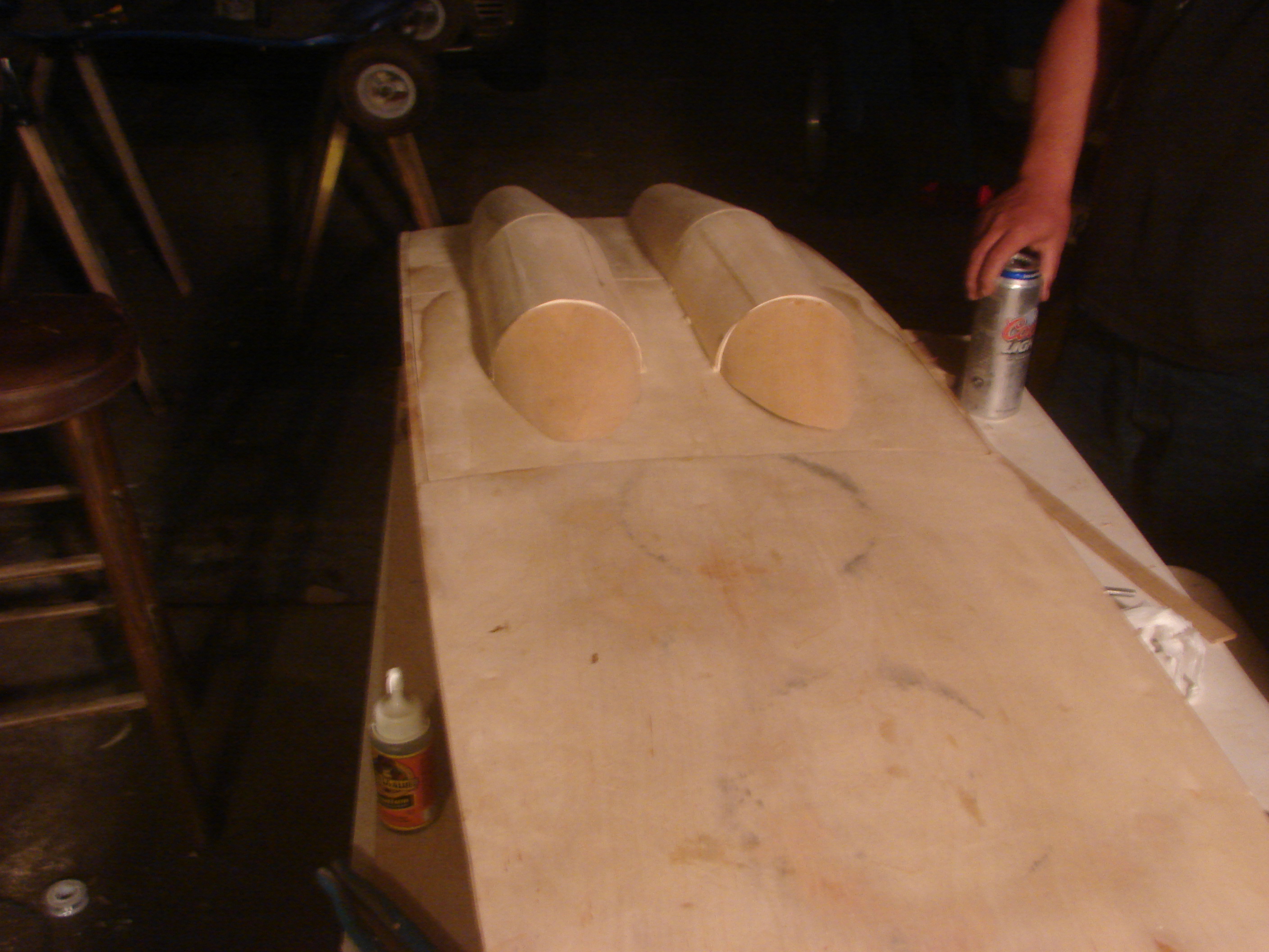

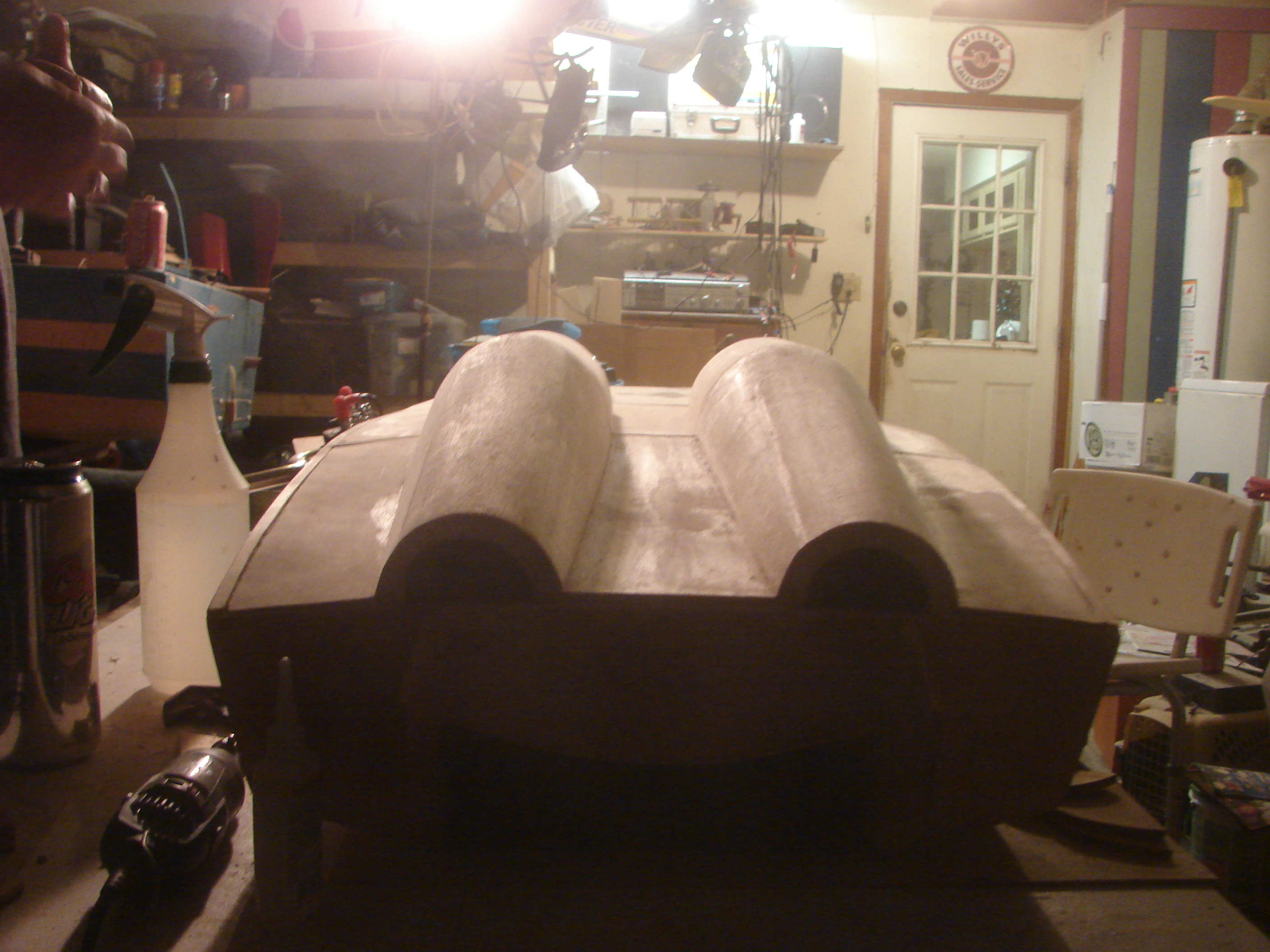

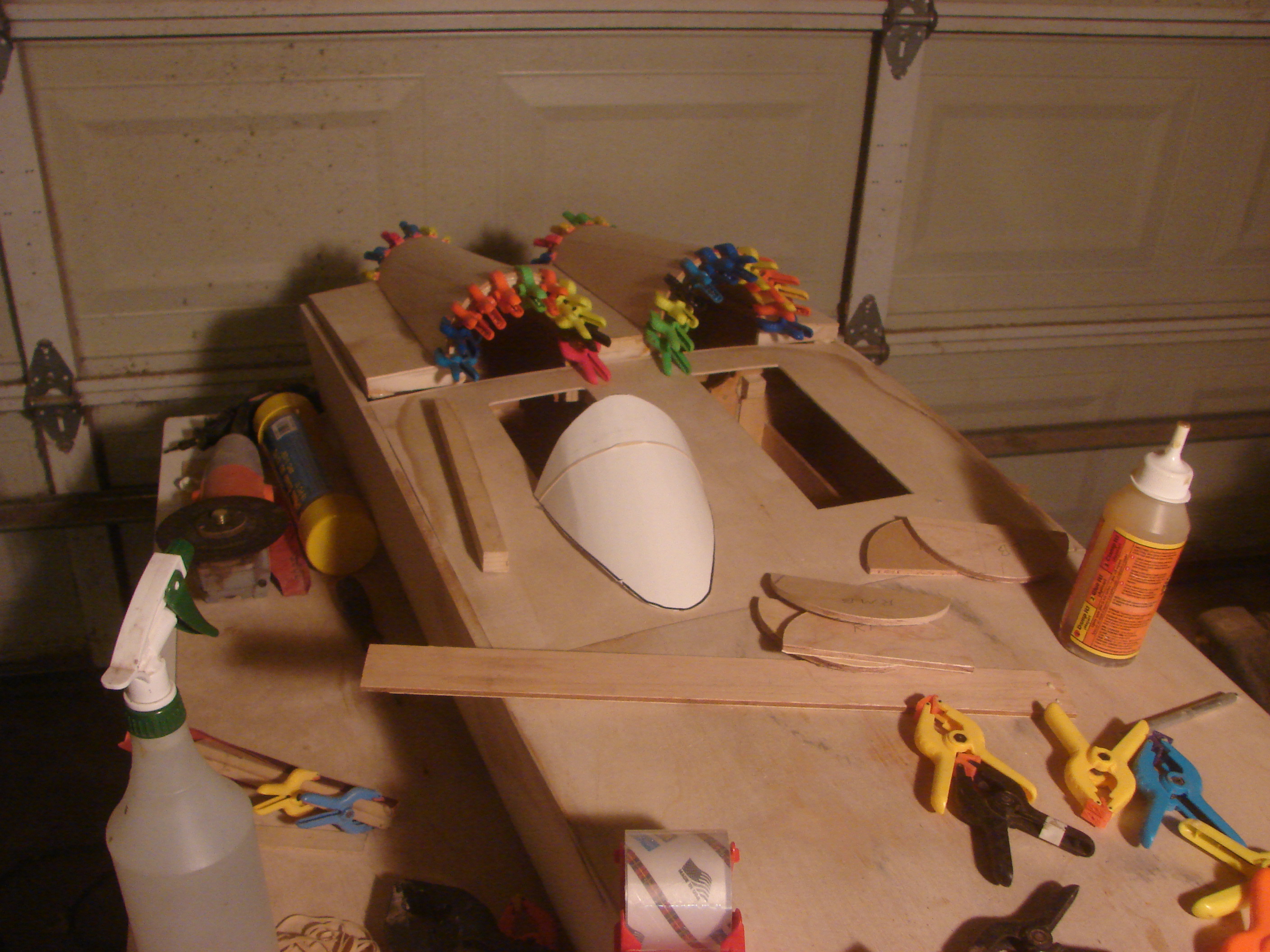

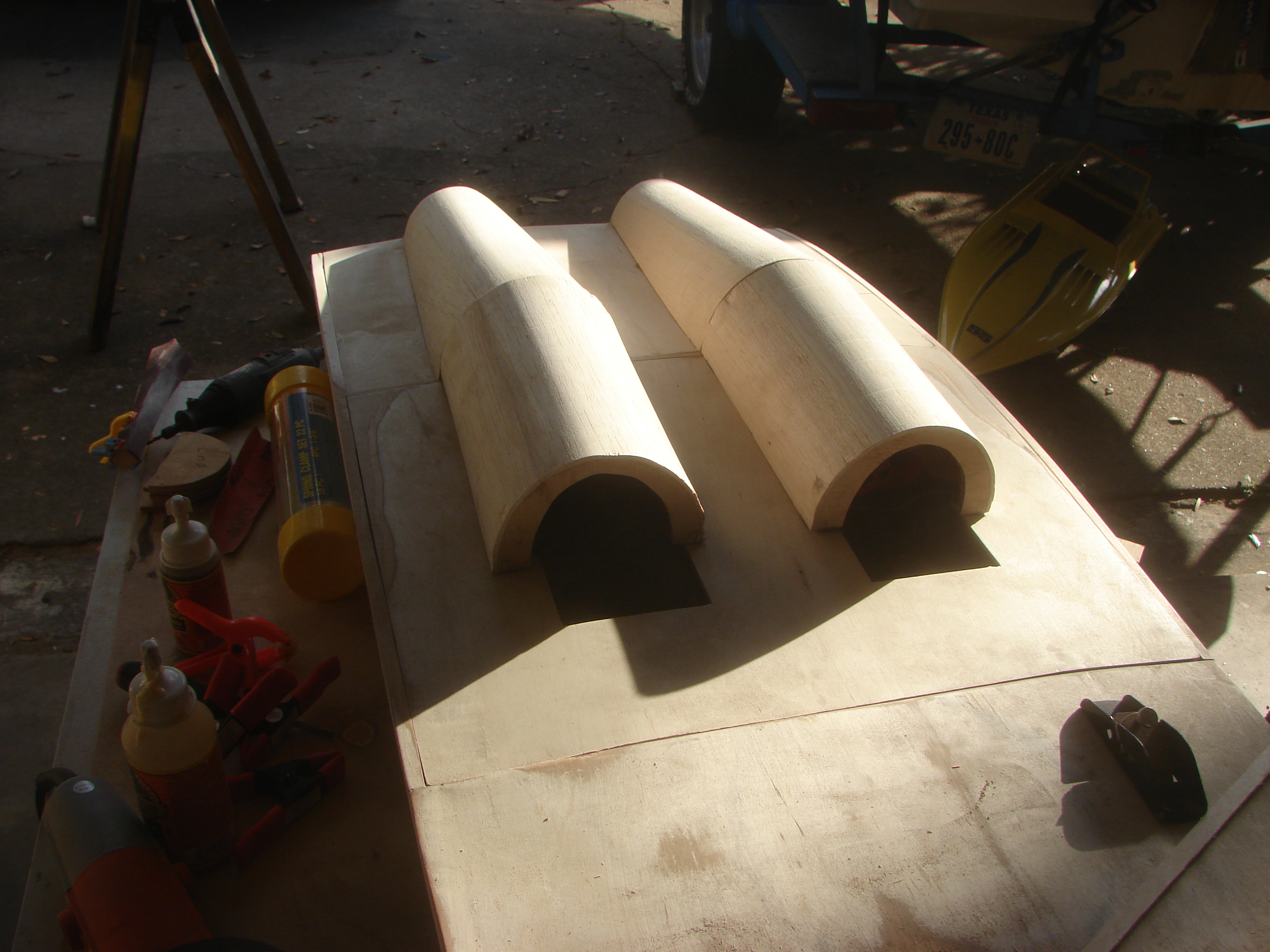

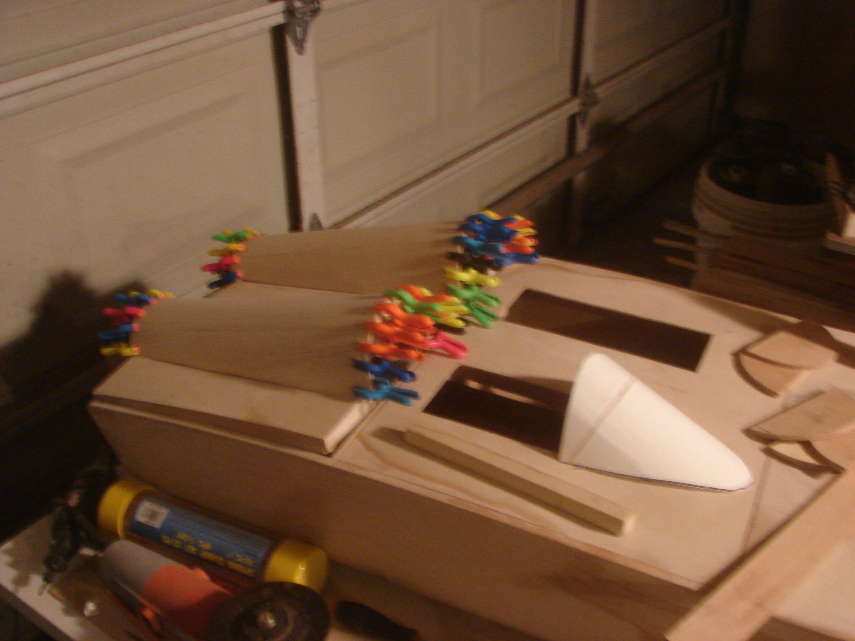

Got a few more pics for y'all...
#14193
Ozpulse replied the topic: Re: Killer Kat (Build Pics Updated)
Whoah man! Thats a lot of work there just in those covers!
Looking real good Isuzudude! B)
#14194
Thanks Ozman... It took me as long to do the 2 hatches as it did to build the whole boat!!! :angry: But it was well worth it to my opinion!!! B)
