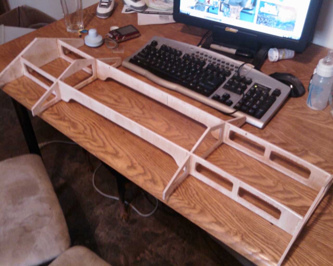

I have made a super great start on my boat build. This is a first for me and so far i am very happy. Especially since i am wood working stupid, i am more of a metal fabricator. the last two week ends i have been able to get a lot done. The main supports are made out of some scrap quarter inch ply wood from a local cabinet shop. The skin on the hull is from a old door that i had setting around.
Engine will be a Echo GT-200R 21.2cc that i plan on modding some.
#14528

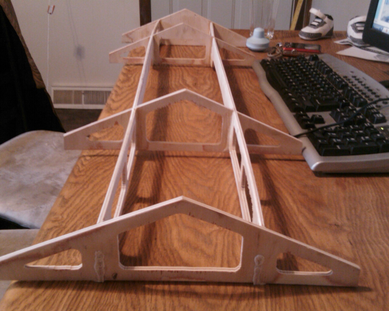

another pic
#14529

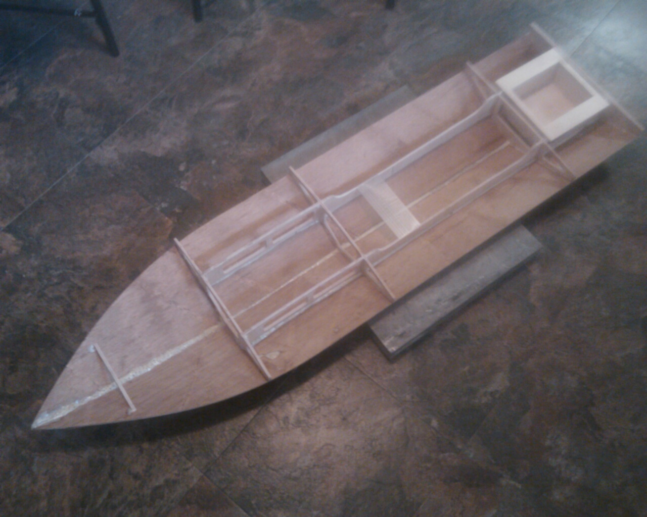

As far as i am going to go with the hull for now until i get some motor mounts made and mounted up.
#14530

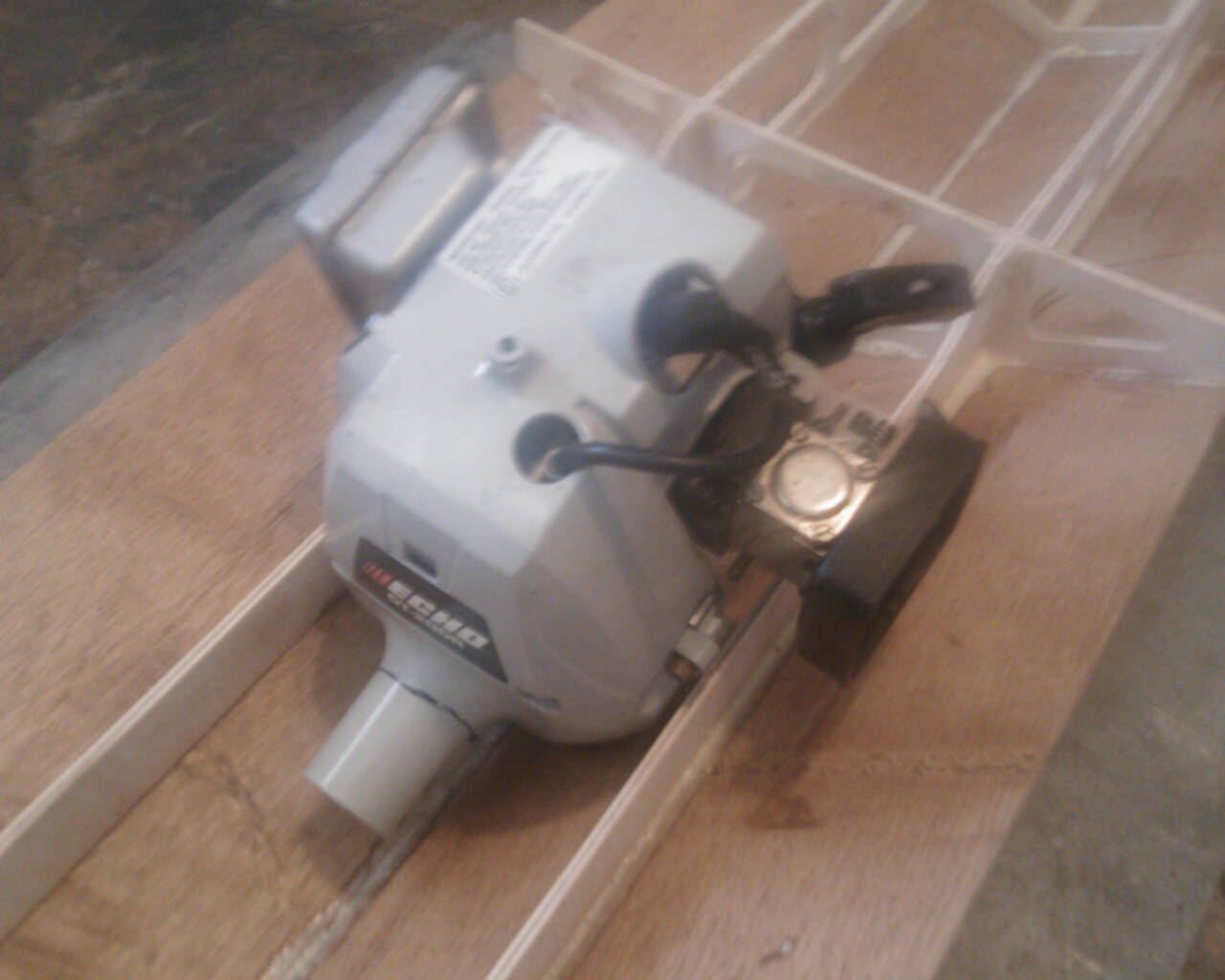

Little echo engine. So far i have modified the base gasket and put a bit larger carburetor that can actually be adjusted on it. the stock card didn't have any way to adjust it. As the build goes i will get a header and tuned pipe and machine up a header flange. Plus i am going to check the timing numbers and see what kinds of changes can be made there along with some porting.
Some of the hardware i have in mind is the XP-2 drive and rudder from warehouse hobbies, a header, tuned pipe and pipe stop from zippkits. I am going to start off with a prather 275 prop to see how it works out.
Thanks for checking it out, if you have any ideas or suggestions shoot the my way.
