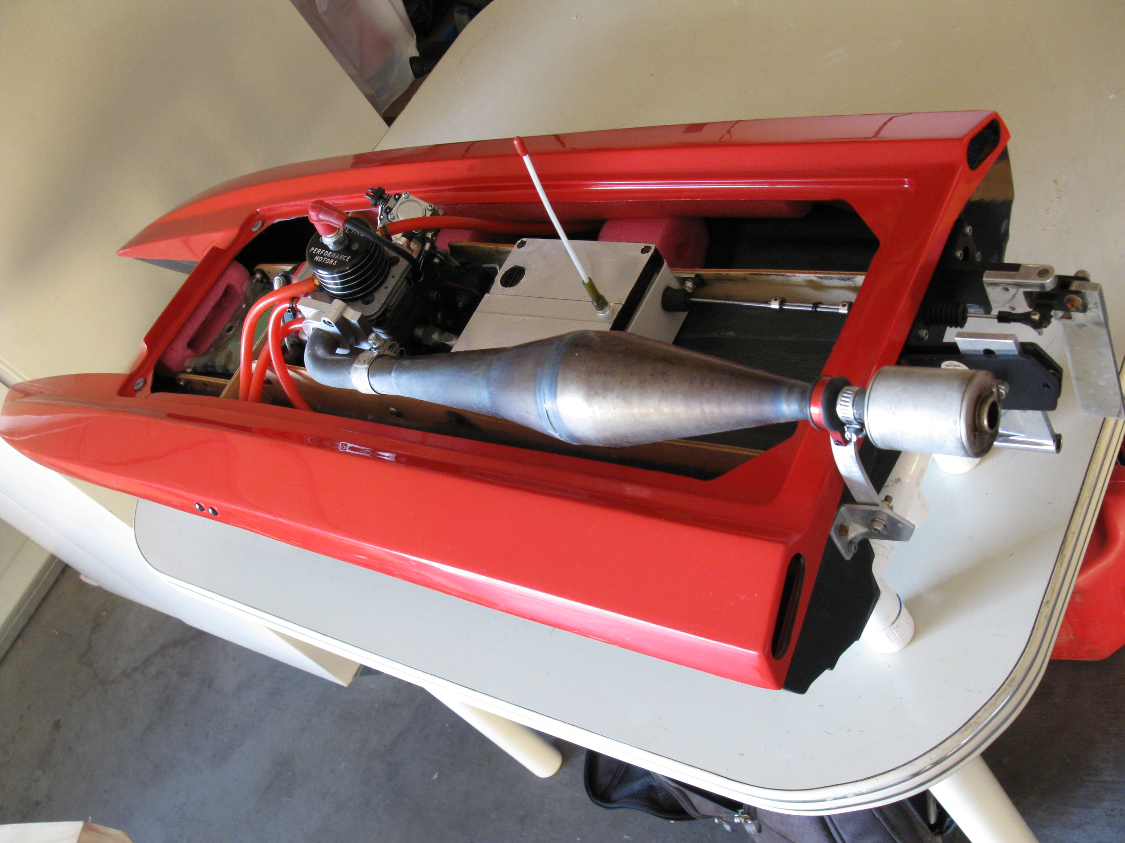

ken0276 replied the topic: Re:Wet or Dry?
ottie44 wrote:Here's my steel pipe system setup on my 41" cat, as you can see, no leak flange, 90* header, 1" band pipe and T-mod muffler, 450 degree hi-temp O rings. What prop are you running? I'm using a Bob Austin mod 667 and Chris mod 2716 15* cat props, they run super fasssss.

ottie44 replied the topic: Re:Wet or Dry?
Thats my next step! One pickup for cooling. To the head first, then header, than pipe to see if I can raise the BTU's. The engine temp should be around 180 but any idea on the header or pipe temp? With dual pickup the header has never been hot enuff that you can't touch it! Running an X667 two blade Texas cut!
