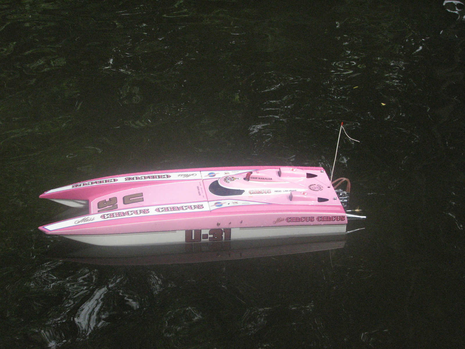

Well the mod engine is finally broken in, time to tweak for speed! Full take of fuel carb leaned by 1/16 of a turn, pipe set at 12 1/4 inch. after 12 laps 58 mph top end. Came in for a check and all seamed good even the Cooper Muffler stayed on.Back in the water,after 4 laps the boat came alive top speed 64 mph but sounded like the Cooper was coming loose. Brought it back in only to find out the water nipple on top of the rudder had broken off. the motor was still getting cooling but not the pipe! NP drilled out and replaced the fitting and all four O-rings. Another 6 laps and top speed of only 58mph???? What am I doing wrong?? :dash:
