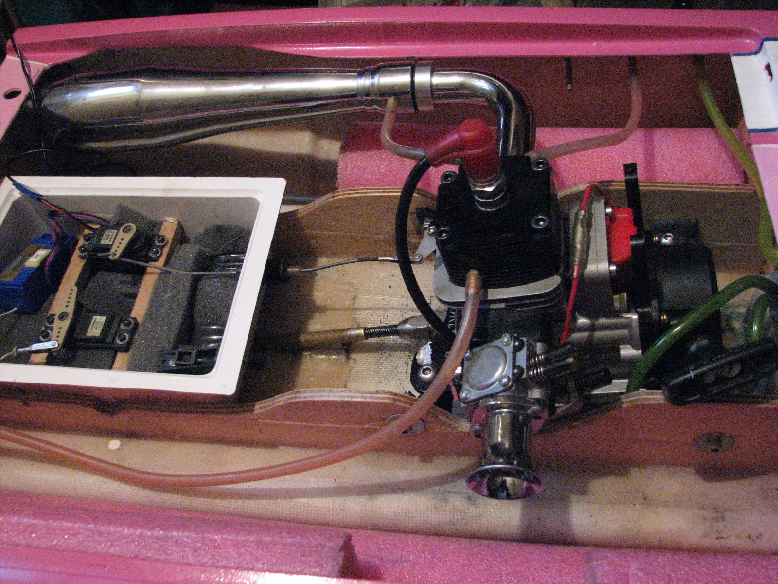

I was looking for you input, thx. Replaced all the o-rings with new ones after the pipe got hot and no noticable water coming out of the Cooper. The pipe was no hotter than a nitro pipe and the head was the same as always heat wise. It's a dual pick up system so the hesd gets cooled by itself! It was just the pipe that was not being cooled. Could it have something to do with the exhaust being burnt more efficently? 6 mile an hr is a big gain!!!!!

Thx Scott. I hav tried the pipe in all the way to the elbow, Im running a four inch offset and it still does not want to get up on pipe the way it did b4 I put the Cooper muffler on? When I lost cooling I had the muffler on with great power and speed? I have tried both the T mod and Cooper but I would really like to go quieter without lose of power? I have even sent the pipe and header out and had it chromed to raise my BTU's! Does anyone make a pipe for gas like the old Irwin pipe? With an OPS .90 it was so quiet in my CAT u ciuld hear the waves hit the hull with no power lose!

Sorri bad pic !

I see with the wide band of pipe & header offset, the overall tuned length IMO is too long.

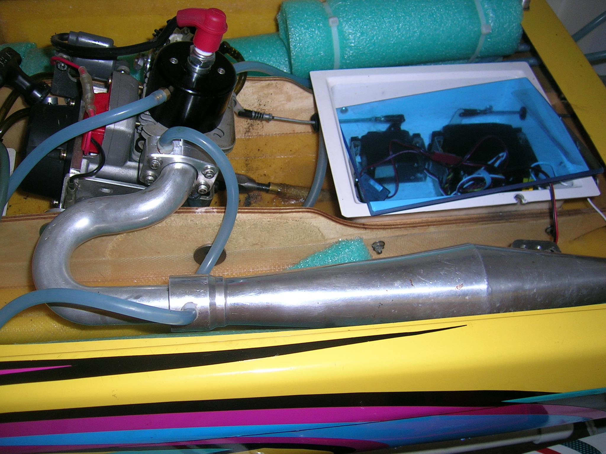

Hey Ottie I had the same thing happen to me last week. One of the water hoses came off. I noticed my boat got louder then all of a sudden it got really fast. I had a gps turned on but the battery died so I don't know how fast it actually went. I to burned up my o rings on the pipes. I had also asked on another forum why the increased speed when the water hose came off. I was told that water cooled pipes slow some of the heat pulses(not sure if that's correct) and the water does some type of muffling. Not sure if thats correct I'm still learning the gas stuff. I'm still adjusting pipe length on my avenger so I haven't hit top speed for my boat yet. I'm glad I'm not the only one that this has happened to.

Yikes !! ... Yes your pipes OAL is WAY TOO LONG !!
** Both of you can get a better idea how much too long your set up's are :ohmy:
If you measure down the MIDDLE of the head pipe starting at the flange that bolts onto the cylinder ... measured to the START of the rear cone, you should be in the @ 12 1/2 to 14" range.
