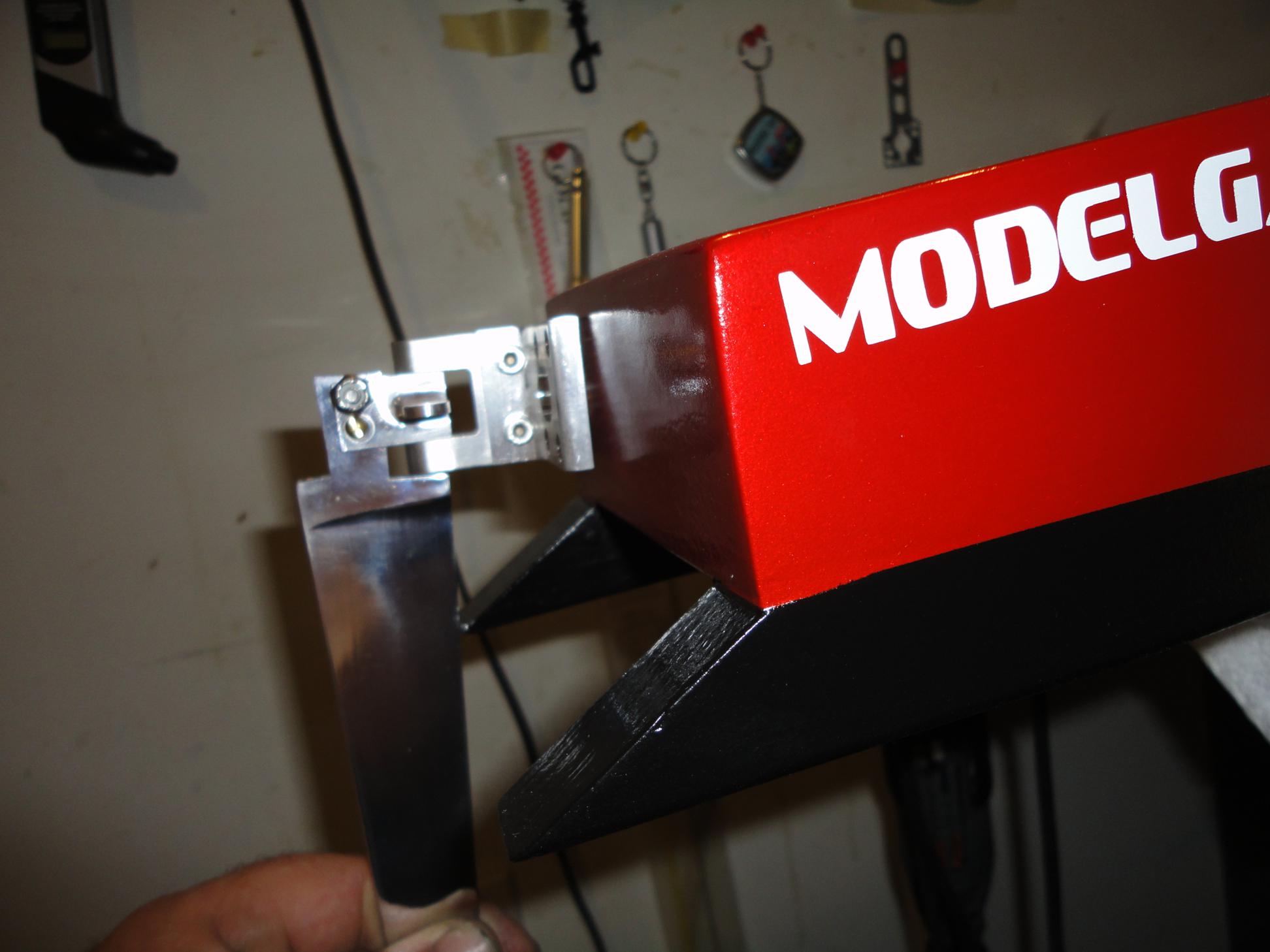

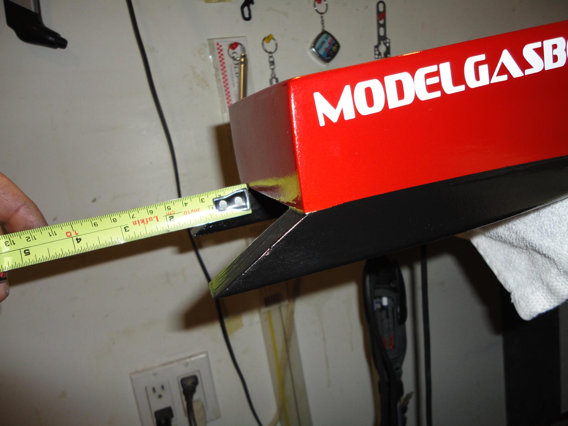

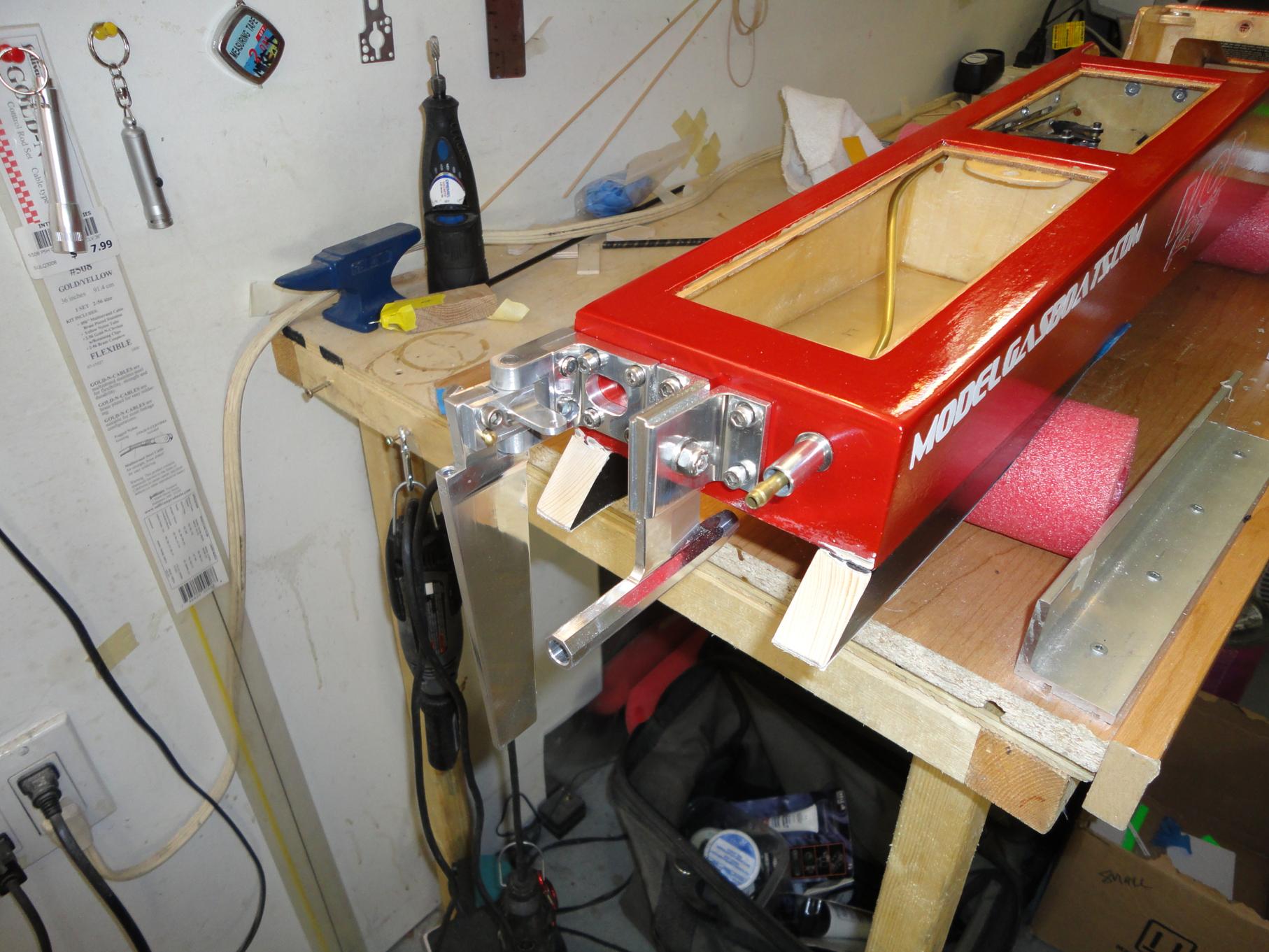

Ran into a glitch for me today ....... Instructions say : For the rudder we recommend the SPDR- 013-1SB, 60/90 Rudder Assembly. which is 1 1/8" ,,, so I have 1
I screwed up some where ...problem is (for me anyways - not sure what I did wrong I squared them to back) is my rear shoes stick out 1 1/2" so my rudder will need to be a 2"
Back to the drawing board ........ oh well I have a nice polished / sharpen rudder anyways Lol

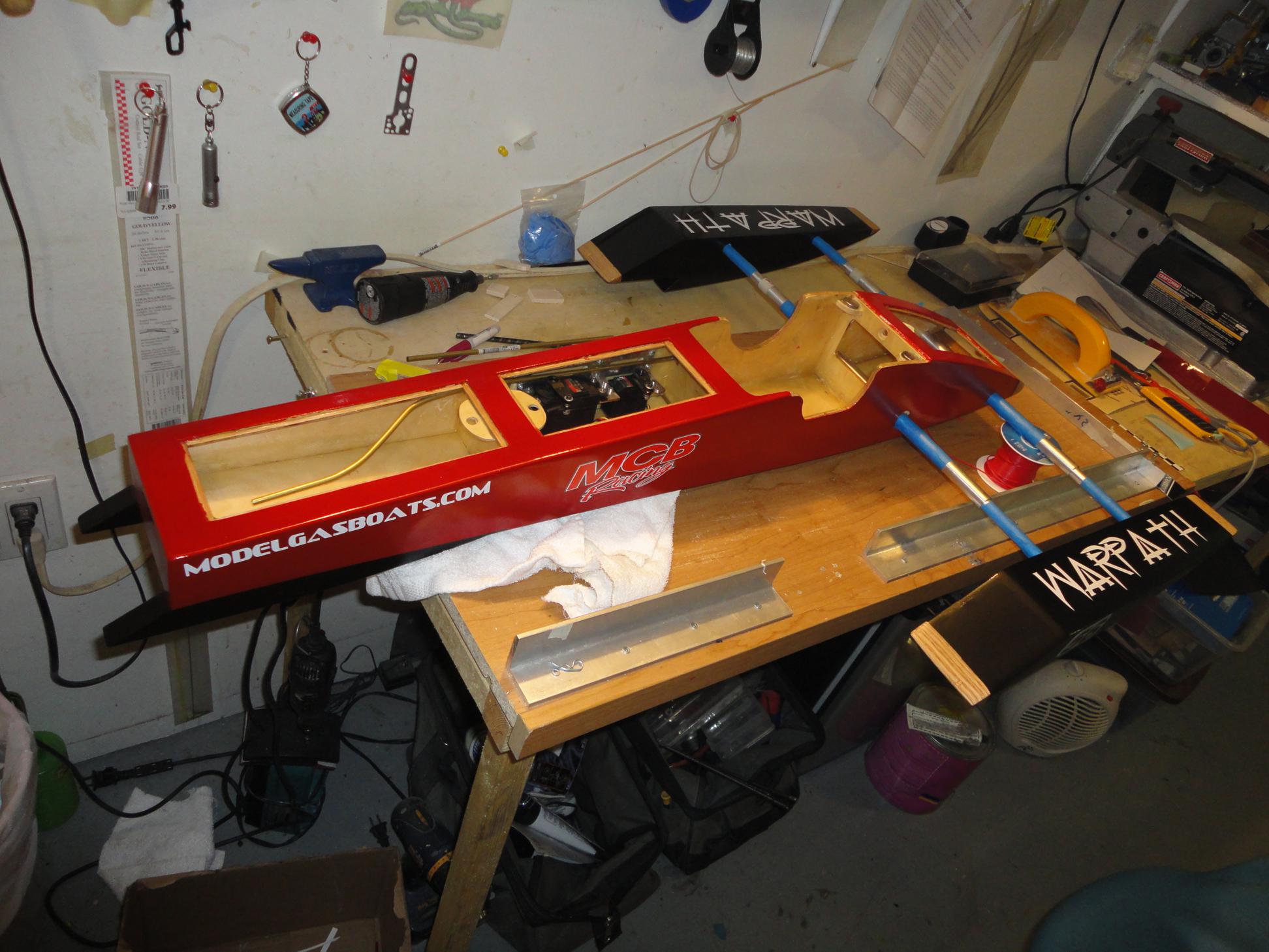

Cleared and stuck some decals on............ :lol:

Question for the Rigger guys .......
since my shoes are 1 1/2" out do I use a 1 5/8" rudder kit (real close then) or the 2 1/4" I don't see a 2" from Speed Master ??
Thanks

marc replied the topic: My Warpath
Randy, block sand the tips of the shoes at the back to provide clearance for the rudder. Do both side even. I need to update this info in the instructions.

Canadian Hot Rod RC Boats replied the topic: Re: My Warpath
Thanks for the suggestion - already painted and cleared (it's a 3 part paint with hardener in it) so I think I'll just order a 2 1/4" - not sure
I would have to sand 1/2" off and keep it sand and equal ......... and most likely re paint back (the 3 part red)

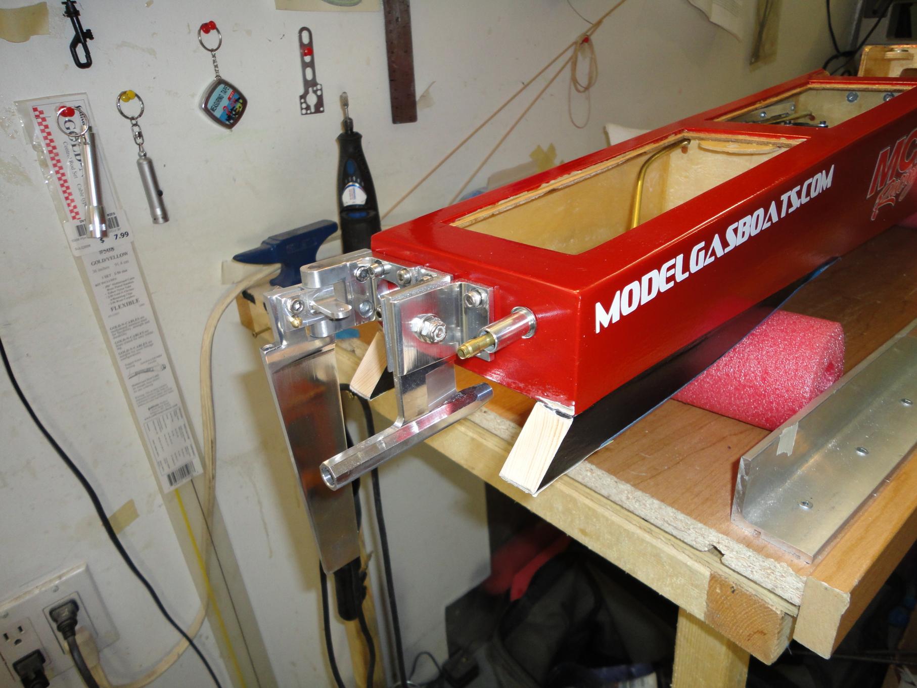

This takes a while ........ but is the best route I'm sure after thinking (and after wife's '' didn't u just buy one for that skidoo thing [means rigger] and how much more is this? ''
Nothing dear ..... I'll just go sand ...........
little touch up to do but okay .. need to finishing polishing anyways

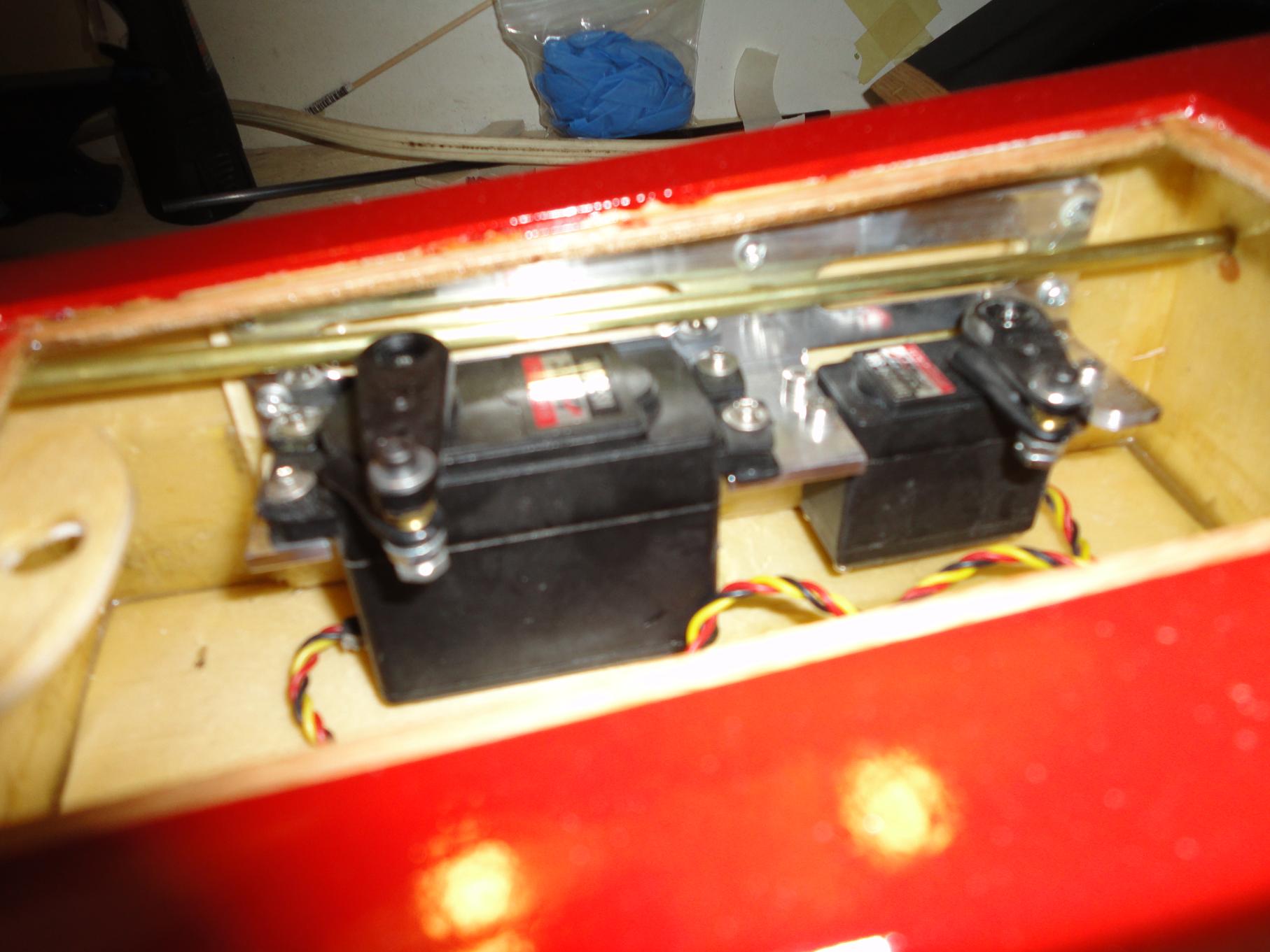

Now if my mounts would co-operate ............... :unsure:
Servo's mounted good (used 1/4 backing plate with 4/40 inserts and TSB polished mount - I mounted thottle under bracket so it's lower to engine --- would like all straight rods when possible ...........
