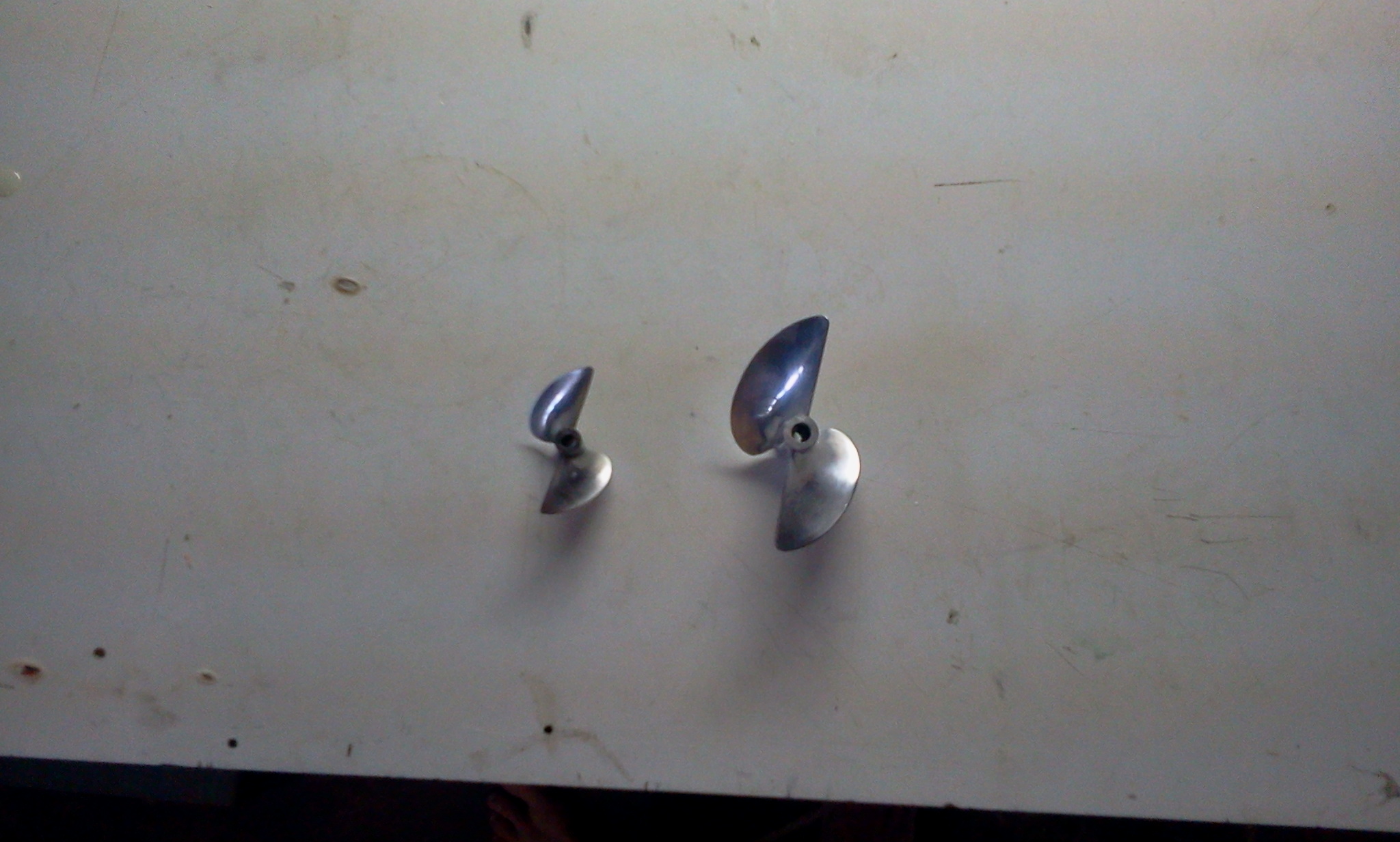

I really wished i had the bigger prop at the time, would have given it a lot more get up n go! :-)
on the left is the prop i was using, a Prather 235, and the right is the new prop i received yesterday. little bit of a size difference heheh :-P

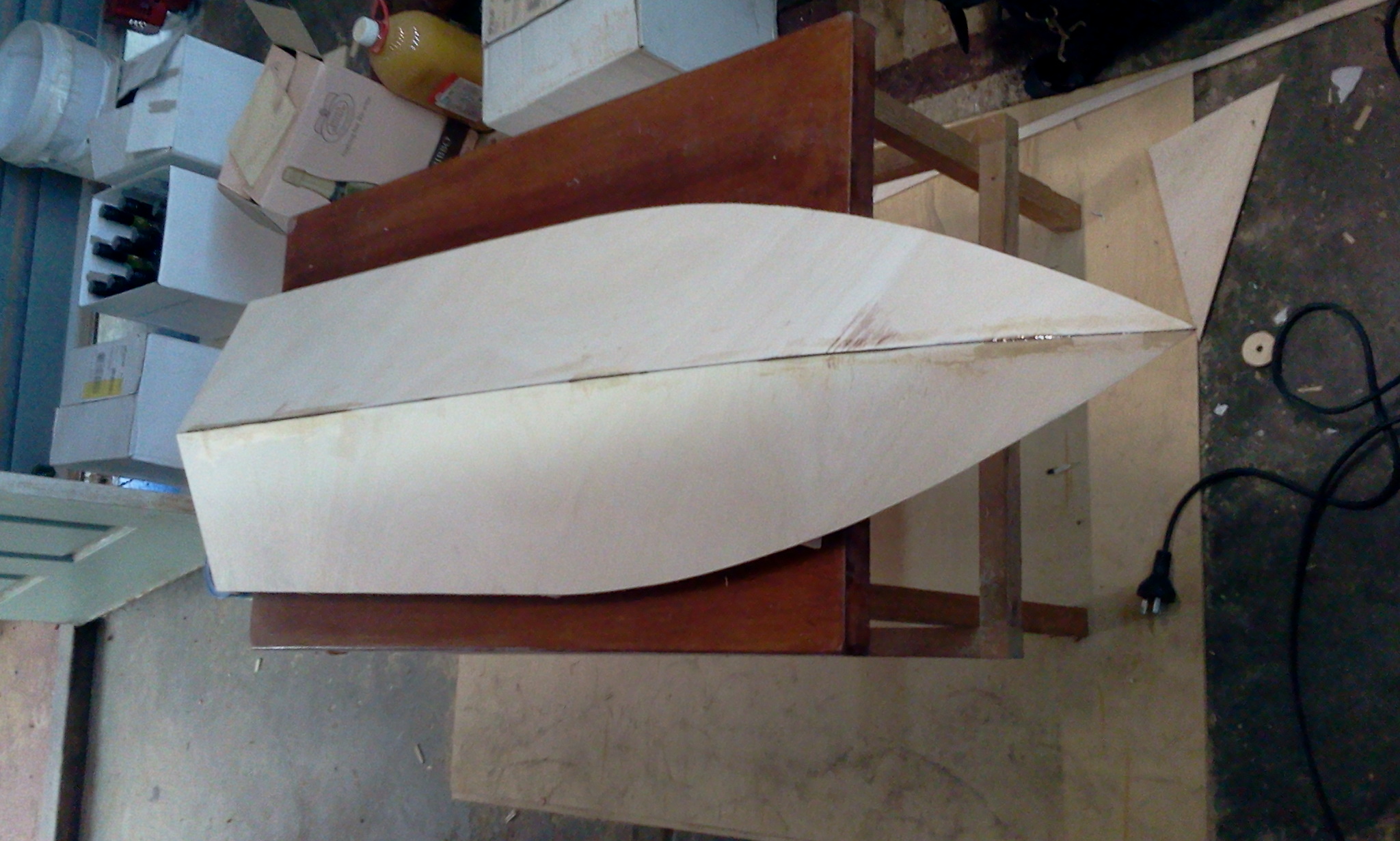

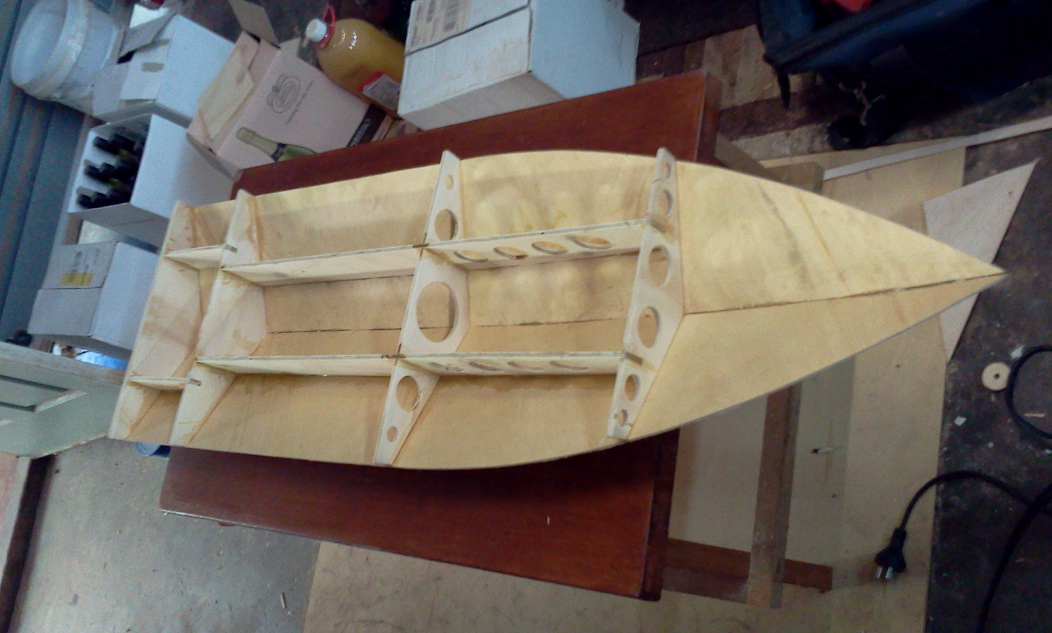

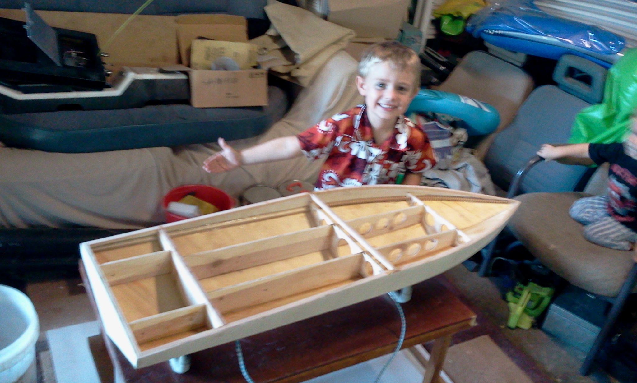

heres some pics of the new vee and where im at with it now.
#15404
dwr9 replied the topic: Re: my el cheepo weedy mono
The boat is really meant for a surface drive with the shaft coming out thru the transom, not thru the bottom of the boat as your current one does. Doug

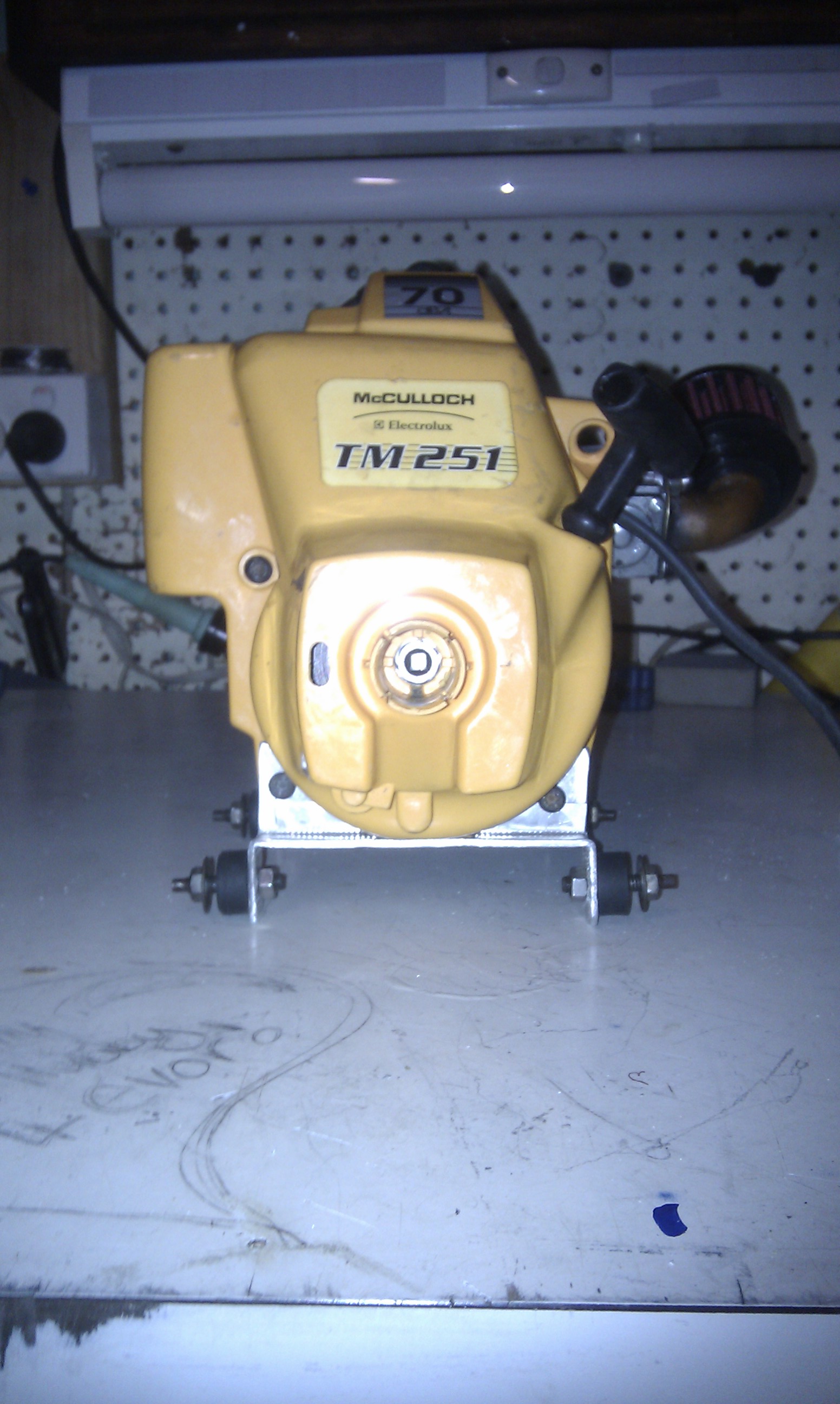

I picked up another McCulloch weedy motor from the rubbish tip shop for $5.
This one is only 25cc tho unlike the big Bertha 32.
I am going to run the 25 at first as this one starts and runs like a dream. The 32 is being a pain in the ass and takes forever to get it started and running reliably.

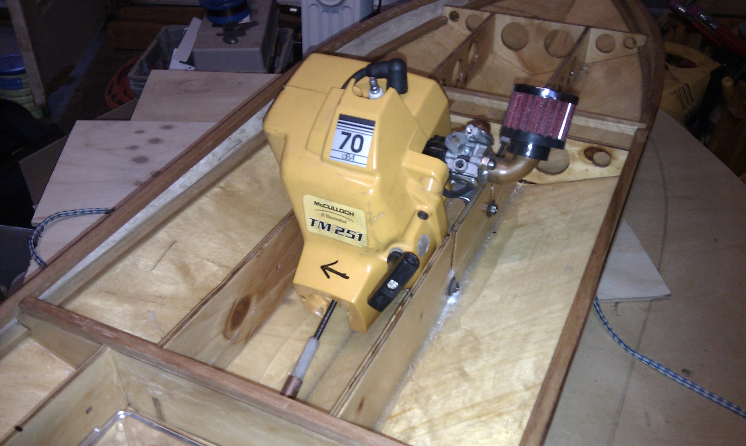

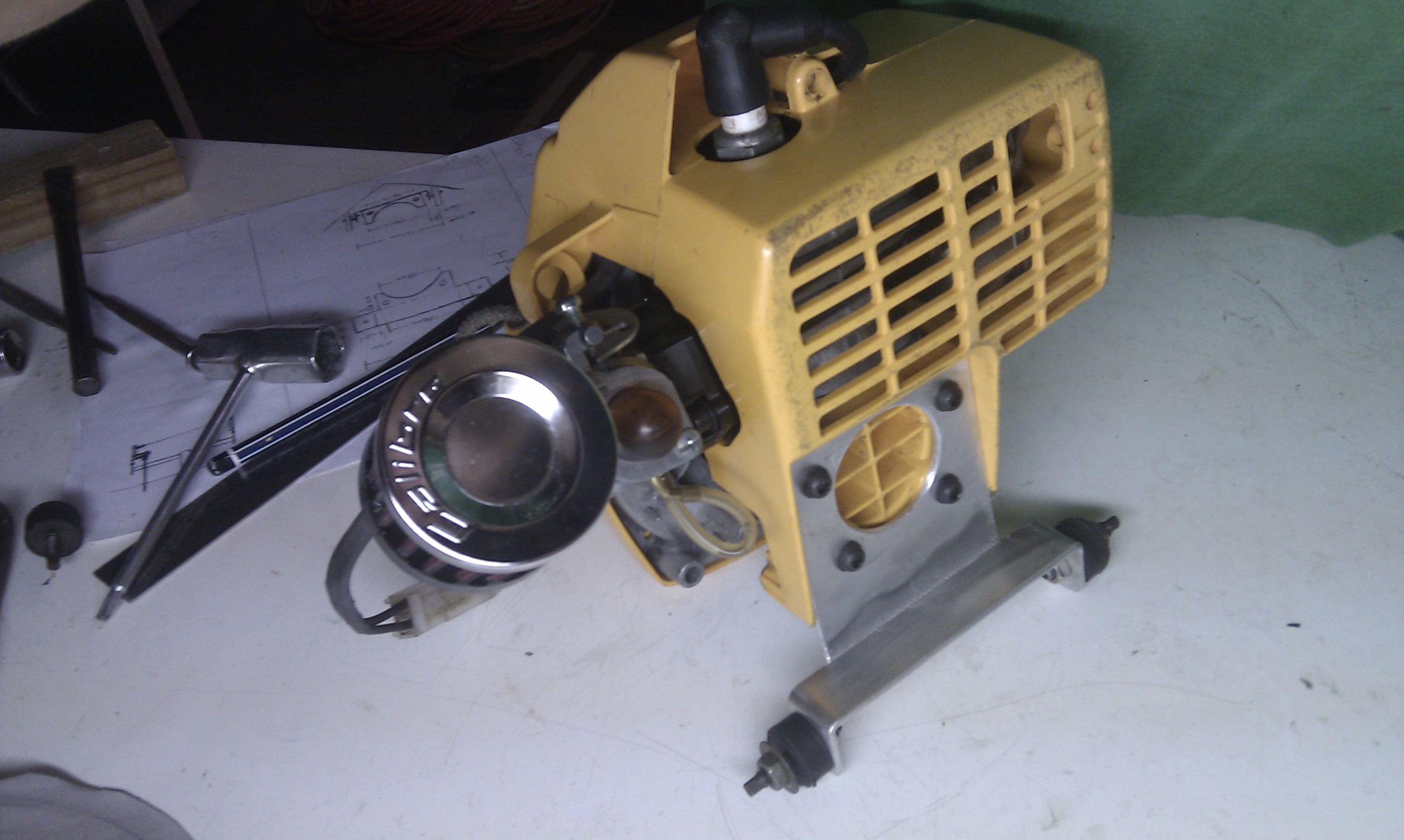

I finished fabricating engine mounts WITH the rubber isolating bushes I picked up from the wrecker for $5. They worked out quite nicely and will fit the 5" rails perfectly.

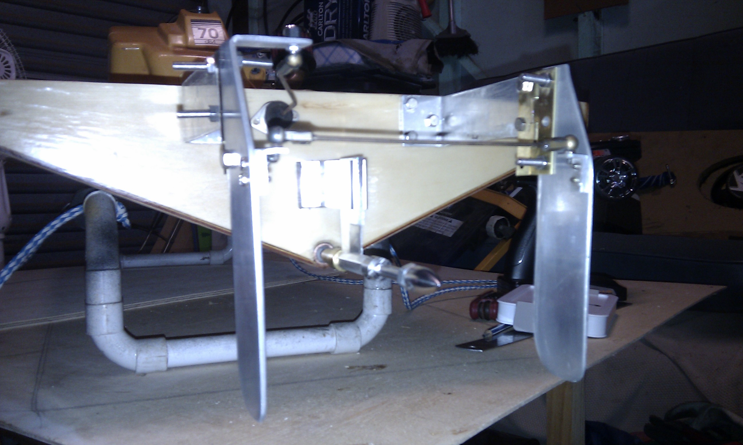

I have decided to use a dual rudder setup... just cos I can haha.
I made a dual rudder arrangement years ago for a different boat but never got used.
all I need now is a driveshaft ferrule, shaft and drive dog to complete the driveline. I kept the flex shafts from the 2 weedys I butchered so no shortage of flex cable :-D

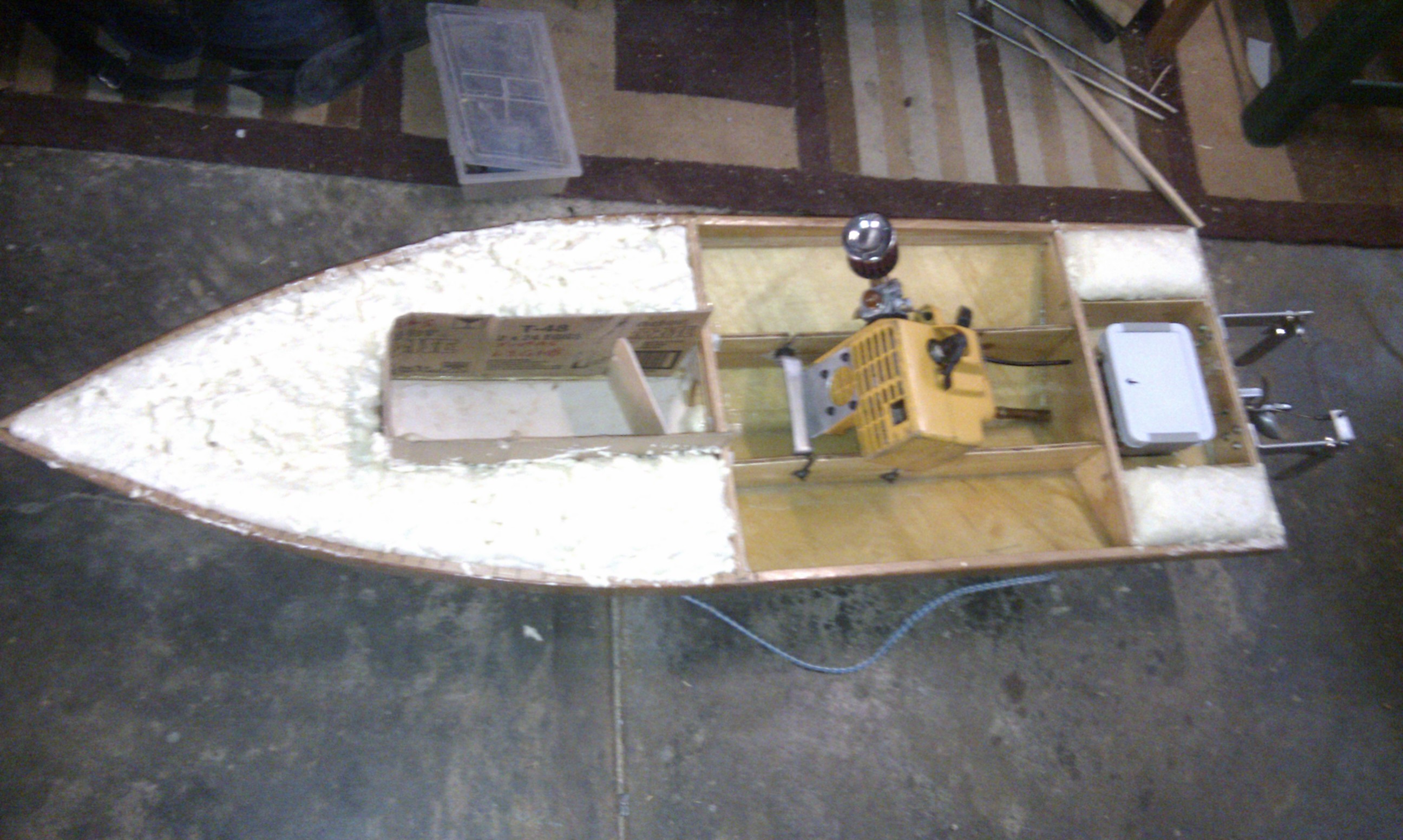

Alrighty, haven't posted much as have been busy working on it.
Progress to date -
Hull sealed inside and out with 3 coats of resin and cloth strips along keel and engine rails.
Tough as nails I reckon :-)

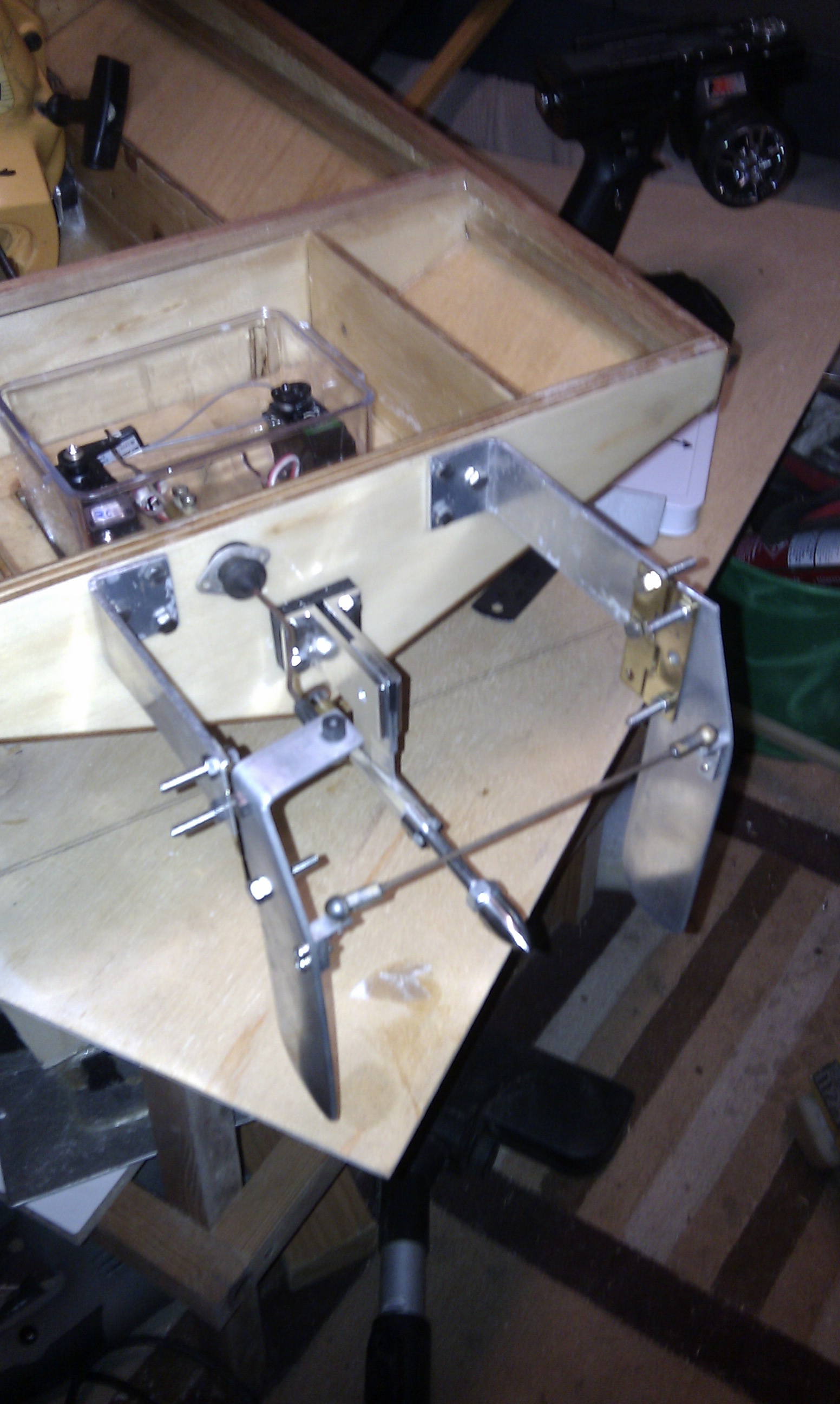

Dual rudders mounted and set up.

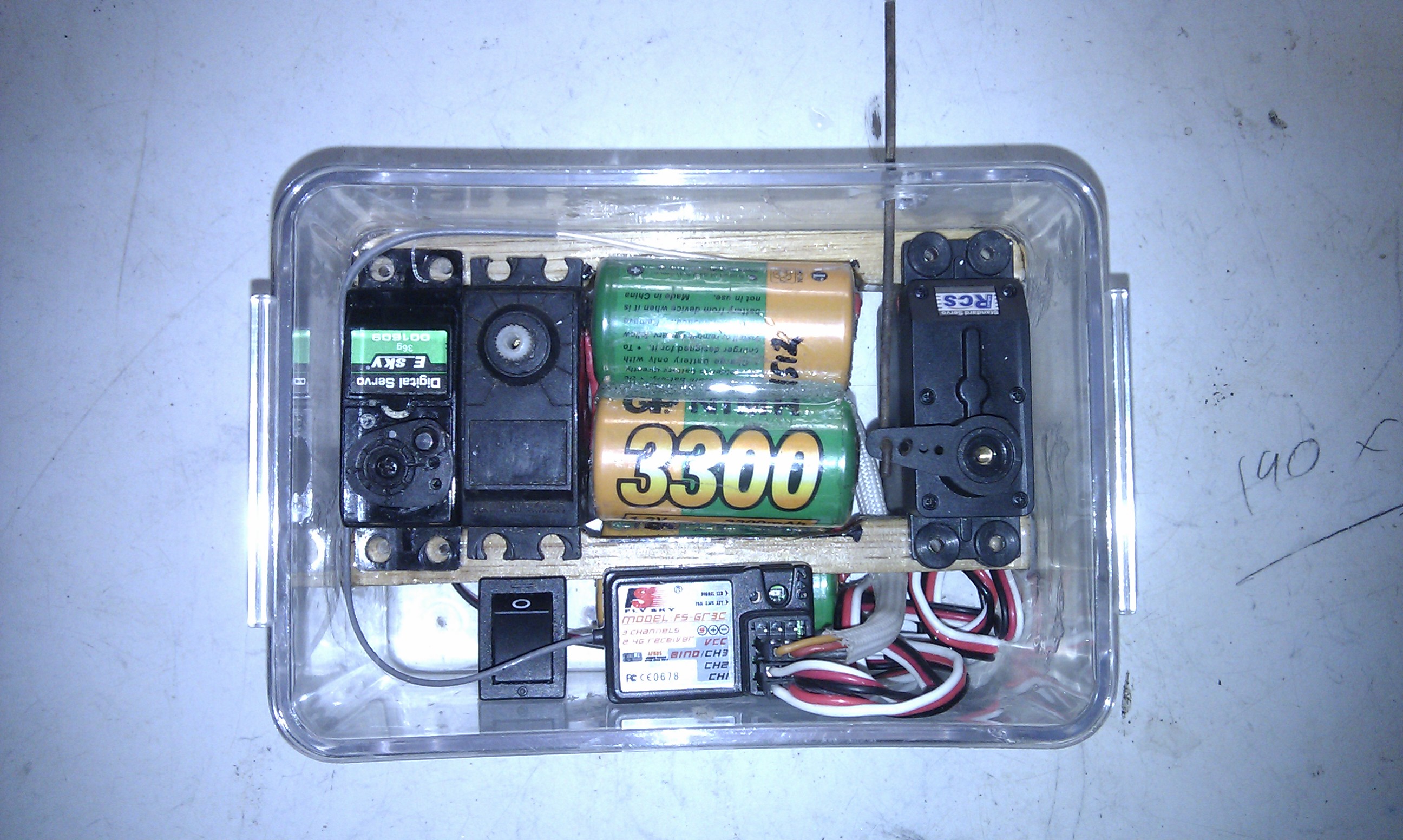

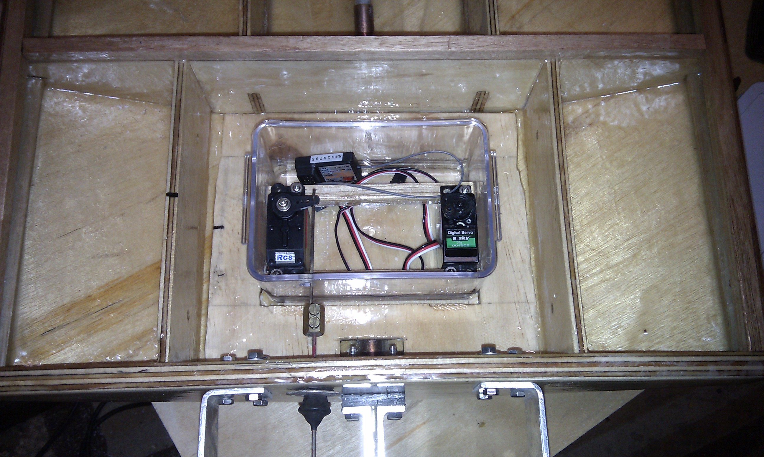

Radio box in with servo mounts epoxied in. I found a nice plastic container with a fully sealed lid and very sturdy construction for the radio box. Is a bit small but everything fits.... just.
Driveline all soldered up to my custom made ferrule I made on my "vertical lathe " (drill press and dremel hehe :-P)
I found the problem with the 32cc Mac, Turned out to be the carb flooding it regardless of needle settings. I had a spare Carb from an old chainsaw which once tuned runs fantastically :-D

Getting close now :-) only have the deck to glue on and figure out a way to secure the radio box and fuel tank.
I filled up the front areas and either side of the radio box with expand-a-foam so hopefully in that unlikely event where I flip it , it should float.

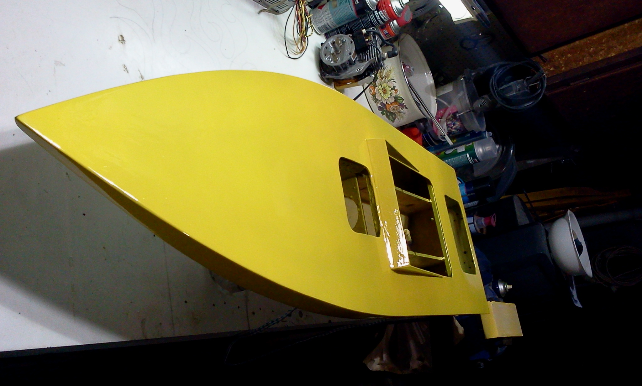

Well progress has been slow but getting there.

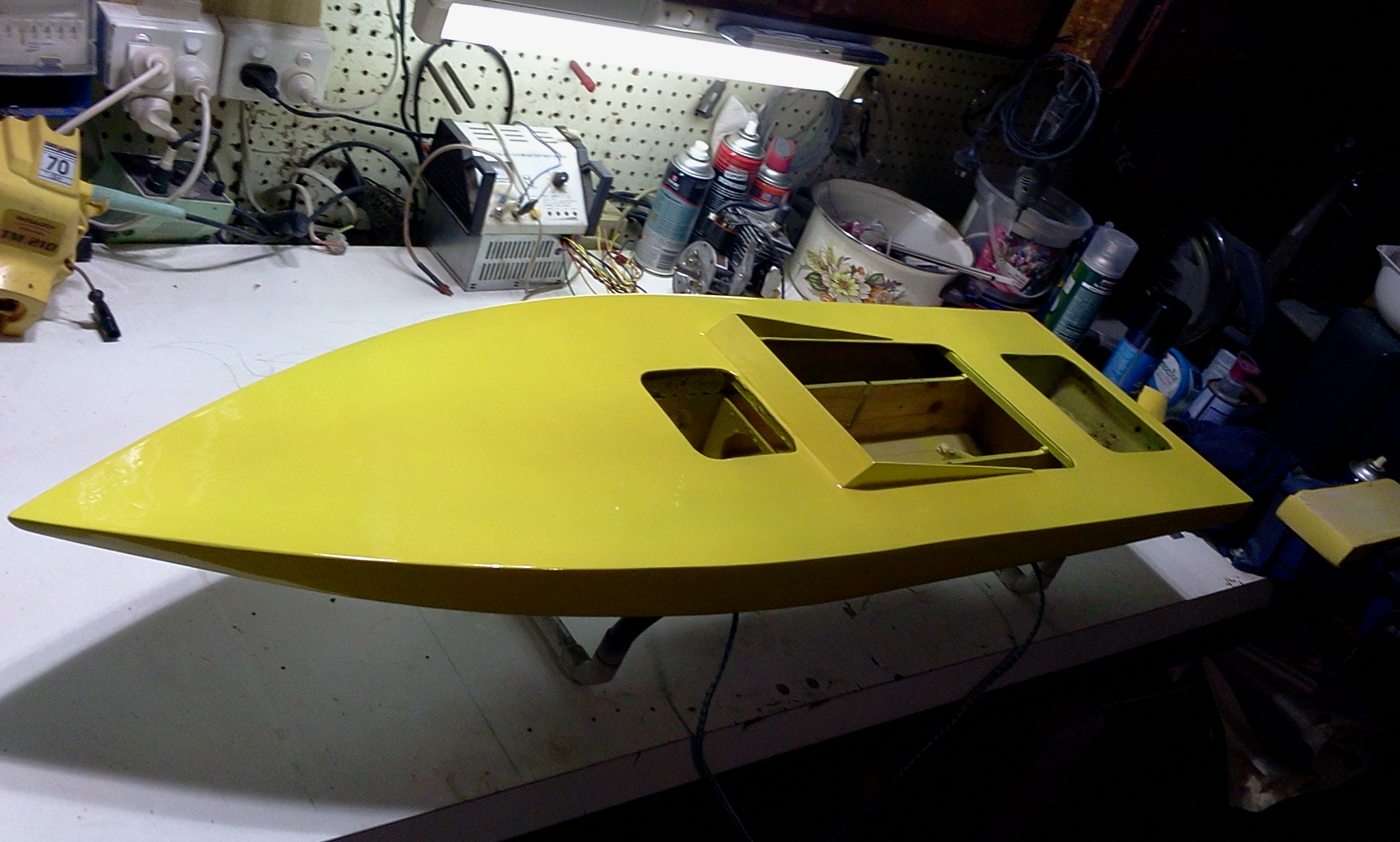

I have the deck epoxied on, coupla coats of resin, primed and top half of hull painted a stunning 'carnival yellow' :-)

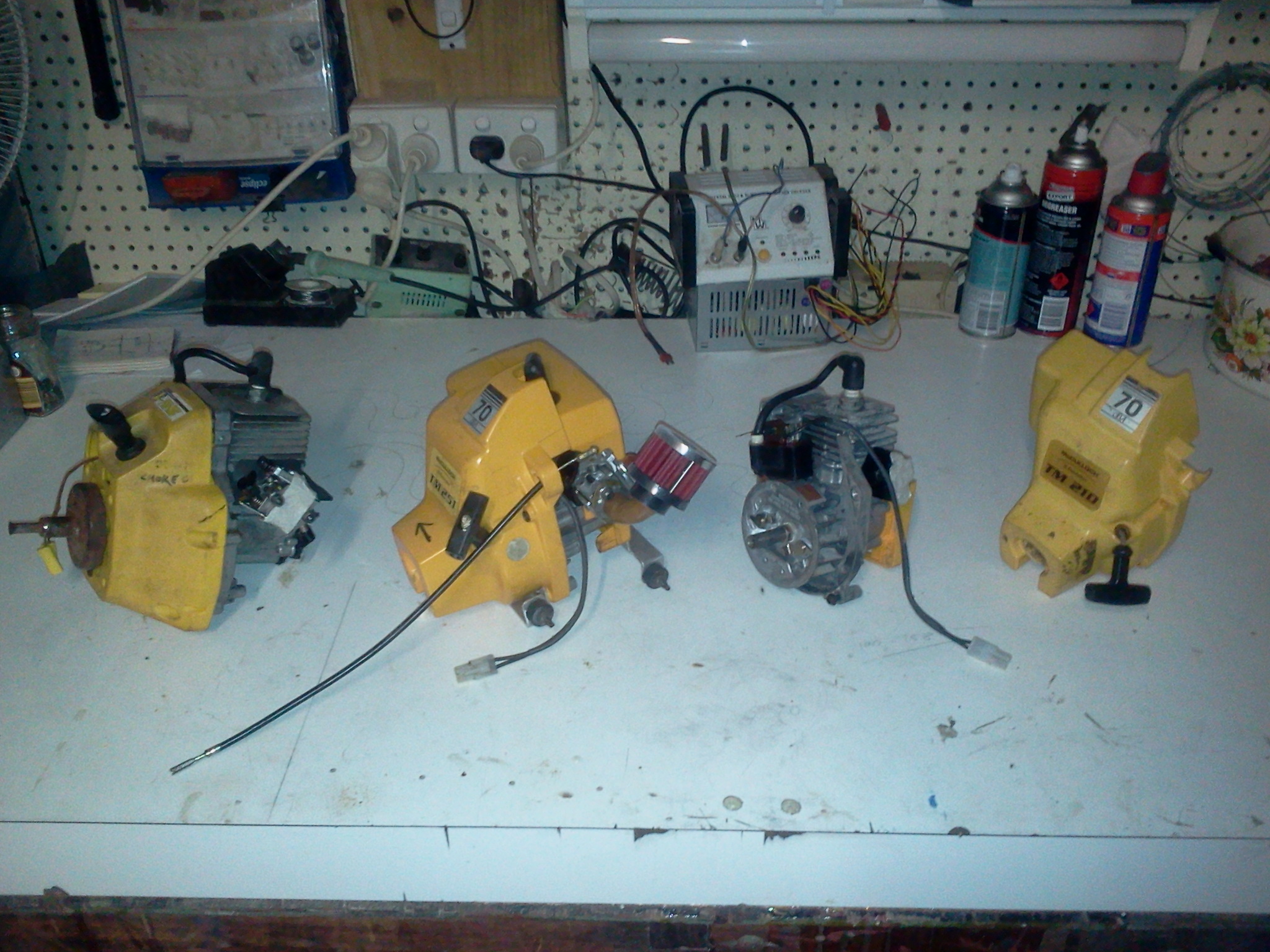

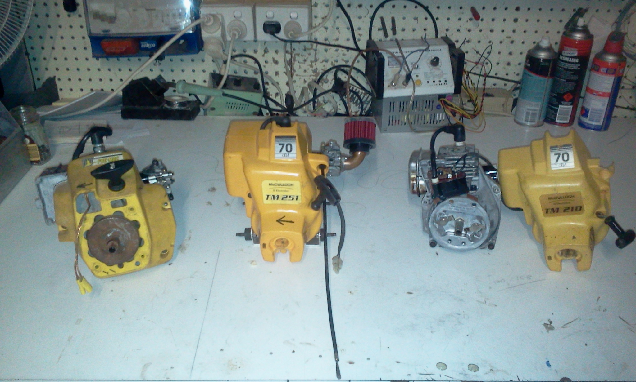

i do have a question tho regarding the stock weedy motors, im thinking of taking off the pull start assembly which consists of the huge plastic shroud on the front and using one of the electric starters i have from nitro airboat days. By taking off the plastic shroud, am i reducing the aircooling ability of it? If i run without the shroud, do i run the risk of the engine overheating?
I want to take off the pull starter and shroud as it will allow me mount the engine lower in the hull.
Heres the 3 macs i have now, from left to right, 32cc, 25cc and the guinea pig 21cc.
