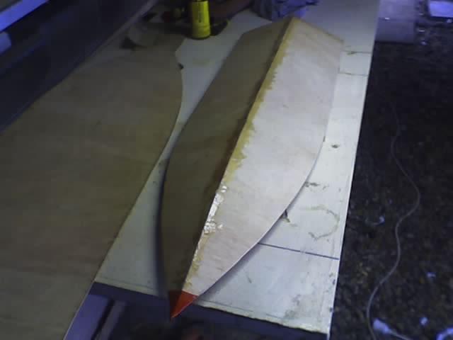

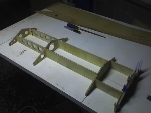

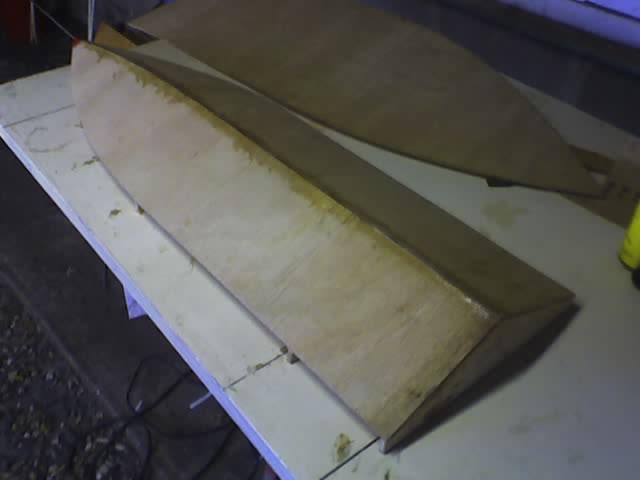

Ok started to do a bit on my first project. Got all the parts cut out and cleaned up for assembly, grabbed the old door workbench and got all the frame glued out. Just have to wait till morning for the glue to fully set and I can start a sanding and get the floor on. Here is a pic. thus far. Nothing exciting.

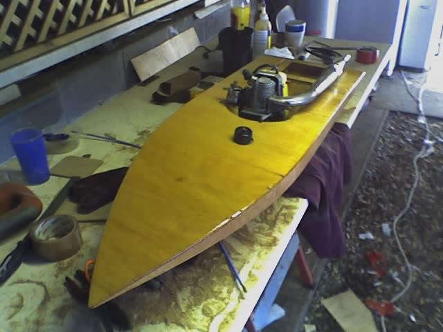

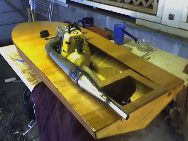

Well got a lot more done over christmas, the hull is finished and glassed. At first I thought that the 21.2cc McCulloch engine was going to be too big and heavy for it but after doing a float test in the bath tub it all seems ok as the hull wont even sit down to the side boards in the water. Here are some more pics so far, This boat is only my first so it isnt a work of art it is functional.:unsure:

Ozpulse replied the topic: Re:48inch 'wildthing'Mono
And another.
