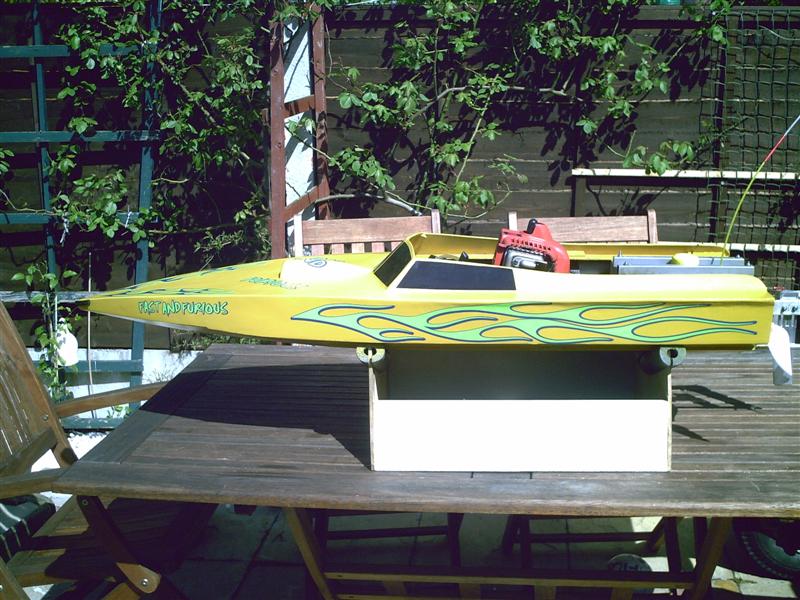

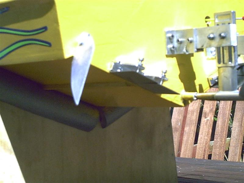

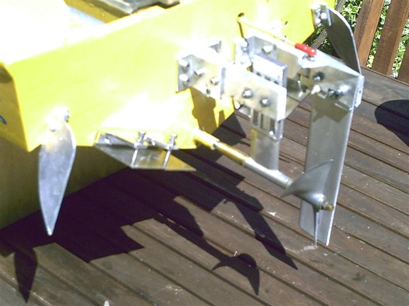

Try a Prather 275 you wont have the rpm for the 270,i used a 280 on my 28 cc weedy in the same boat,by the way its not a wildthing it just looks similar.Use brass tubing for the flex,you can buy flexes welded to a stainless shaft,buy a strut and rudder or at least a strut then make the rudder if you wish.Struts with bushings in are cheap nowadays.Heresa pic of my version i change a few things on mine,i made this ruddermyself but the strut is a bought one,trim tabs i bought turn fins i made.

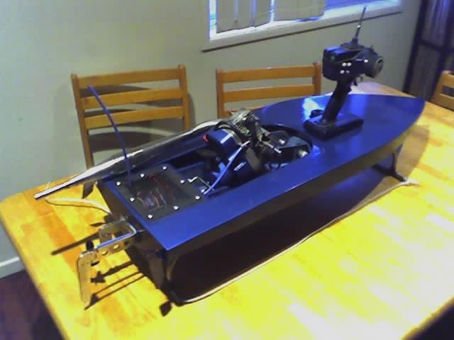

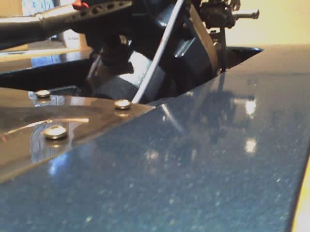

Ok so my first boat build is done !:woohoo: For some reason it ended up 41inches instead of 48, I did print it out 1to1 with CAD. Well thats what tou get with free plans.lol I have done some port work and also some piston work, aswell as making a tuned pipe for it. So it is no longer a standard 21.2cc MacColluck engine. It is finished in a blue metallic 2pack clear over base and all the hardware was made by me at work as I didnt want to spend any money on what I could do myself ! Alas it was too late by the time I got home with it today so it will have to get wet tommorow.B)

Not very clear pics! Sorry they were taken on my phone!:(

marc replied the topic: Re:48inch 'wildthing'Mono
Looking good. Let us know how it runs. It looks like you don't have trim tabs on your boat...it might need some. You'll know when you run it.
