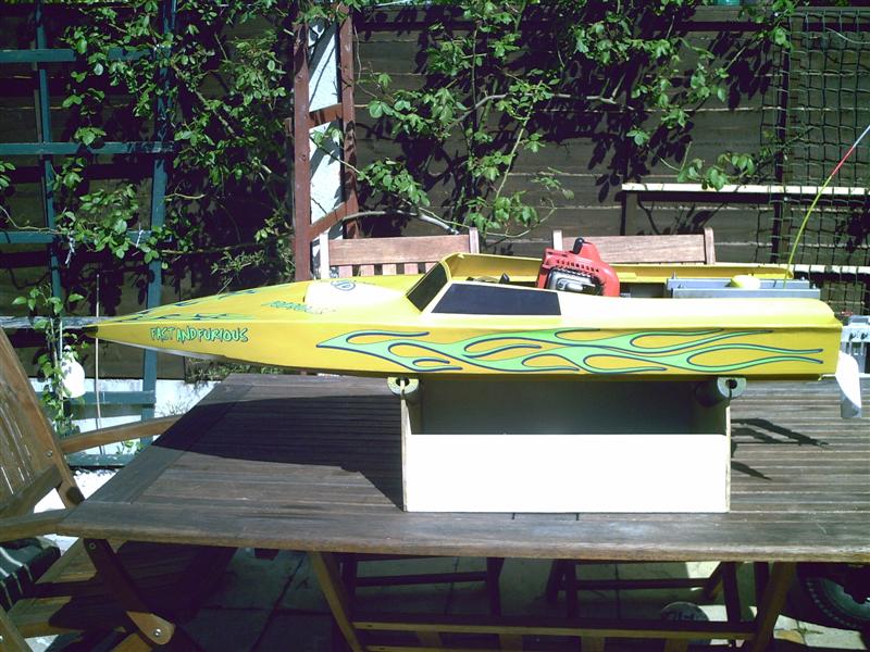

Hi mate your best option is to get hold of the plans for the 48" wooden deep vee,its an easy build and the hull runs very well indeed.I built one as my first gas boat a few yrs ago and used a 28 cc weedy engine,i kept her air cooled and ran her with the stock muffler for most of the time i had her although i did try a tuned pipe but i had to custom fit a header as the ones available wont fit most weedy engines.Where are you from?,i build a glass vee capable of running with a weedy engine but shipping over the pond is way too high.If by chance your over this side it wont be a problem.
Mart

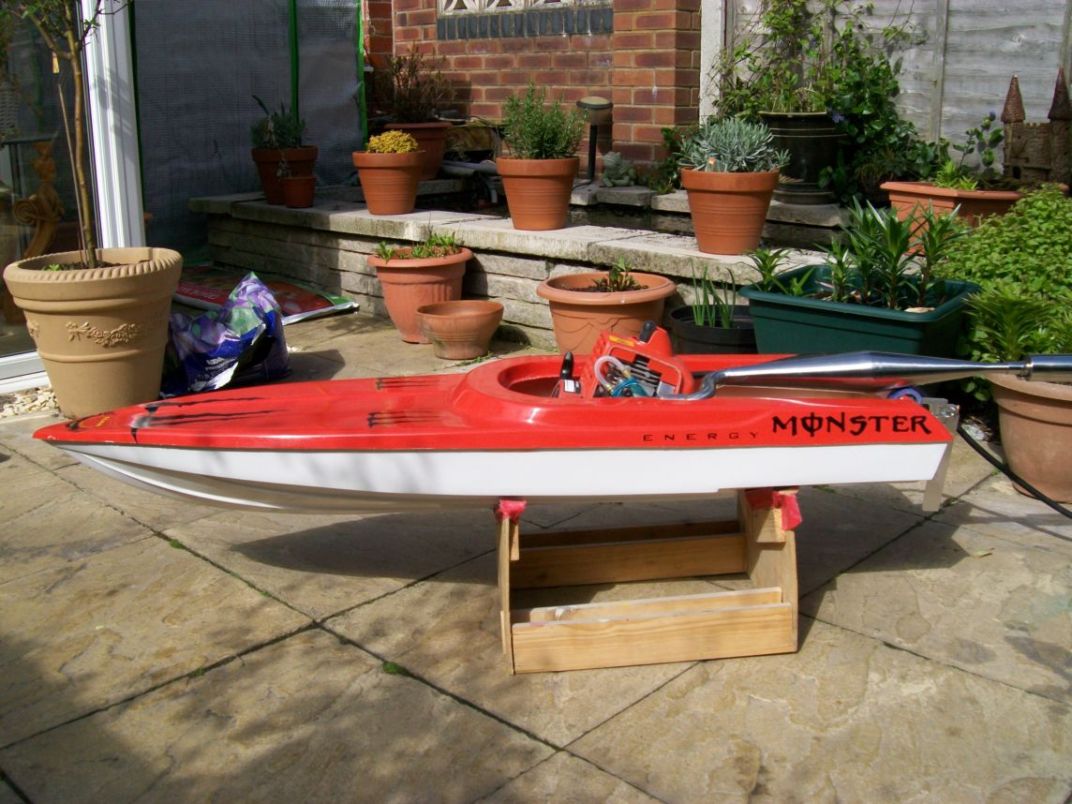

Heres the glass one i build and a video of its maiden,she runs about 30 mph pretty easy.I did some porting on her after the vid and also tweaked the prop and shes running a lot faster than the video now according to the guy i built her for.
Mart

hey how fast did that boat go with that weed eater in it. Some people say that weed wackers aren't worth it. I got the weed wacker for free and i want to keep this low budget. How long did it take you to build that 48 wood plan boat???

Hi mate not sure of the exact speed on her but the woody with same motor was clocked at 30mph with the same motor in stock form apart from a walbro 167 carb.The one in the red hull has had minor porting work done and i custom fitted an all in one pipe.Shes faster than the woody so id say shes 30 + now for sure,in that vid was before i did more work on the motor and prop etc.In the vid id say shes arround 25 maybea tad more its hard to say for sure.The guy who has her now says shes running very well,so for a cheap starter boat you cant go wrong with a weedy motor.From starting the woody to water only took me 8 weeks doing a bit here and there but i know guys who have taken a yr :laugh: .
Mart

dpg10 replied the topic: Re:getting started!!!- i need a hull and lots of help!!!!!!
your boat looks like it is the same plan built boat as the other guy. I think im gonna make that hull, cause i have the plans for it. hows that hull run ?
