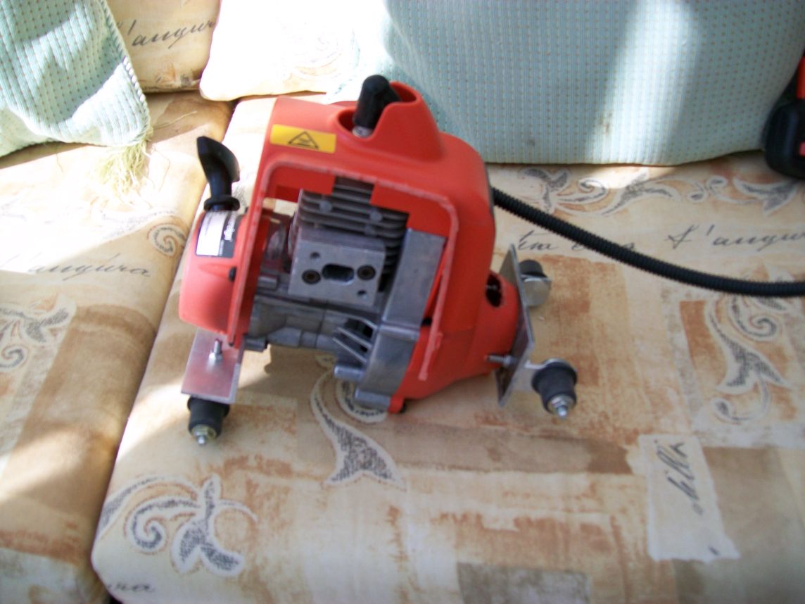

yeah i just want a simple boat for crusing and jump the waves. i got the weed wacker for free and i think im gonna make the deep v 48 inch off the plans tab. i've heard its a easy build but we'll see.

I agree with Roger... Was going to post it at some point. For the money you'll spend on wood materials and time to trace and cut the parts out with, it is well worth the money. They nearly put themselves together, and you have support to boot. They sell hardware, so you can almost put something together package-wise. Not to mention a wealth of knowledge to pull from on this site. Not too sure on the motor you have, I know the rails will probably need to be altered, or you could sell that motor and buy a 230 or 260. That is more the standard way to go. You also will eliminate a step for yourself if you decide to go with a Zen later.:? ;)

Zippkits make exellent kits but theres nothing wrong with using the plans available theyre simple to follow and the boat is every bit as good as the easy vee ;) .Also 5" rails is what i used for the weedy powered boats ive built so when or if you want to get a zenoah later all you need is mounts ,a pipe and your good to go.

Yea the kits are very nice and easy to build.That said if you do decide to use the plans theyre pretty easy to figure out.Sure if you do want to go with a zenoah later then you might have to move the motor slightly it just depends ,so long as she balalnces arround 30-32 % then she will be fine.Incidently once id removed part of the shroud on the weedy the weight difference compaired to the zen wasnt really as much as people told me it would b.A few ounces is all certainly not twice the weight as i was told when i first started out.Dont be put off if its what you want to do,i plan on using one in my sons boat as they make great first starter boats for anyone wanting to give it a go.Leave the shroud on in front though as it helps direct the air to where its needed.
