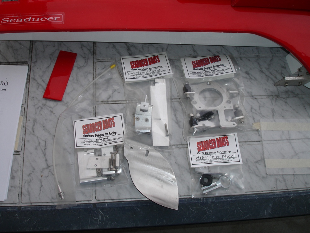

philippe74 replied the topic: Re:Seaducer Hydro
Hy Guys.
I Bulit a Seaducer Hydro.
With the Original Seaducer Hardware Kit. And a CC Full mod .Zeni:laugh:
#3001
Whipper Dipper replied the topic: Re:Seaducer Hydro
Hey Phil, I've got the same setup. Pics of mine are in the gallery. You're gonna like it. Very competitive race boat!
