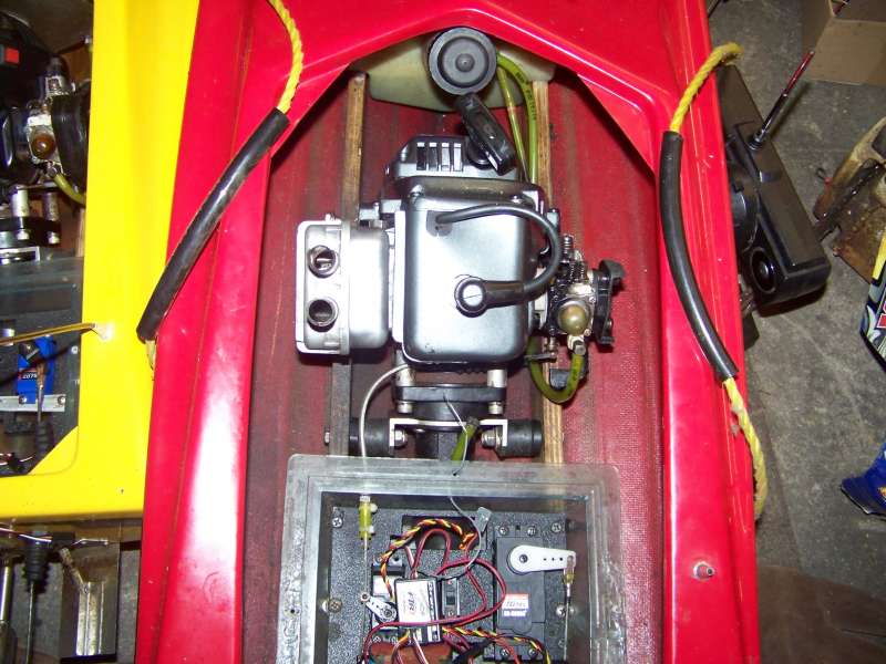

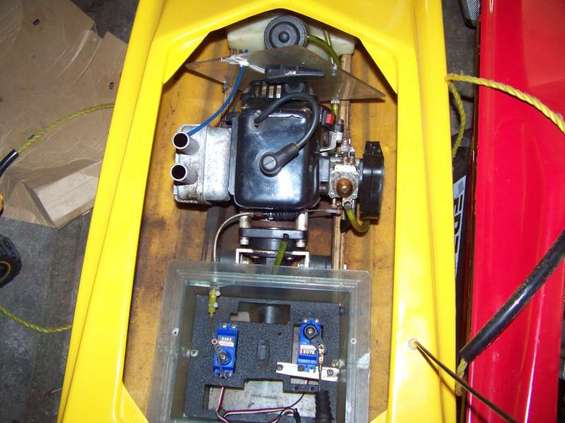

Hello, new here. I just got two Gators 47", I think they are zen g230 engines? I rebuilt the carbs and replaced all the servos. they run good. I was looking for any mods I can make? I put a 78mm prop on one that helped it was 75mm same pitch. I have seen the mods on the g26. but my jug looks like it came from the factory with those port mods already? The model on the tag says Super Gator the ser.# is ktr150r329114. Any info on the motor and boat would be great Thanks Rob

Hi Rob, When the boats come from WHH (Warehouse Hobbies) as a RTR they would come with 3 options a stock G260PUM or a M5 or a M6 the M6 is a ported engine. You would get more info from WHH forum Although Bonzi sports has purchased WHH and enforcer boat they know the history of the haul and maybe the engine. I have been told that Tony jr works for Daniel Hofman

Yep the first two boats are older. that's why I was looking to see if anyone knew anything about them. Can't find much on the web? The Montaray is newer I guess. lol. I have talked to Bonzi not real impressed. I own a lawn mower shop in Fl. I have ported 2 strokes for gopeds etc. The ports on the 2 older ones look like the port job in a video on here of a g26 Zenoah already done?

The engine looks like the "homelite" version before the zenoah series. I also think it's the 30cc version with the "big bore" carb.

Yes is has the back plate like a homelite. I thought the same. I don't like them. I prolly have 50 blown up weedeaters out back for parts! LOL
