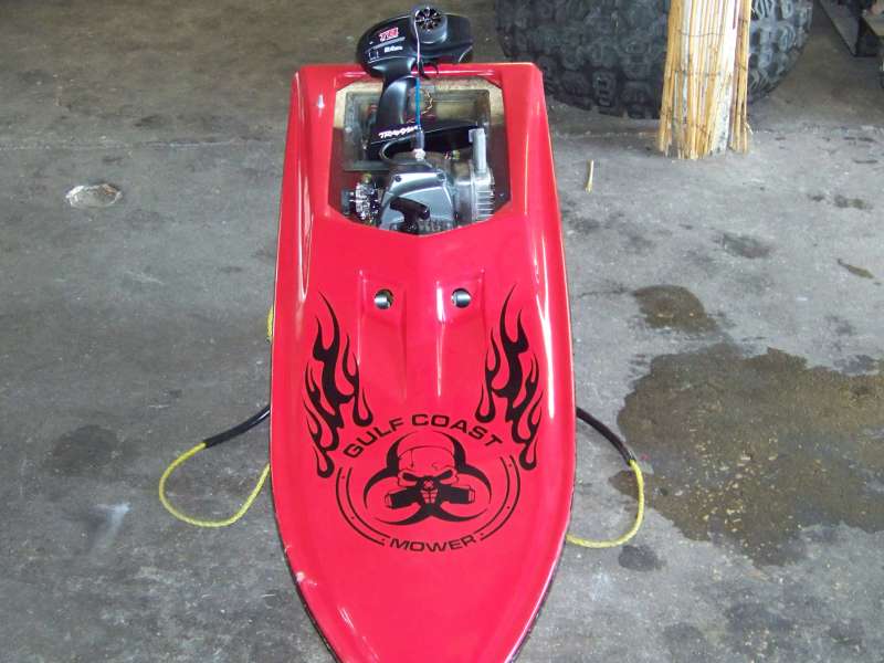

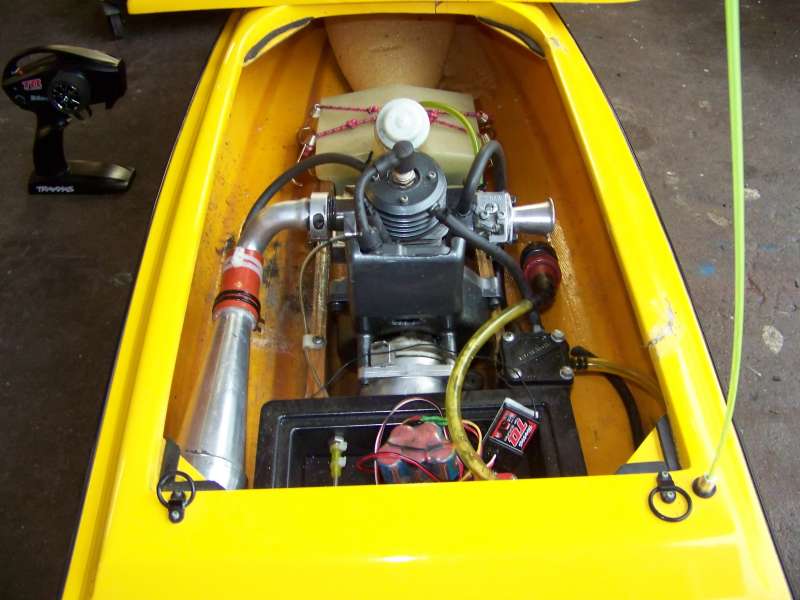

Ok put a new coil on the homelite. Ported the intake to match the heat dam on the Big bore carb. lol ported the exhaust also. Runs great! 2 probs. I don't like the clutch system. it's not a clutch with shoes and springs. it's 2 spring loaded plates. never really want's to release at idle. Also I leak water at the prop shaft hole. there is no liner in it. I assume that's why it leaks??? What would be the fix. Thanks Rob

Not sure when WHH stared to use the "iso pad" to hold the 3/8" stuffing tube. The stuffing tube should be flush with transom, the iso pad is a rubber block held in by silicone. The leak at the transom is no big deal, remove radio box and dad silicone near the transom and the front of the iso pad. Here's an after thought the stuffing tube may have been switched out with a smaller size. There is a long discussion about liners, to each his own on that.

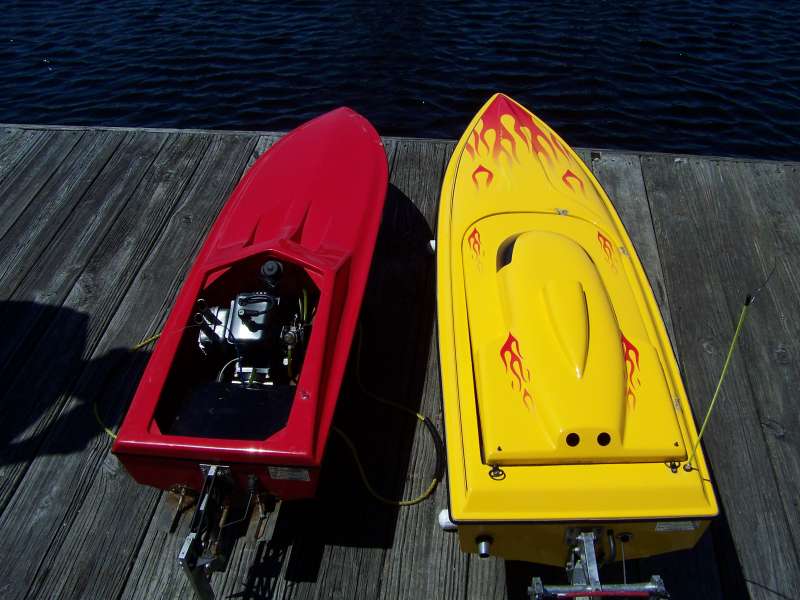

Gulf Coast replied the topic: Enfocer Super gator boats. What engine do they have and what mods can i make?
Thanks i'll look into "white gas" more. Ya I'm way past neutral. :evil: Red boat is ready to race.
