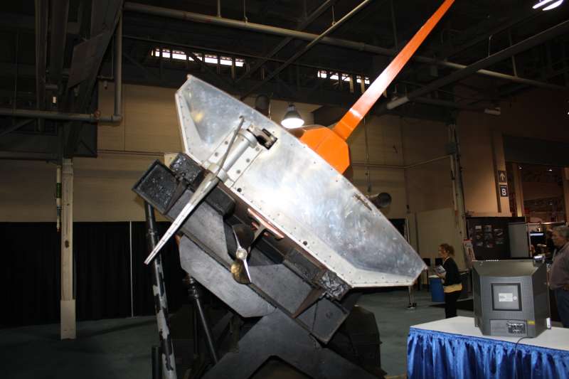

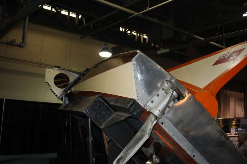

What kind of engine are you going to use in this very famous Canadian hydro driven by Bob Hayward & Jim Thompson? Because your hull is so large, 59.1" long X 23.6" wide, you will probably have to make the under the hull strut that was used on this boat. I'll post some pictures if I can locate them.

Pictures of Supertest's transom. Sorry, the files failed to upload. Don't know why.

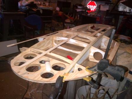

mephiskapheles6 replied the topic: New here...
#21915
got it!!! have a very difficult time figuring out the captcha code thingy it would seem
