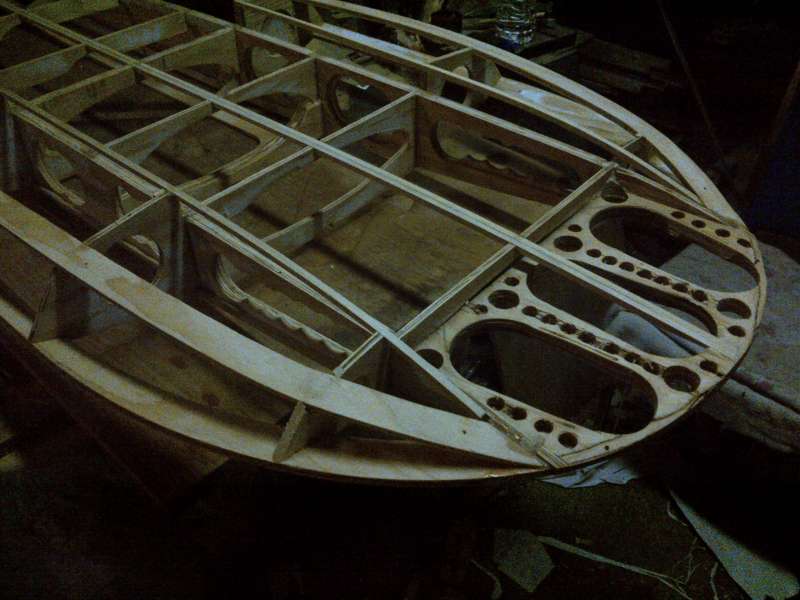

Hugh replied the topic: New here...
You need to make sure you waterproof that wood. Shaving weight as much as possible will help the performance of the boat. It looks like a really good foundation youve started there.

mephiskapheles6 replied the topic: New here...
I removed another 300g of wood, see pic, but that is all I can do without compromising the structural integrity...she now weighs 3.3kg (7.3lbs) without the decking.
I plan on using System Three penetrating epoxy to seal up the wood.

strictlybusiness1 replied the topic: New here...
Corey,
A large boat such as this could easily gain 1 1/2 to 2 lbs in paint because all he wood surfaces need to be sealed inside & outside. This would include the bottom skins, the underside & topside of the deck skins, all the edges & surfaces of the frames.
