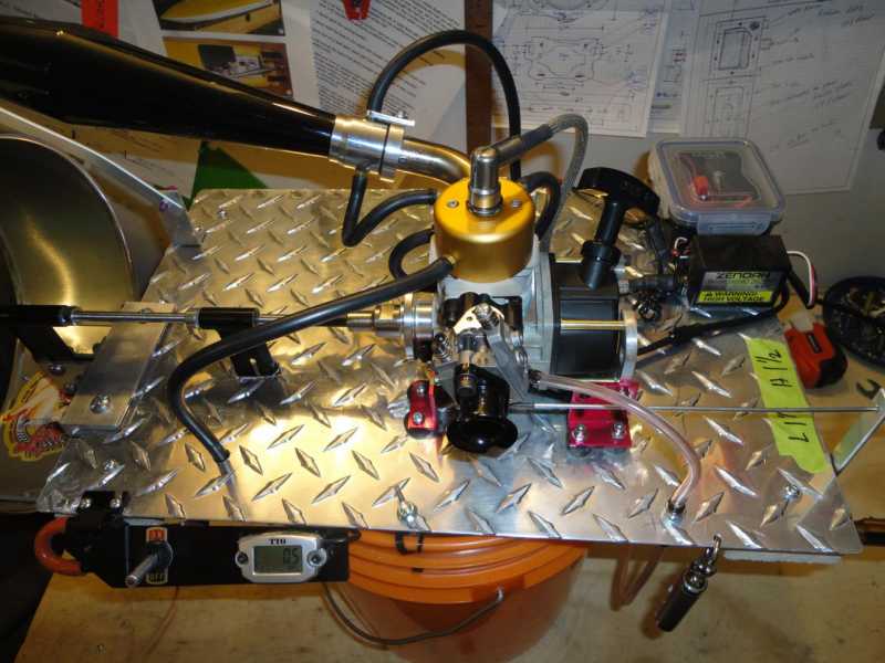

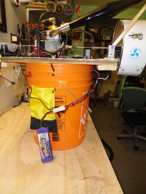

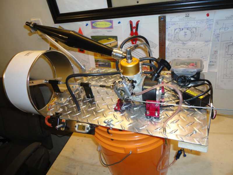

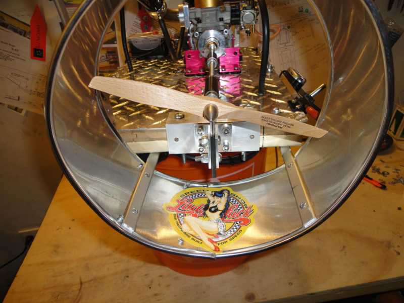

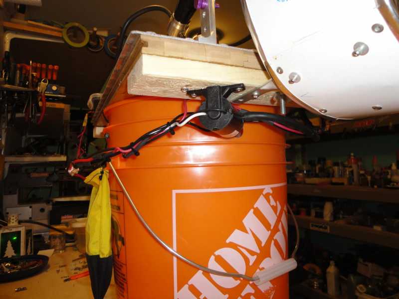

This is my stand I use - I had to mod the top plate for the 'little guy' G200 - but you get the idea
Where I live it's kind of cold - so hooking up a hose isn't always a option
I use a simple stand - mounted on a Home Depot 5 gal pail
wood top with alum plate (checkplate is a pain) held on with 'j' bolts and wing nuts to pail
under one end is a fuel bag + filter
under other is a 12 v windshield washer pump - to switch - to 6 cell Ni Cd batteries (left over from
RC truck starters)
mount brackets are Pro Boat rubber mt brackets with rubber bases or mounts
square drive 1/4" to diff air plane props - drive supported by roller bearing struts
Simple - start - warm up - turn on pump (circulates back to bucket)
Cheers - video or pictures explain better than me (I have a cold sorry for voice)
Oh and I only run 'em - I don't try to kill 'em on my stand so no high revs
