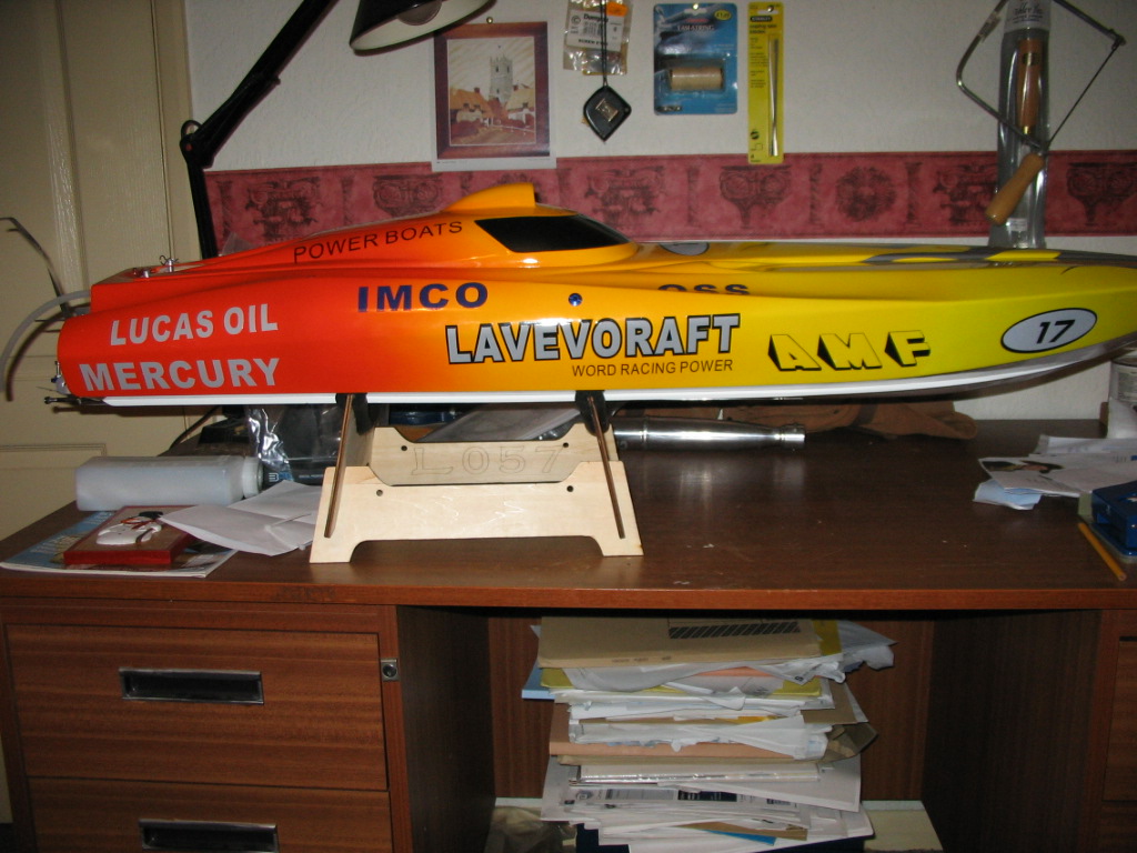

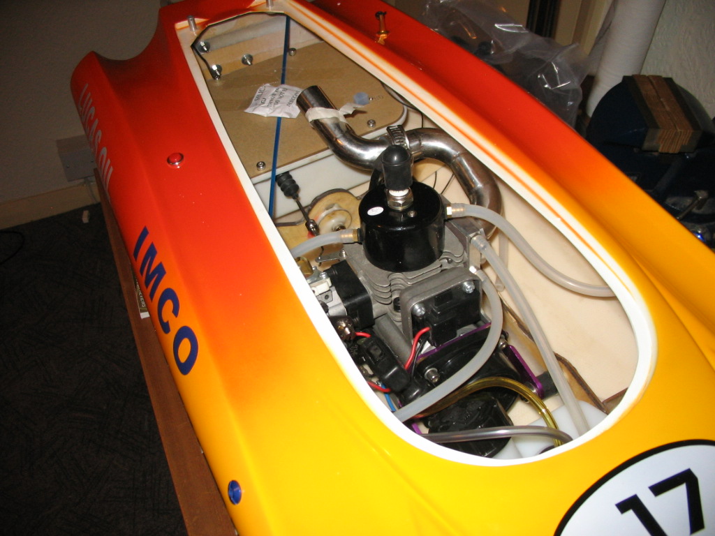

Hi Zenoah
My first ever Gas boat was a ready to run Flybridge.
These two images show it as it came out of the box. Is it similar to your boat I wonder?
The first thing I did even prior to running the boat was scrap the radio gear that came with it and replace it with Spektrum 2.4G hardware. I figured that with a gas engine powered boat, the extra cost of radio gear that will not suffer interference is in fact an investment well worth while.
After the first run, the next thing I did was scrap the weak manifold and header that came with the engine and replace it with quality components. I eventually ended up with a great fun boat after making further modifications.

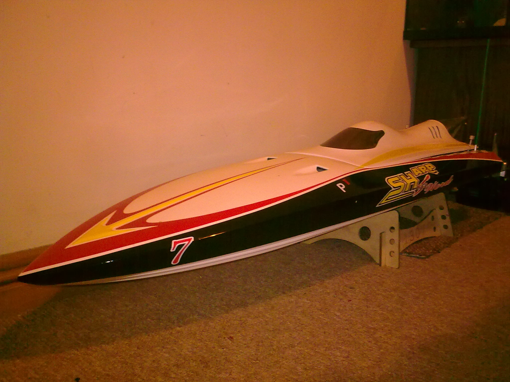

Thanks for the answers guys. Craig your boat looks slightly similar in the shape, engine, stand and some of the bits and bobs in the background of the first picture and the layout of the cooling etc looks the same. Ill put a picture up soon. Ive already replaced the manifold as well...pretty much everything in the boat bar the engine has been replaced.

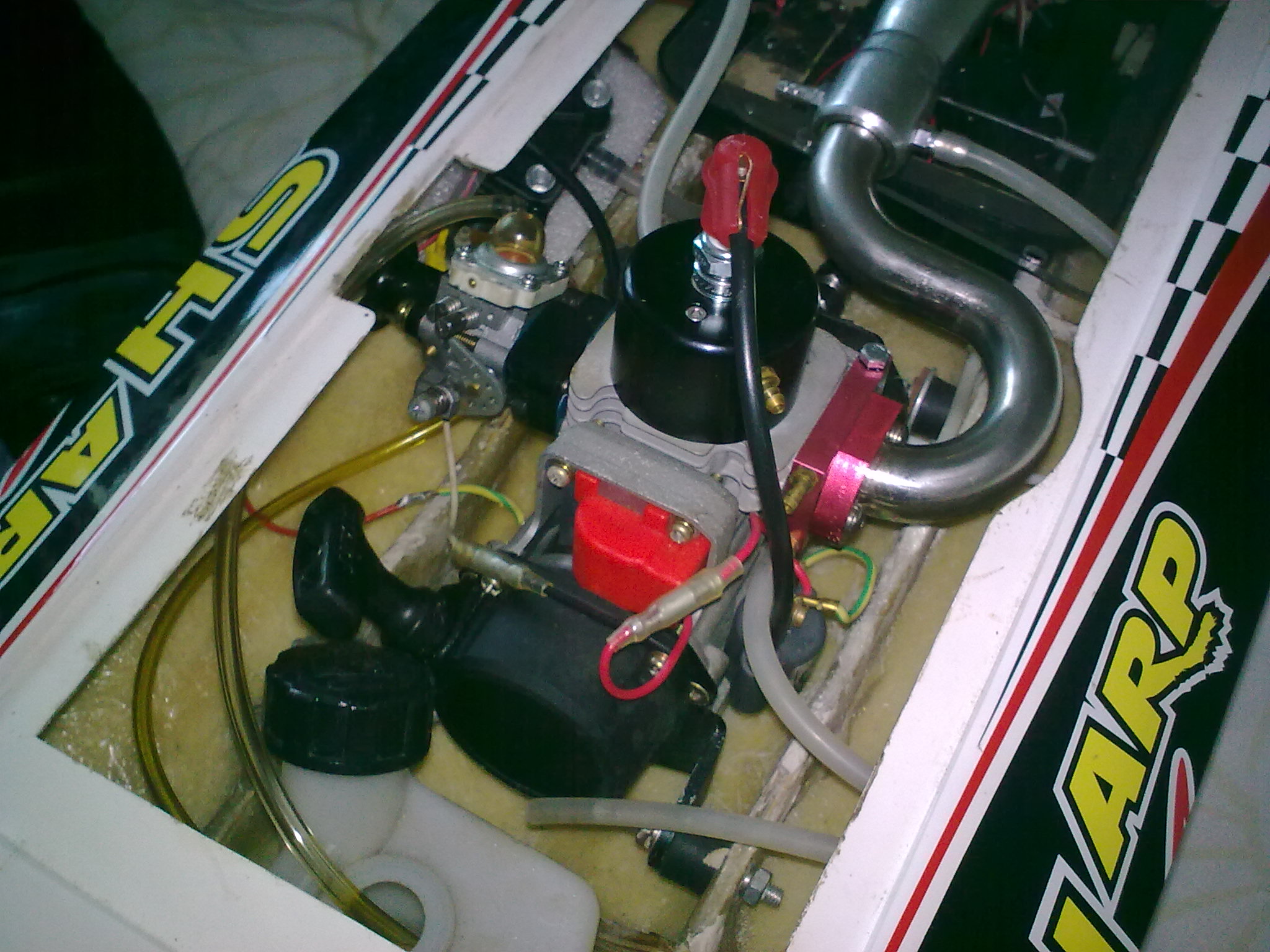

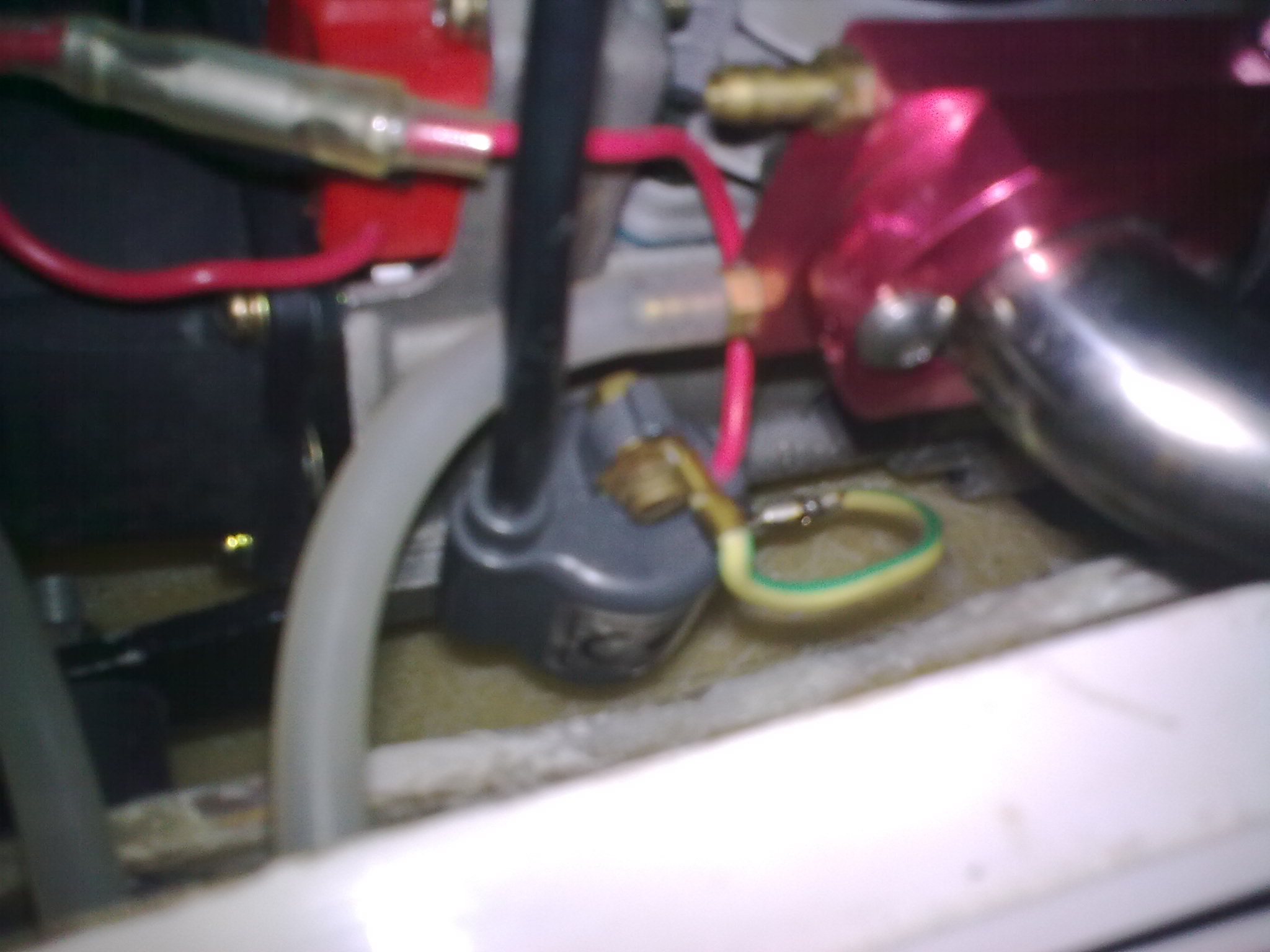

BrandonC replied the topic: Re: Futaba Crystals
What do you mean by the resistor incorporated spark plug?? I know on my spark plug lead there is a grey cylinder which is connected to both the magneto and the spark plug but that is the coil isn't it??? But apart from that there are no other electrical gizmos on any of the electrical wires from the magneto or anything.
Also during the process of the rebuild, the wire to the kill switch were lengthened and as I had to change the angle of the engine and so on I couldn't mount the coil where and exactly how it was (it was bolted directly onto the engine) so I wired its earth separately.
Pics are attached
Thanks.
