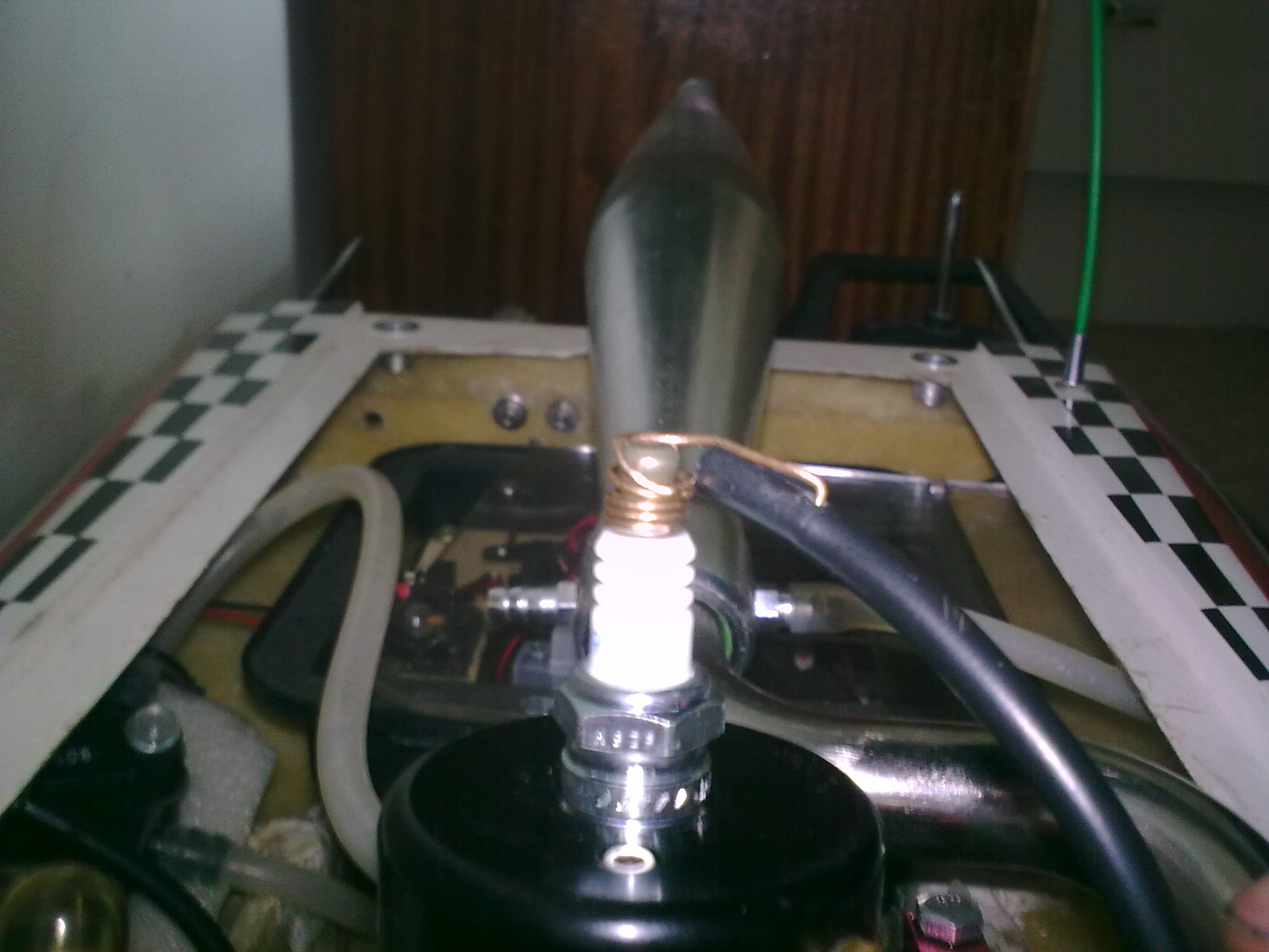

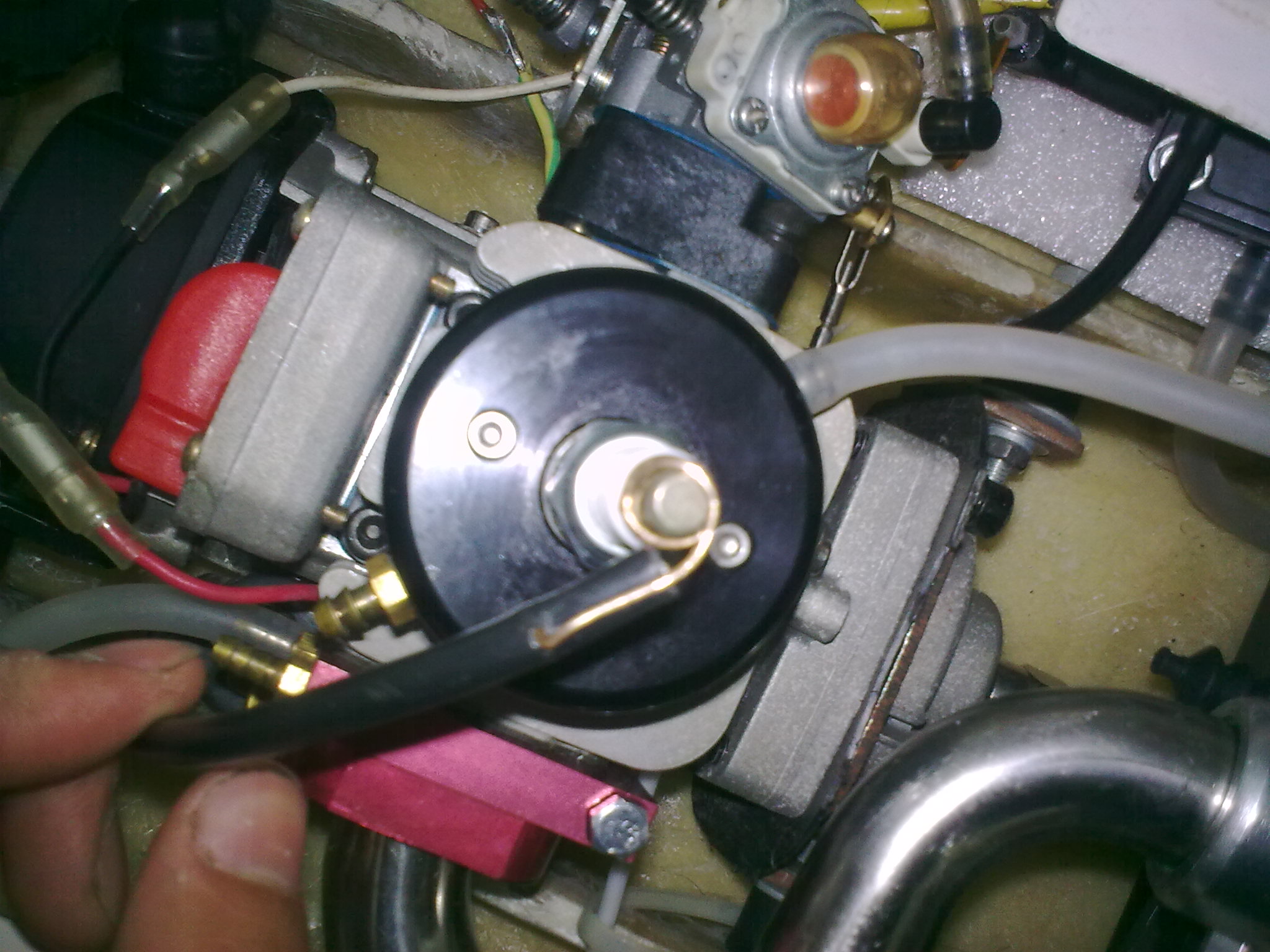

BrandonC replied the topic: Re: Futaba Crystals
Hi,
In using resistor plugs alright. The last time it ran it had a Champion RZ7C in it but from now on I'm going to use a NGK CMR7H.
I noticed the connector on the spark plug lead is simply a coil of copper wire (pic attached). But doesn't a coil of copper with current going through it not cause a magnetic field?? Is this the source of the problem maybe or is this type of connector standard issue?
Thanks.

Craig Dickson replied the topic: Re: Futaba Crystals
Hi
I much appreciate the images as it makes your topic much better and yours is a great looking mono I must say!
On the plugs, I’m glad you’ve confirmed it is the resistor type. Both the NGK and Champion models that you referred to work fine in the Zenoah. I’ve been using the Champion R27C for two years and it still works fine.
In respect of the plug lead connector, I have seen that type used on several engines without interference issues. However personally I don’t like that design because if nothing else it can be fiddly to remove and re-connect which is a nuisance when wanting to quickly remove the plug. It is in my opinion a crude connection.
Hi Craig,
Actually I removed the stock fuel tank filter from mine also because it got broken.
It is a nice looking boat which is what struck me when I bought it and it was relatively cheap but had the same specs as more expensive boats. But it would look sooo much better on the water!! :dry: Yours is a very nice one as well, I like the more racing oriented decals on it rather than the superficial ones on mine. Where did you get your radio system and how much if you don't mind my asking.
I think I'll try it at a different lake and see if the interference still continues and replace the spark plug connector other than that not much else to be done it seems.
