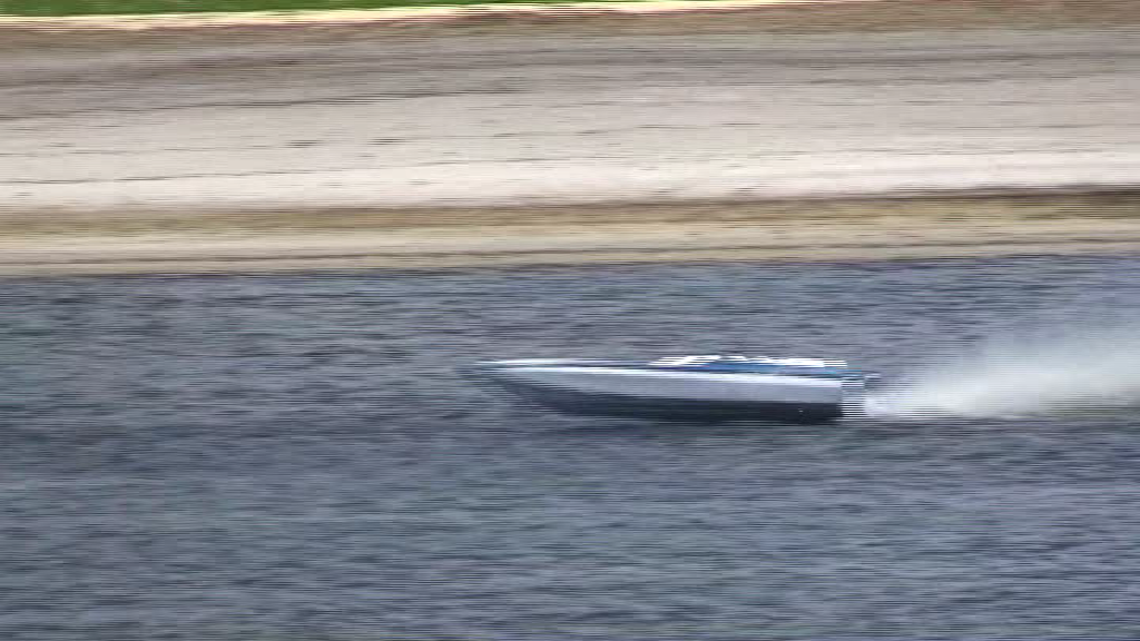

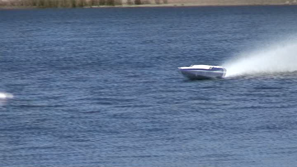

seahawkwa replied the topic: Re:props to suit 56inch apache and small vid
here is a small clip of my 56 apache out for a run. sorry about the quality of the clip...

marc replied the topic: Re:props to suit 56inch apache and small vid
Looks good! Camera man had a hard time staying on it! :D
