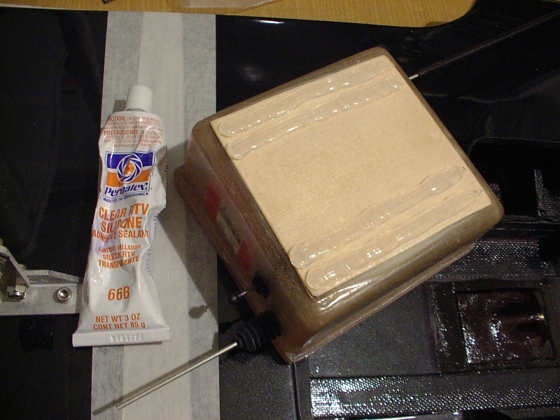

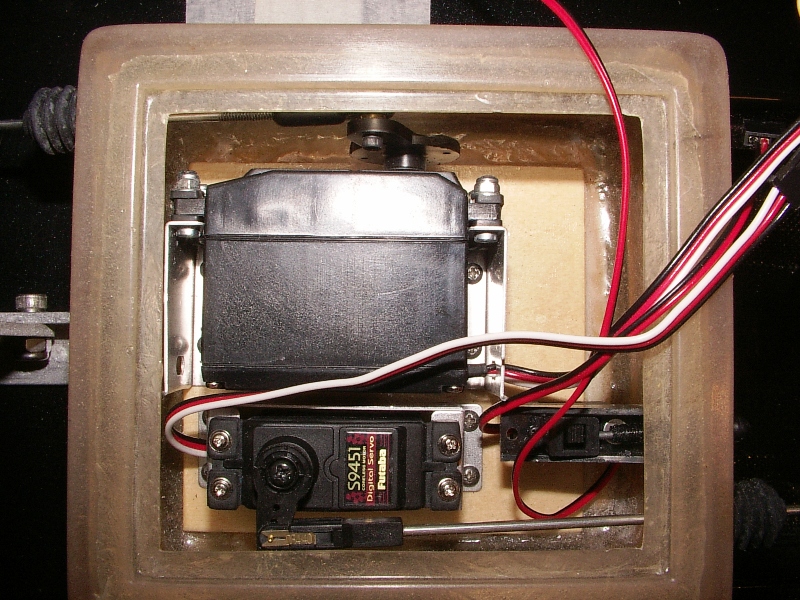

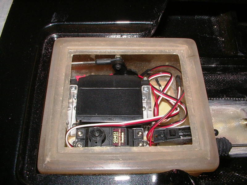

This is my first post, and I want to share with you, how I build a box for INSANE HYDRO Gen 2.
I use a Aeromarine's big scale and standard servo trays, also I glue a hard ply for reinforcing it.
The box I fix with PERMATEX silicone - excellent anti-vibrationg glue, gas / oil resist. Clear after dismantling.
