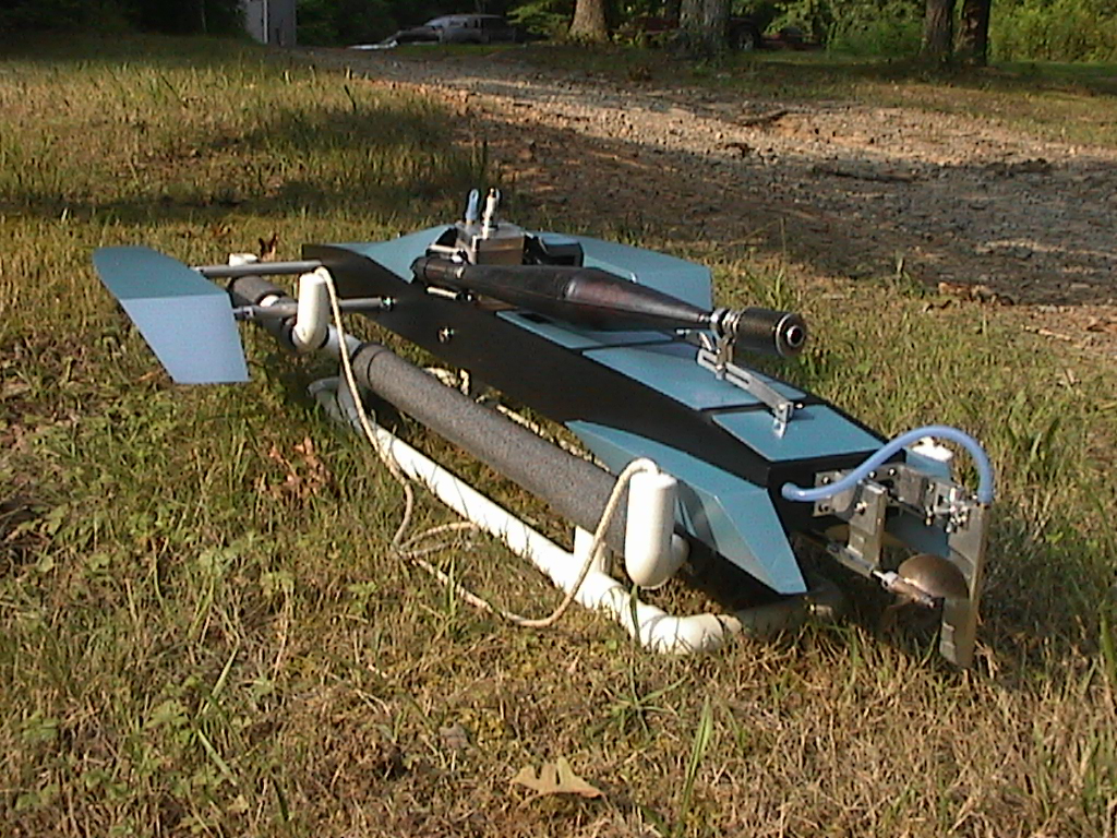

just about ready to hit the pond sunday.

Looks ready to throw in the lake.Even got it painted.Hope it goes good for you.Looks like abc prop like a 2716/2 blade.Should put you in the 70 mph range easy!
#3423
INEEDSPOTS replied the topic: Re:my FireFighter rigger

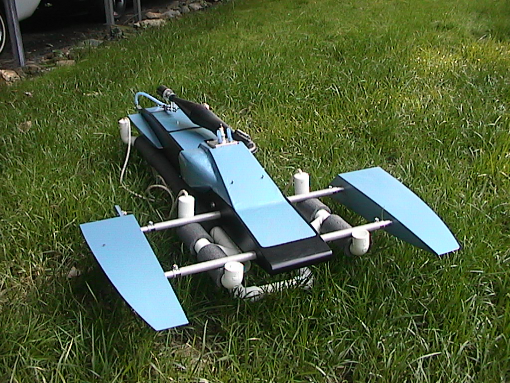

thanks bruce... yea got bored yesterday so decided to throw some paint on it. Still need to cut up some vinyl for it and give it a little more flash. Prop is actually a 3014/2 Juice sent me.. did a small bar cut on it, but gonna try out 6717/3 first then work my way up in props. Was gonna have a 20* 2716/2 to try, but it didnt come so no biggy. Not too worried about speeds right now, just want to see it launch and be able to get down to a decent mill speed and jump up and run some laps so i know if im entering it in race in 2 weeks.
BTW i cut down the fin a bit and made it match the curve in the spar. And doing so actually moved it foward a bit without having to drill new holes. Its still a bit deep.. maybe 4\" or so under the sponson. Got the sponsons set 7\" from tub to inside on both sides. Have pried like crazy on the sponsons and they dont seem to wanna budge, so the clamps seem to be working great sofar. Will found out for sure after they go through a bunch of vibration and bouncing around out on the water.

Roxyflash replied the topic: Re:my FireFighter rigger
You may want to shorten the water hose from rudder.Looks like it may hit the prop if it blows back from the speed and get cut by prop.I had it happen to mee on my whiplash.
Mart, the boat has finally started coming around. After making some AOA adjustments, Turn fin adjustments and strut adjustments its a much smoother and easier boat to drive, and is consistently running 72-73mph in oval trim.
