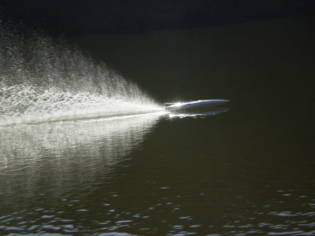

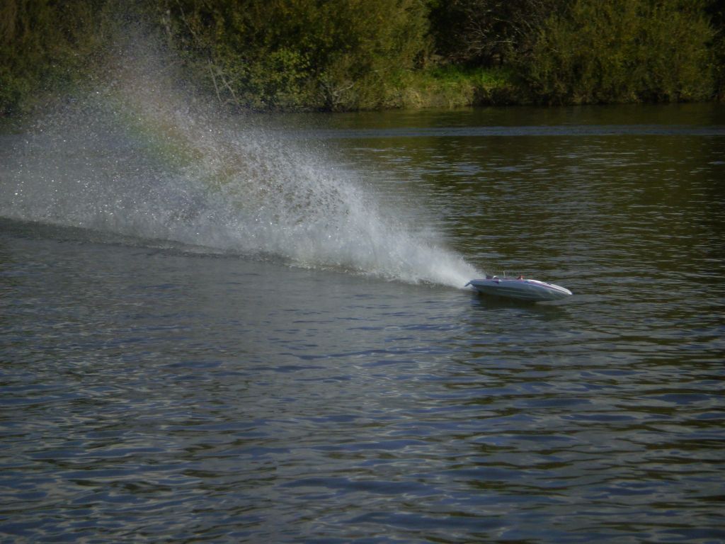

QDRevenger replied the topic: Re:My Arrowshark.
Went for a river run today, a couple of action pics.
QDRevenger.
