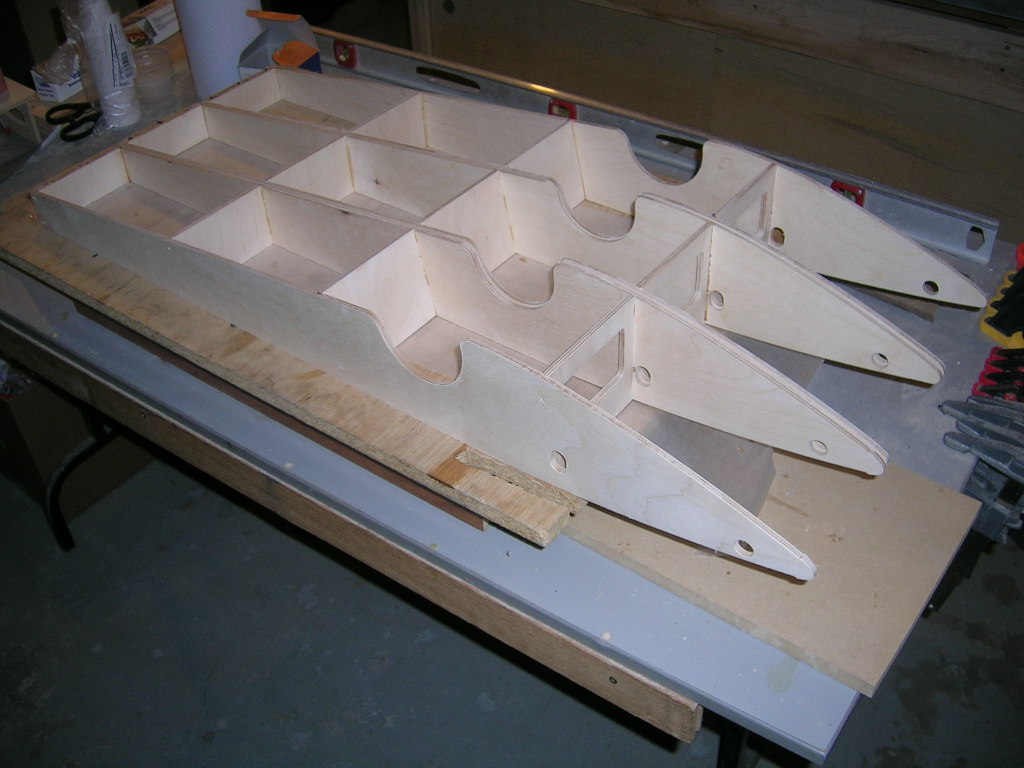

Actually it's just 3 tubs for Warpaths I'm building for guys! :) Thought it looked cool ha ha! A little short though!

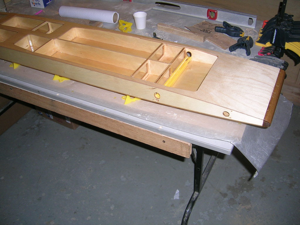

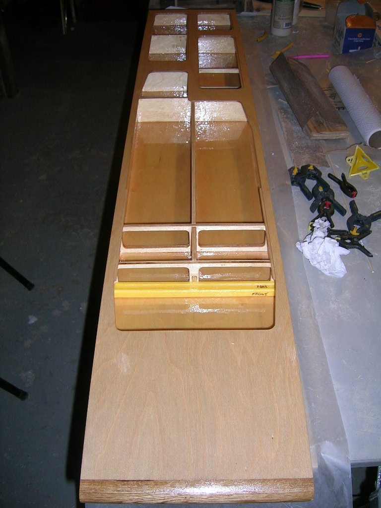

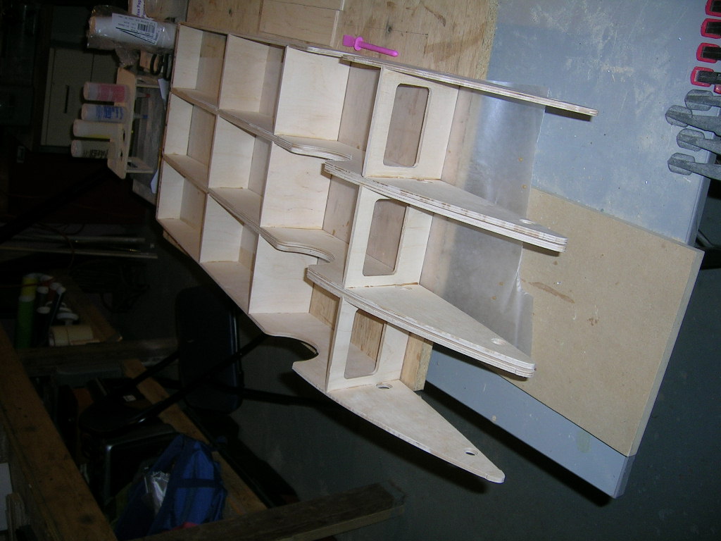

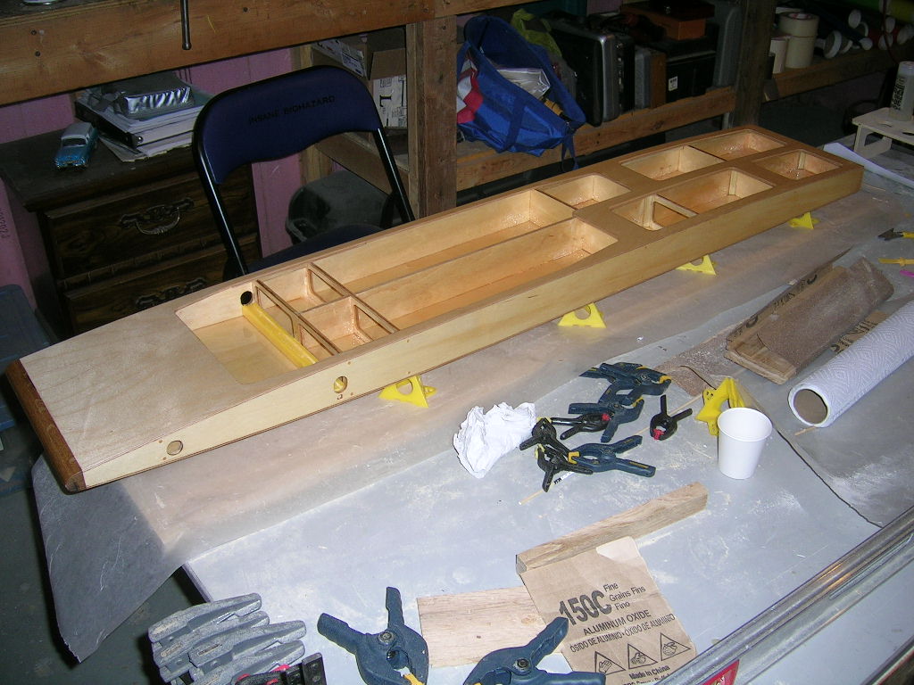

Here are a few pics of an actual tub I did for a friend lately...This is a side by side twin. He sent me his old tub and wanted it reproduced but 2" longer in the mid section yet keep all the same hatch openings and slide the cowl opening 2" back.. it was a fun project. The tub turned out stiffer than the original despite the added 2". Amazing what a couple hollowed out bulkheads and dowelling the sides will do to stiffen a tub! Turned out nice.
