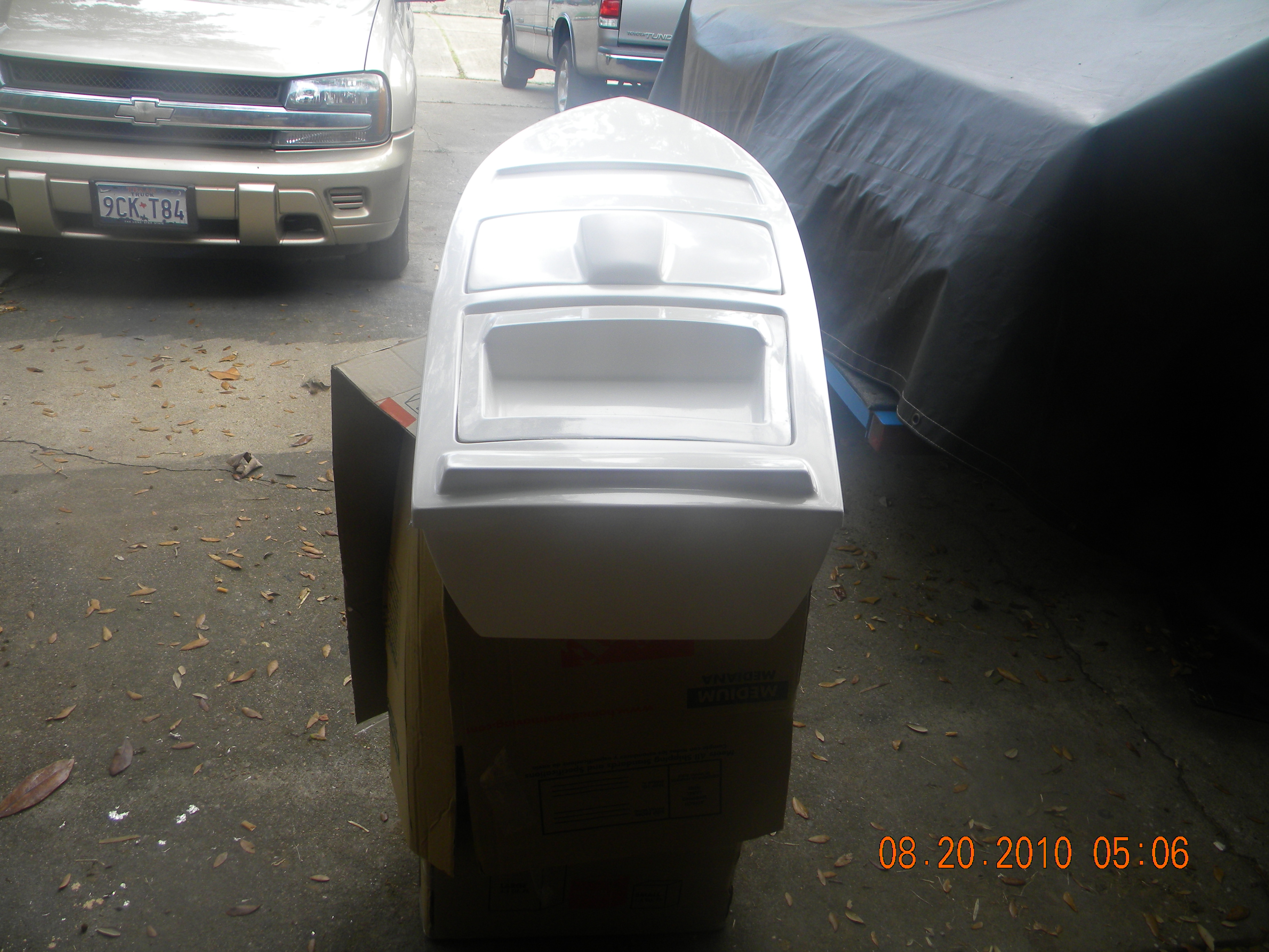

Ok fellas, got my new skiff in. It has a flat bottom on it so I need to know... Do I need to go with a submerged drive system, and if so, how far below the water line should the centerline of the prop be? And should I go with 30% rule, or should it be a little less? Thanks in advance for any help given. B)

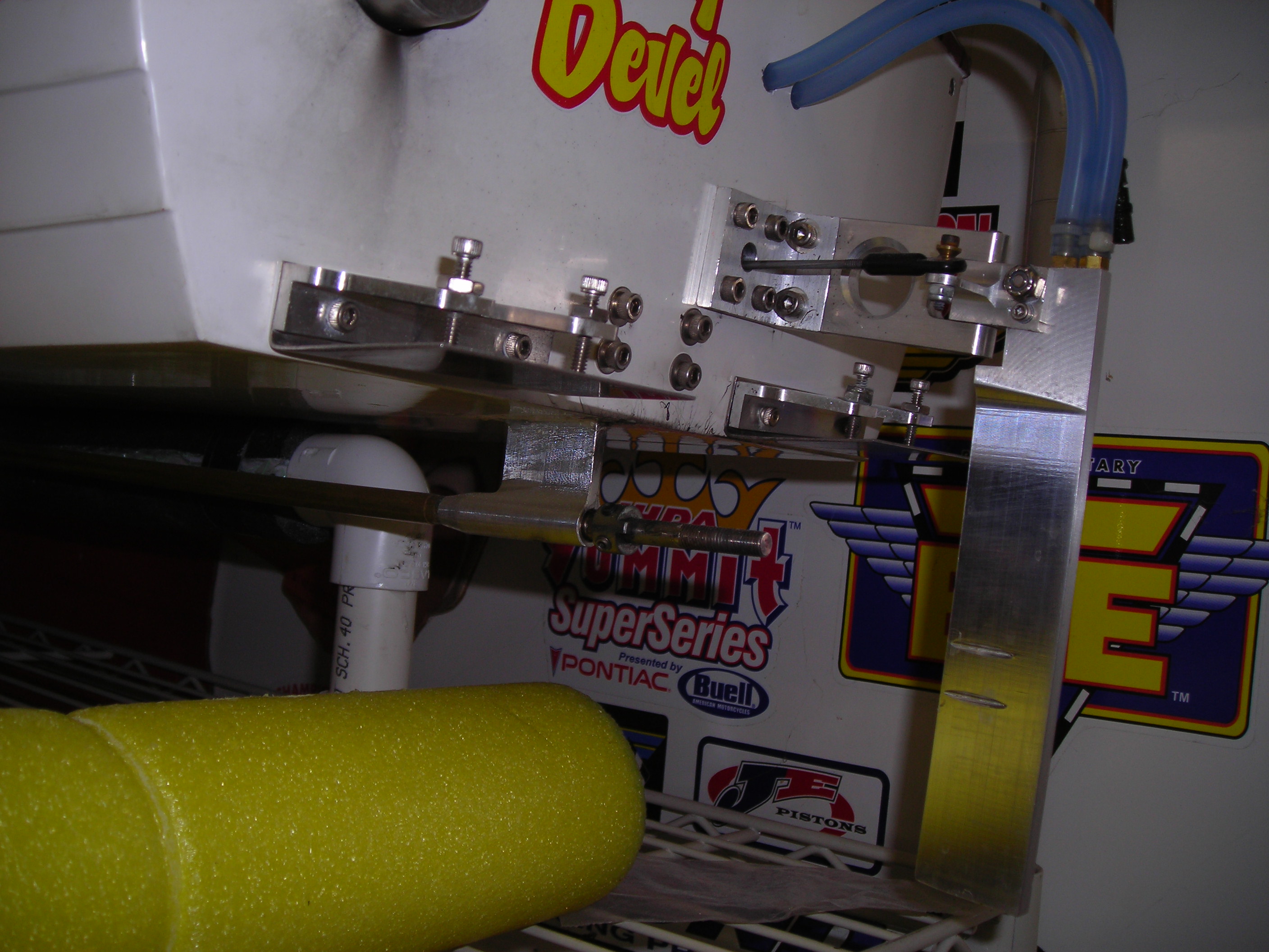

Hi! Jimmy Geiger gave me some tips on my Aeromarine skiff, I'll see if I cant dig them up for you. I believe the strut should be 1" below the bottom, with a 1 deg neg, motor as close to the front bulkhead (remember -Aeromarine, not sure if yours is an Aeromarine hull), rudder should be level (some skiffs have a slanted transom), tabs slightly above or even with the bottom. A pic of Jimmy's transom is attached, and then a couple of pics of mine...

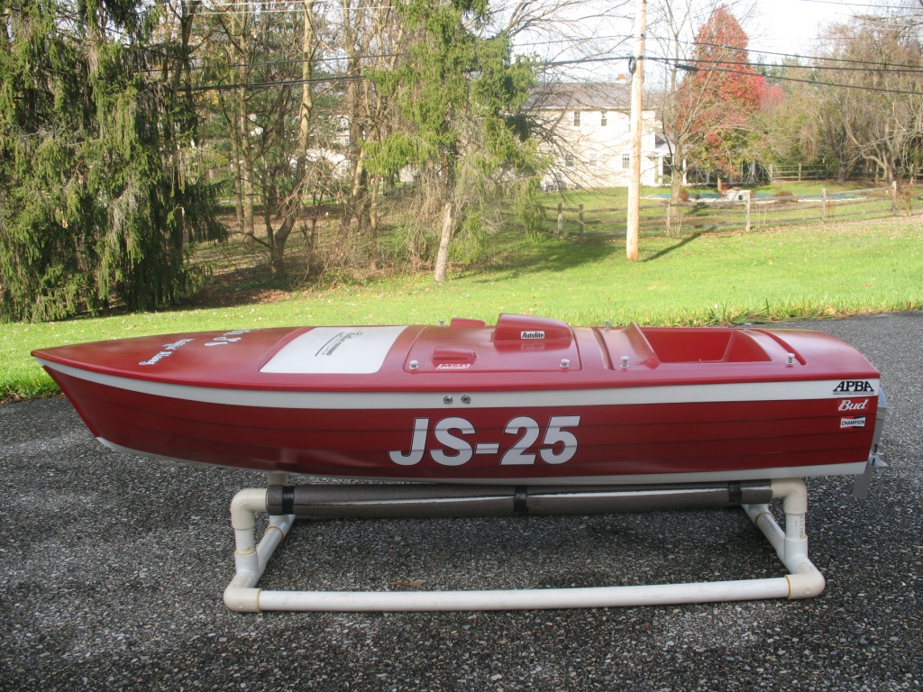

mitchesx replied the topic: Re:50" Skiff set up?
Side shot of mine.... Graphics came from Jimmy, Performance Graphix on the Home page - awesome person to deal with, reasonably priced, and will work with you to get what you want!

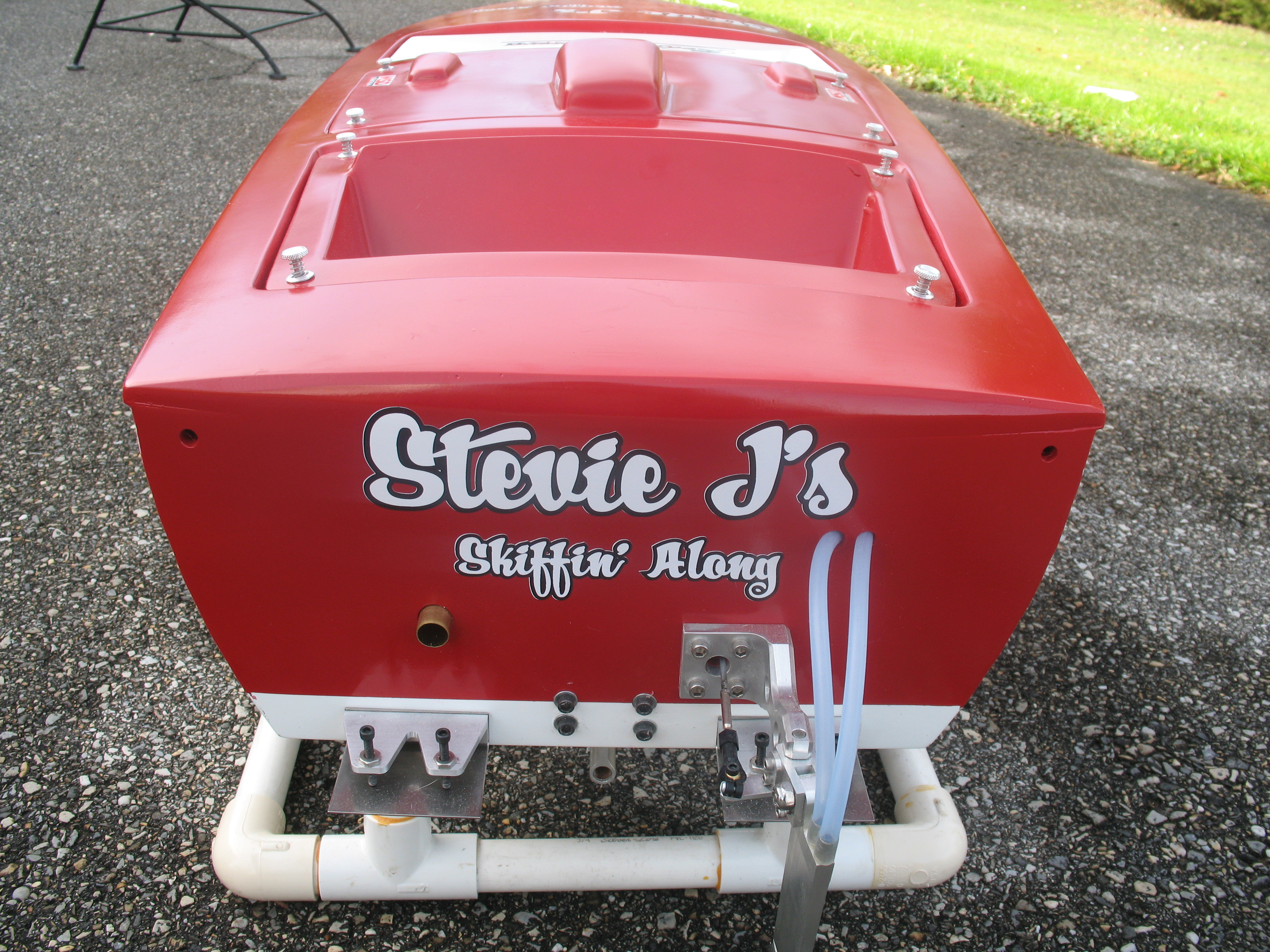

Transom shot of mine... I have a J&G in it, but its not completely done yet. Built it to run with my son when he's old enough.

isuzudude replied the topic: Re:50" Skiff set up?
Not sure of the make myself... looks just like though. Nice lookin' boats. Any information you could come with would be great. With the pics and what you told me, at least I've got a place to start!!!! B) Many Thanks!!!!!
