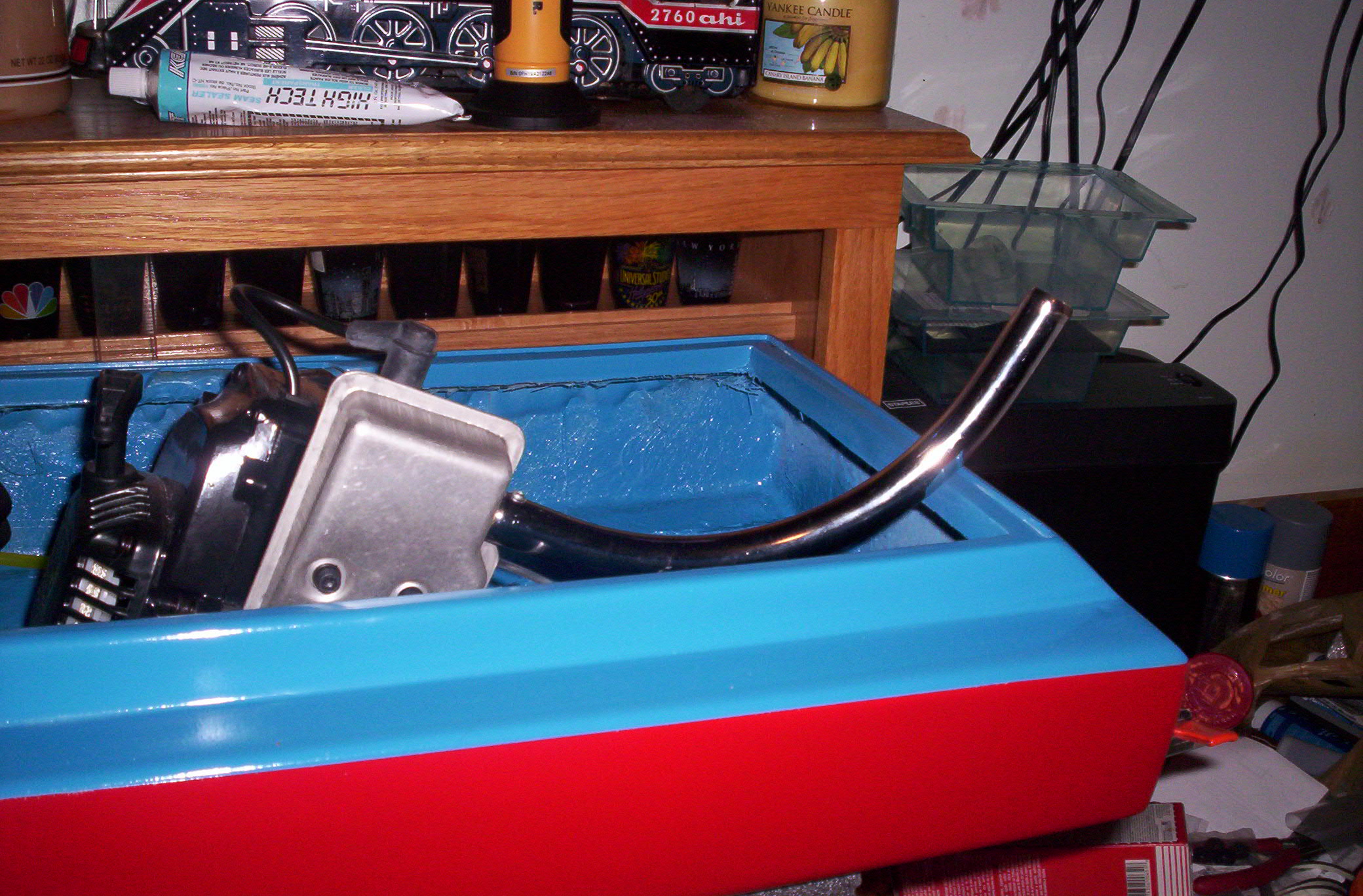

uprr replied the topic: Re:air cooled engine exhaust.
Here's a pic of my set up. Just getting into full gas and haveing a blast learning from you guy's!!
Made this sort of exhaust to solve my problem. can you tell what it's made of? If you guessed rv faucet your right!! Brass internal with thick chrome outer shell. Does the job and its CHROME!!! OH AH Not the ideall set up but I think it'll work, what do you think?
