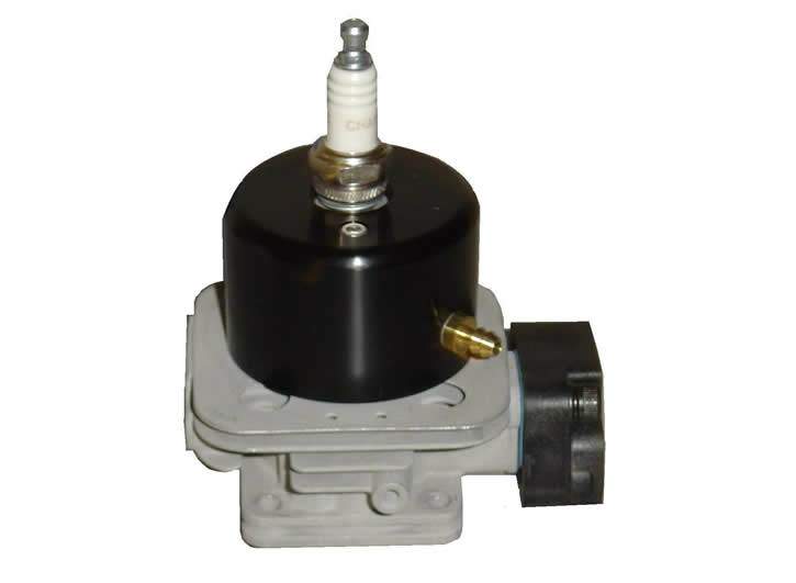

Scott replied the topic: Re: converting a zenoah g26 air to marine
Inexpensive as the 260 PUM ( Watercooled ) cylinders are @ $35 and a water jacket @ $15, o-rings and screws, would do that before paying a machine shop to remove fins and make a water cap along with a way in securing it ;)

#19586
ZeN parts: www.americanrcboats.com/produc...engzenparts.htm
Best deals the entire top end kit minus piston for $55
www.americanrcboats.com/images...en260topkit.jpg
