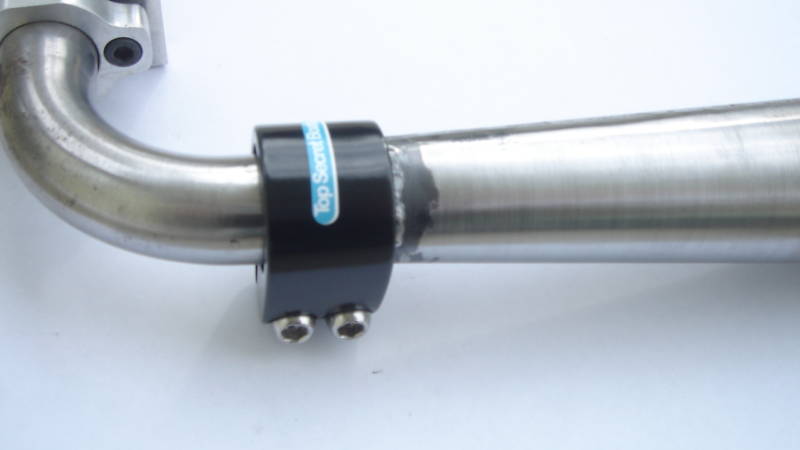

#14614
TopSecretBoats replied the topic: Re: CC Beast pipe clamp?
Try this one!!
Gas Boats are nothing but fun!
#14626
Mercury94 replied the topic: Re: CC Beast pipe clamp?
Checked your site and and ordered one for a 1 inch header. I will give it a try and let you know the results.
