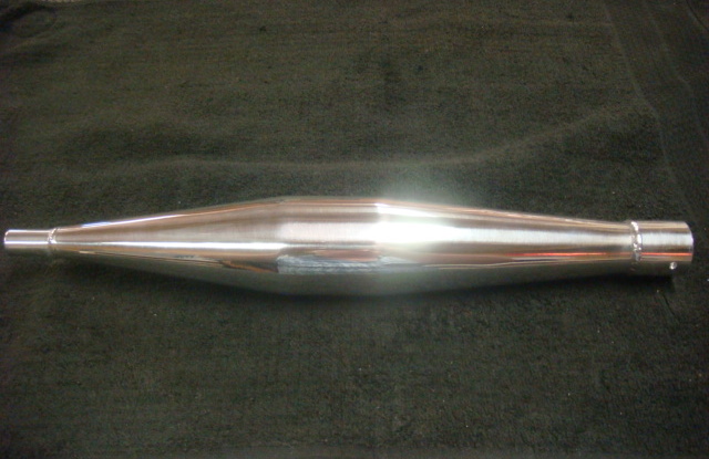

Canadian Hot Rod RC Boats replied the topic: Re:Best Pipe for a Stock Zen
Gizmo sells a Torquemaster pipe for around 75 and kit for 140 I believe .. I've had good luck with these pipes ... reasonable cost
#9103
Gone On Racing replied the topic: Re:Best Pipe for a Stock Zen
I run the same pipe on whip, Bruce at Gizmo to right of the page, has got these in stock now if he hasn't already sold out. I have a rampage mono, Your going to like it, Great speeds even with a stock zen. :drinks:
#9111
Mercury94 replied the topic: Re:Best Pipe for a Stock Zen
Are they 1 or 2 inch band pipes?
#9117
From Bruce's add (Gizmo to the right side of page)
This is our new 7/8 Torquemaster Pipe . This pipe comes with a high quality polished aluminum 2" band pipe with Internal stinger, This pipe requires no muffler. This is not the same cheap thin aluminum china pipes that you see being sold everywhere, these are American made high quality pipe at a very affordable price.after doing testing on most of the 2" band pipes on the market.these are the best performing pipes on the market
#9118
Fallen replied the topic: Re:Best Pipe for a Stock Zen
A mono does not really need as much low and midrange power as cats and hydros do so I prefer a 0 band pipe on them.
#9151
Hansen makes a Zero band water-cooled type pipe that I think are about $85.00. Are there other any others? Hot pipes on option?
