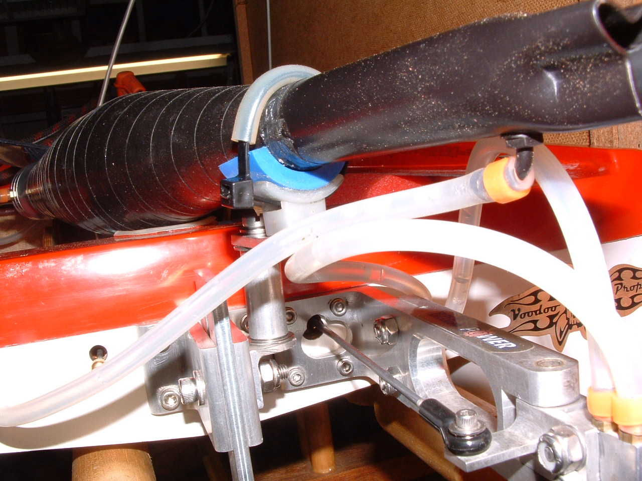

Yea Basically a small piece of 1/8 inch wall 90 degree angle aluminum attached to strut blade anchor screw, a stub of heavy wall aluminum tubing topped with an aluminum arm and pipe saddle, all tightened together with a single 10-32 screw down threw it.
Beauty of this is it can be swung left to right finding the natural center of pipe not binding the coupler o-rings. Strut can be adjusted without effecting pipe support position. Very K.I.S.S

Couple things. Why did you smash the end of the pipe into that shape? Have a nipple at the end feeding water to the pipe...Is that for sound dampening and how do you keep the water from flowing back into the cyclinder? Pretty creative stuff going on there Scott. I like it. Kind of the Mad Scientist.

Pipe end is nothing more than a chunk of cut off 7/8 SS header.
Crushed tip in a lathe chuck ... It breaks up sound waves more helping eliminate the distinct Raspy crackle. Waste water from cooling exhaust manifold and pipe/header connection used to further take away noise.
( BTW pipe is a 1" header internal stinger Power master ) So already pretty quiet, this takes it down to @ 87-88 DBa :drinks:

Not really the case, I often stinger down the outlet of tuned pipes to get a broader power band and a harder top end hit.
Many times adding a muffler will show gains in performance and not a loss ;)
In application the PM pipe shown in an internal stinger design and typically a +/- @ 90 DBa pipe. The addition of the 3 way tip and water cooling just takes it down further with ZERO effect on the state of tune with chosen stinger size.
