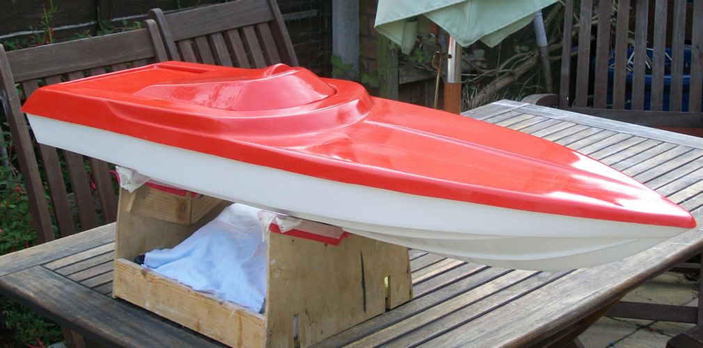

Sorry to say it but thats not a great boat for running on the sea mate not enough free board(height from deck to where side joins bottom or chine as its called).Best get something with more freeboard to run in those conditions then you wont get so much water inside the hull.apache or similar would be ideal for such conditions,or something like this maybe,sorry couldnt resist showing my design :laugh: .What you have there is yet another Lynx copy,also known as silex,delta force etc.Good runners in lakes not in the sea in my opinion.
Mart
