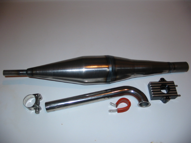

If your budget is not an issue, here is a good exhust system to consider buying, a 2 stage 1" or 2" band pipe system, stainless steel header and no leak flange, $185.00us.

Thanks, but I did say that I'm on a budget... anyone know of something in the 50 dollar range?
#7465
marc replied the topic: Re:Need a little help on my first purchase
If you want to stay in the $50 range, you will have to stick with a stock canister muffler or find a used pipe somewhere, but $50 will be hard to do for a pipe.
#7466
Just saw a QD pipe in this post: www.modelgasboats.com/option,c...atid,3/id,7401/ $75. That could work for you.
#7468
vick22 replied the topic: Re:Need a little help on my first purchase
Thanks Marc, found a tuned pipe set on ebay for 58. Some chinese stuff... probably junk but it will work for the time being.
