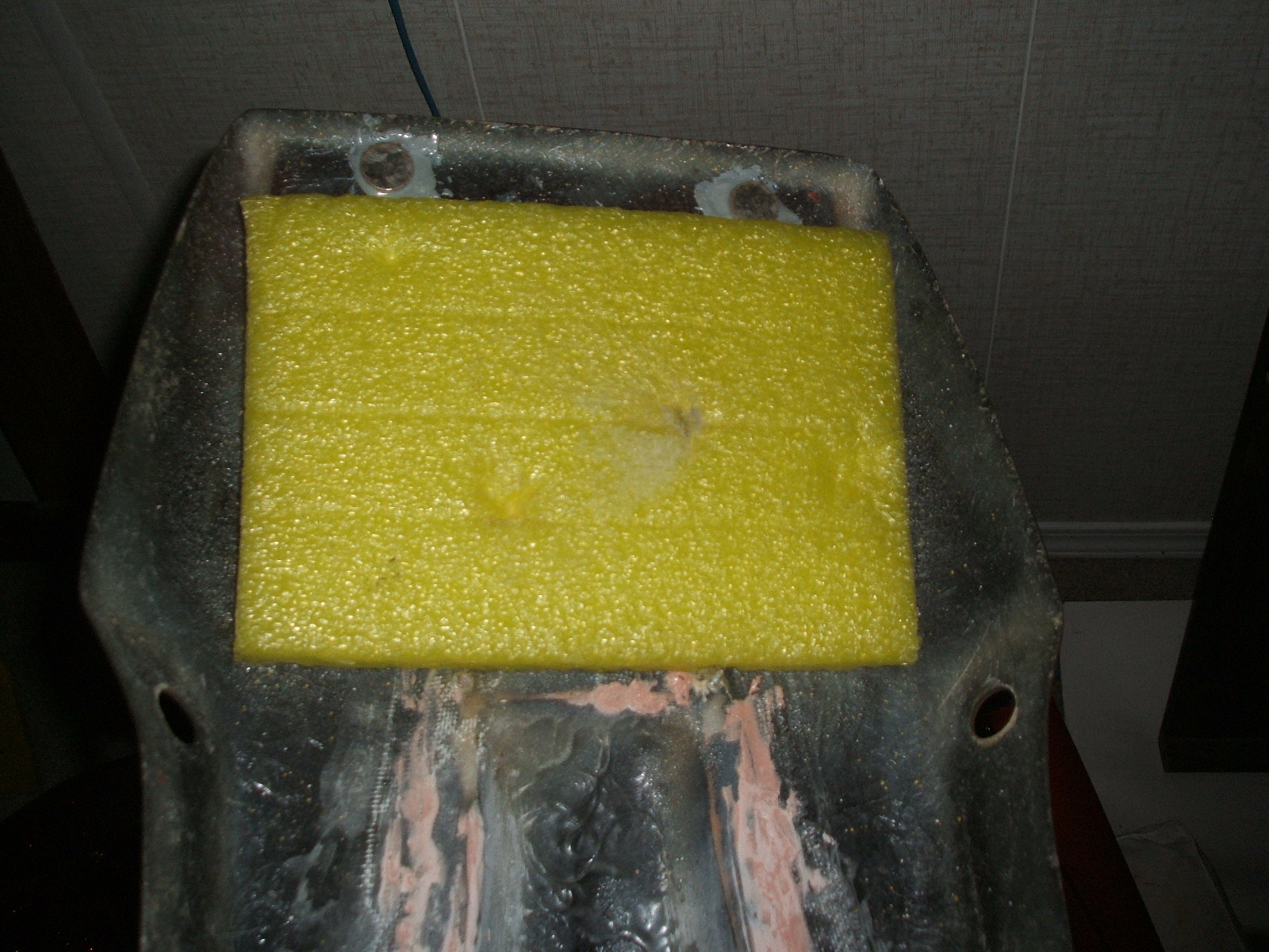

we just glue some of the flat (swimming noodle stuff) to underside ... just enough to make it float. When we tethered before it torn out and damaged boats. Just a thought we have rescue boat though..
#7396
Tropheus replied the topic: Re:Cowling Tethers
Ditto that. I use bondo with noodle foam to put a small piece in my cowls. Doesn't take much.
#7517
marc replied the topic: Re:Cowling Tethers
You can try Gorilla glue on the foam in the cowls, works great. Add a little bit of water, glue and let set. :) Don't put too much, it foams up.
