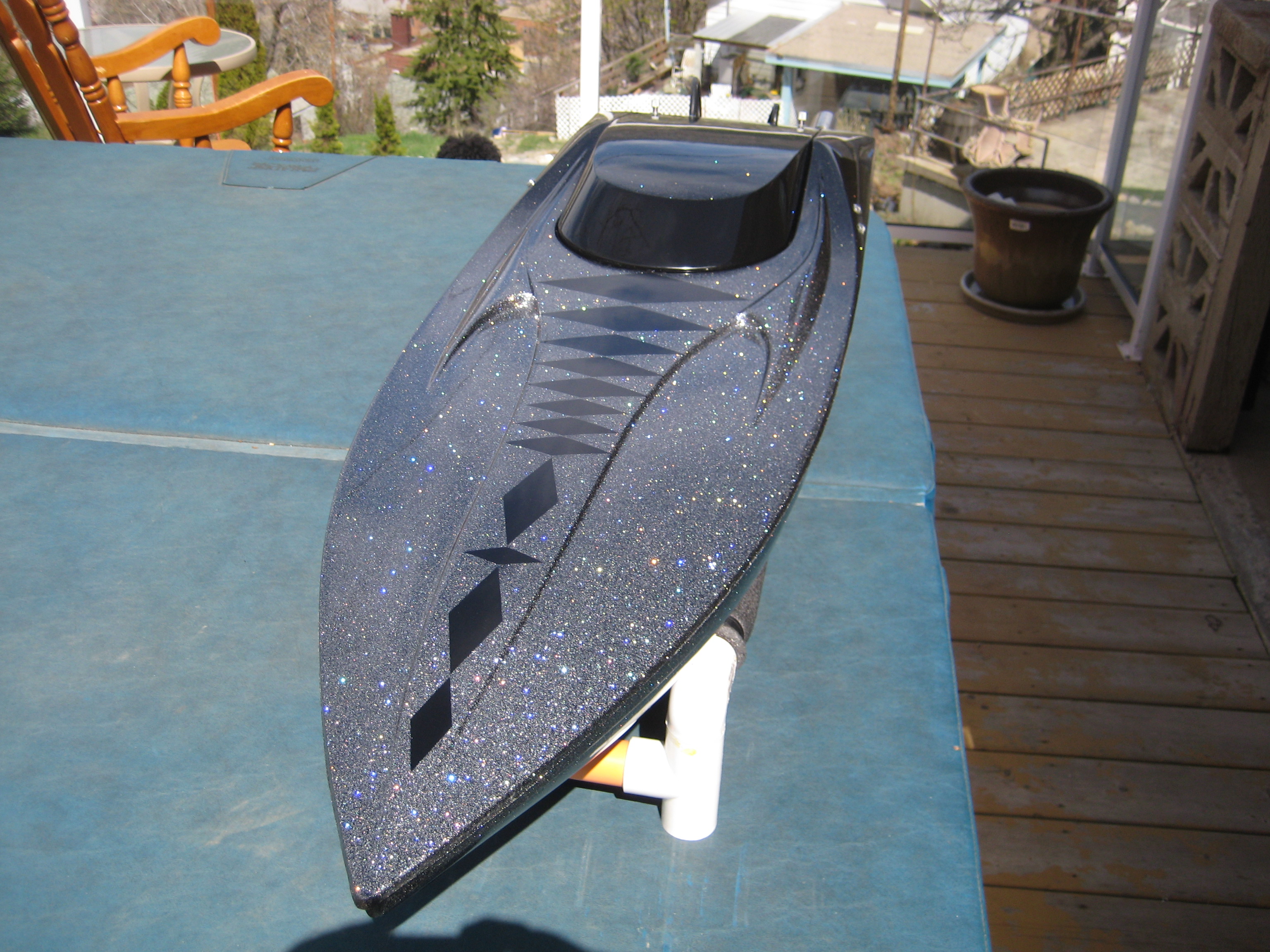

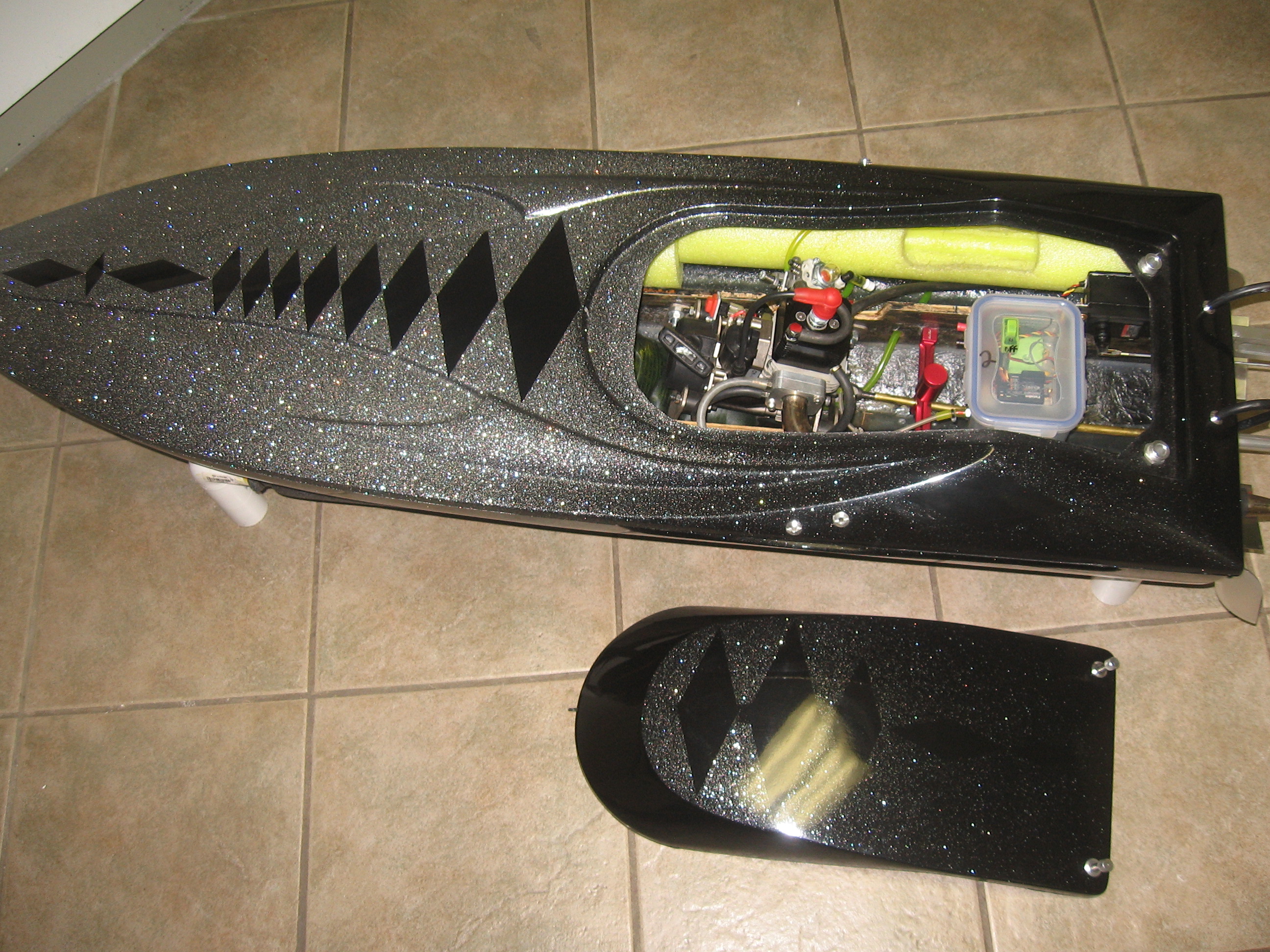

bronco78 replied the topic: Re:carb of choice to all boaters
Just thought id throw-in a pic or two of my sikk.
