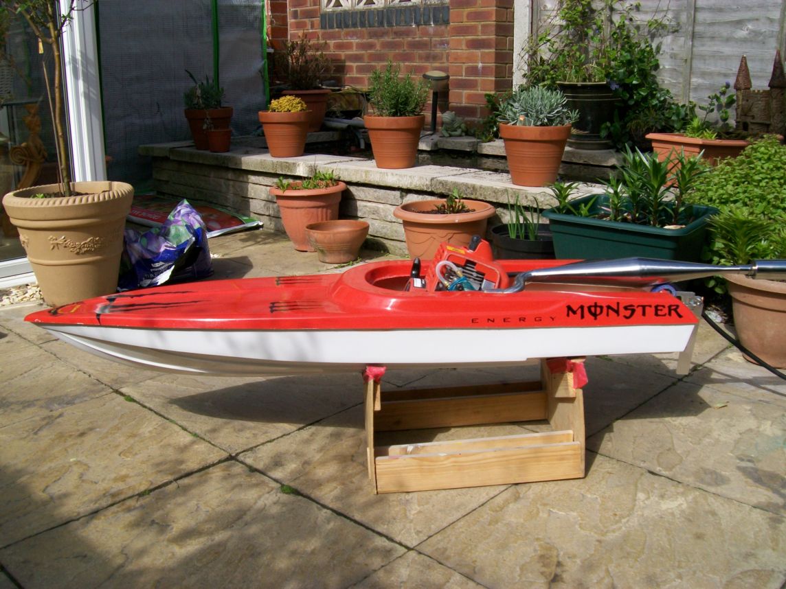

Hi if its a stock weedy id go for the bigger props like the 280,i ran one for a year on mine with good sucess.Ive just recently built a boat (my own design) for someone with a slightly ported weedy with a stainless steel customised pipe and its running the 6717/3 prop,i tested it for him and she ran quite well but wasnt quite hitting peak but ive since done some work on the prop for him so she should run even better now.Still thinking a two blade prop might work better but we shall see.He will be testing her out this weekend all been well.Heres the first test run with no strut adjustments.

martno1fan replied the topic: Re:What size Prop?
Heres a pic of her
