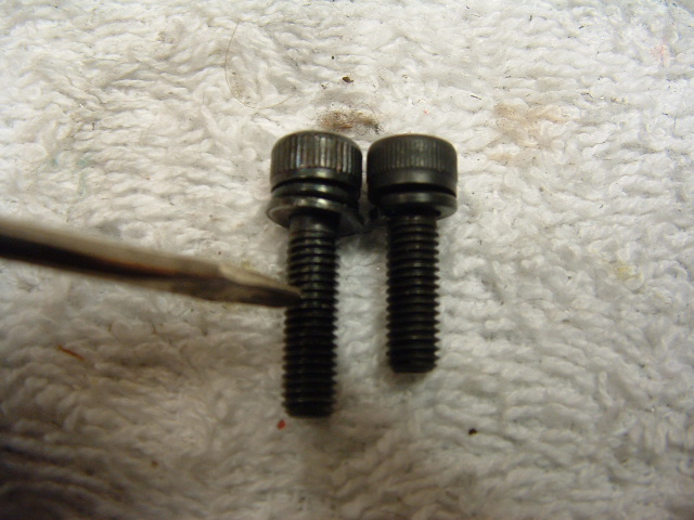

hi people check your head bolts as mine fell out !! no damage from what i can see & its running again:diablo:

Yea, an issue that for reasons of staying politically correct in not saying anything bad, was never mentioned.
Not that there is a quality or material issue, but RCMK has choose to use ones that are IMO too short !!
Replaced all mine with ZENOAH stock cylinder bolts.
Reattached with BLUE loc-tite :drinks:

Hi,
I could not agree more, listen to Scott. I replaced mine with stainless steel bolts of Zenoah length. You will not regret this move.

Stainless is OK, but if you use the 18-8 stainless that you buy from your local hardware store or McMaster, they stretch and will come loose. If you insist on using stainless, use domething like heat treated 17-4. The only problem with 17-4 stainless is they will cost you about $5.00 or more each "if" you can find them. You are way better off to use the heat treated carbon steel bolts. Scott is right. Use the ones from Zenoah.
