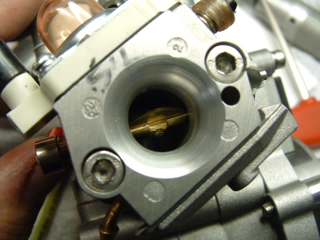

Scott replied the topic: Re:rcmk pull start
Yes, if a thin mount is used on the mag side ? ... you need to place a single #10 washer on each mount post.
* If you look at "How Far" the mount screws comes threw the threaded portion of case, they should be just flush.
Not the correct picture really, but NOTE the mount screws coming threw the cases mounting boss's. One a mount is fitted they need to be flush, shim with a washer or two per post until they do ;)
