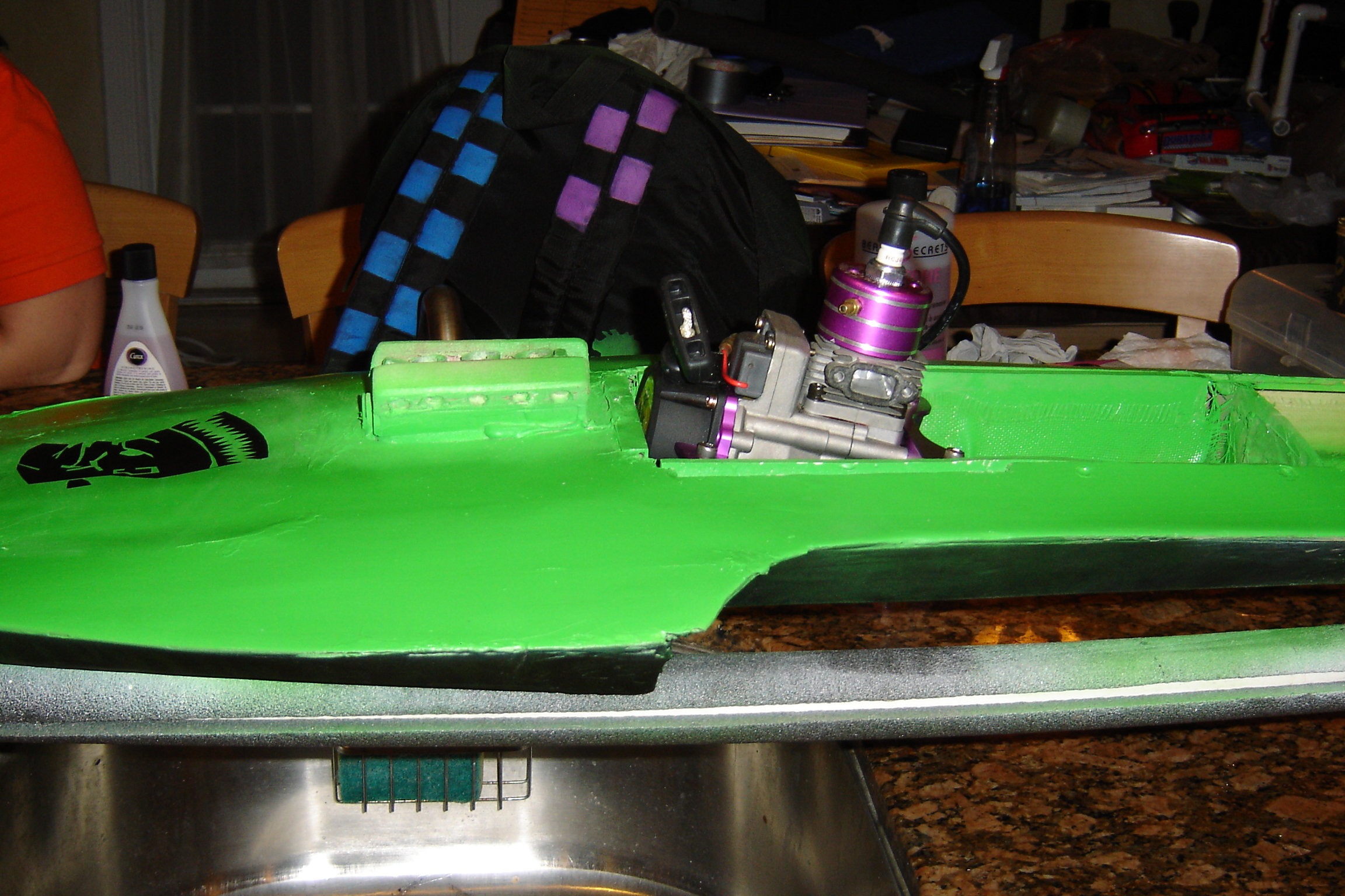

my 36 inch hydro converted 2 gas have not runn it yet motor is a 23cc what do u guys think

marc replied the topic: Re:project
Hull seems a bit small for gas, but if it runs, it will be fast!!!

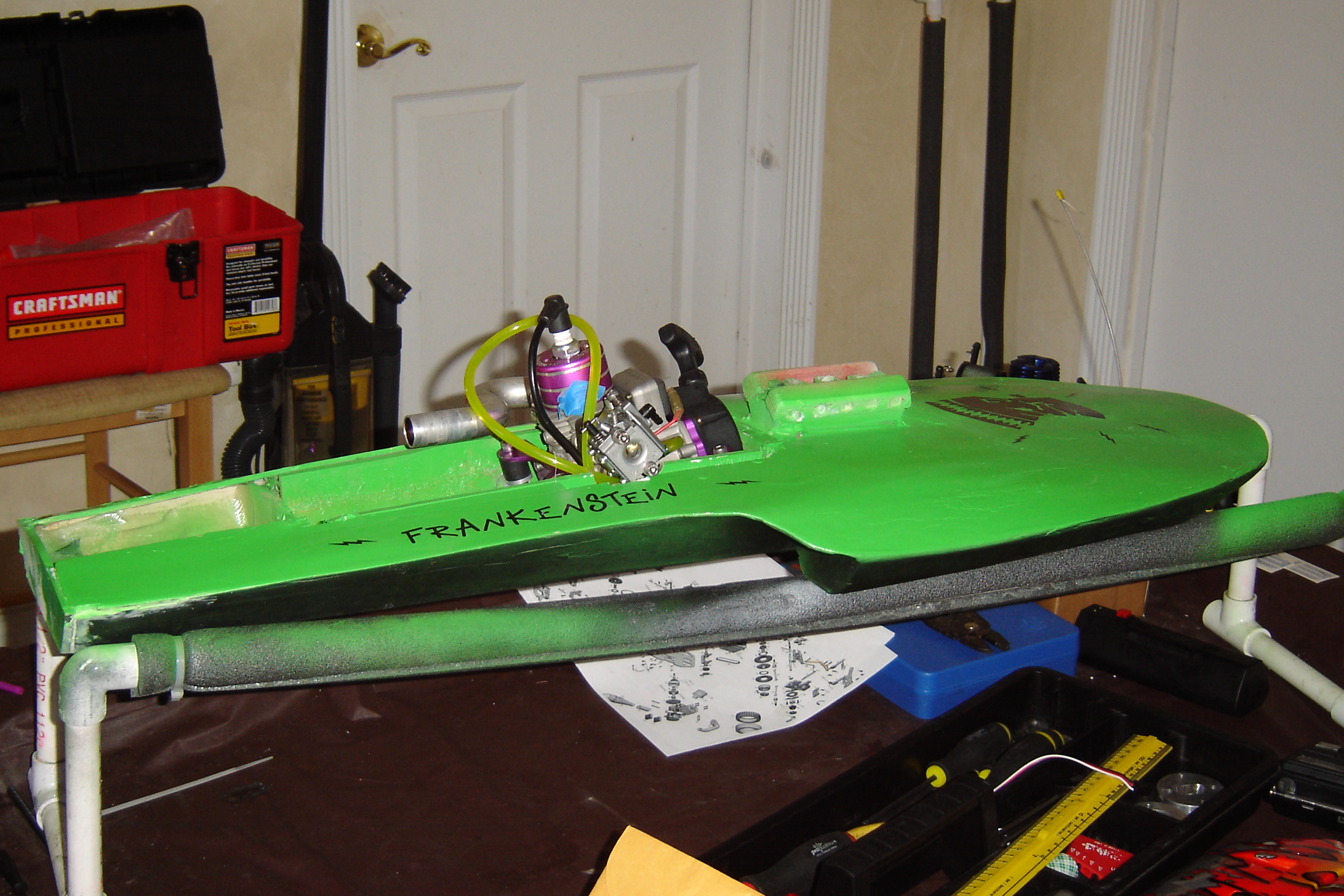

sandjperformance replied the topic: Re:project
i will take a pix of the hull from far so u can c the whole boat hope it runs
this is the hull

Scott replied the topic: Re:project
Seeing that perspective .... engine is WAY too far back.
The drive cable collet of engine should be at @ the end of the sponsons ride surface with engine completely forward of that position.

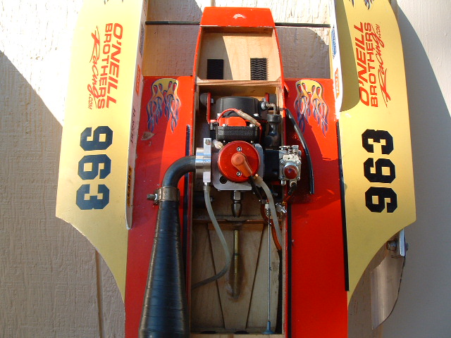

sandjperformance wrote:
It was already said ... The drive cable collet of engine should be at @ the end of the sponsons ride surface with engine completely forward of that position.
Attached an image of a typical engine position used in Gas Sport Hydros.
The Sponsons TRAILING edge is just behind the "3 and 9" numbers where the outside edge of sponson turns inward.
* Location should be about where your "DUMMY" engine is at :ohmy:
