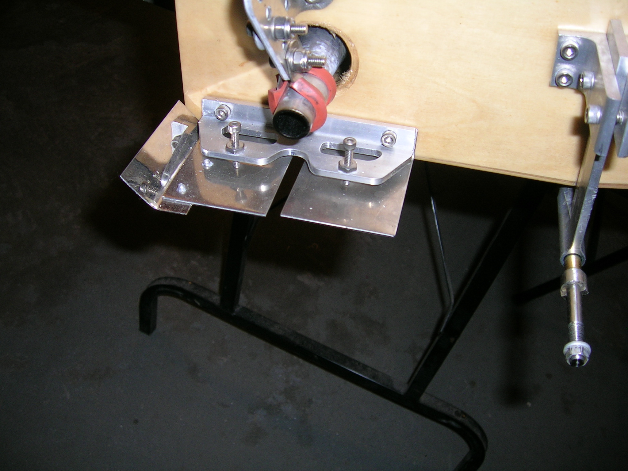

I have never seen a non trip tab. Do you have an example you could post a pic of? Where did you get yours?

marc replied the topic: Re:Crackerbox Driving Technique
I made mine by modifying an existing regular trim tab. Here is a picture. I will be making new ones which will be longer...the rules allow 4" behind transom, so mine will be close to that length on the new Cracker.

mitchesx replied the topic: Re:Crackerbox Driving Technique
That's pretty cool.... How'd you attach it to the existing tab? My tabs are a lit closer to the strut, will I still be able to try something like this?
#6381
I used rivets and filed them down as much as I could on the underside. Typically you want this non-trip as close to the chine as possible. The new ones that I make will have the non-trip as part of the original tab...no rivets. It works fine like this though.
