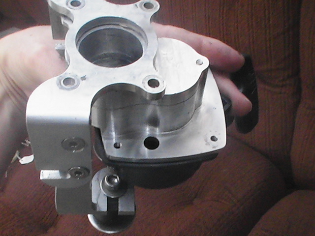

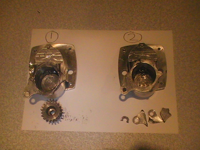

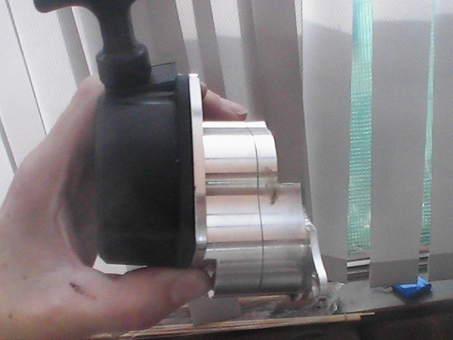

hi anyone else had this problem number 1 has 6 hrs run time. Number 2 has 7 hrs run time:dash: :dash: :dash: :dash: ..

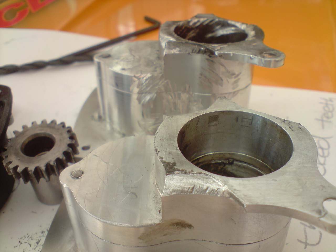

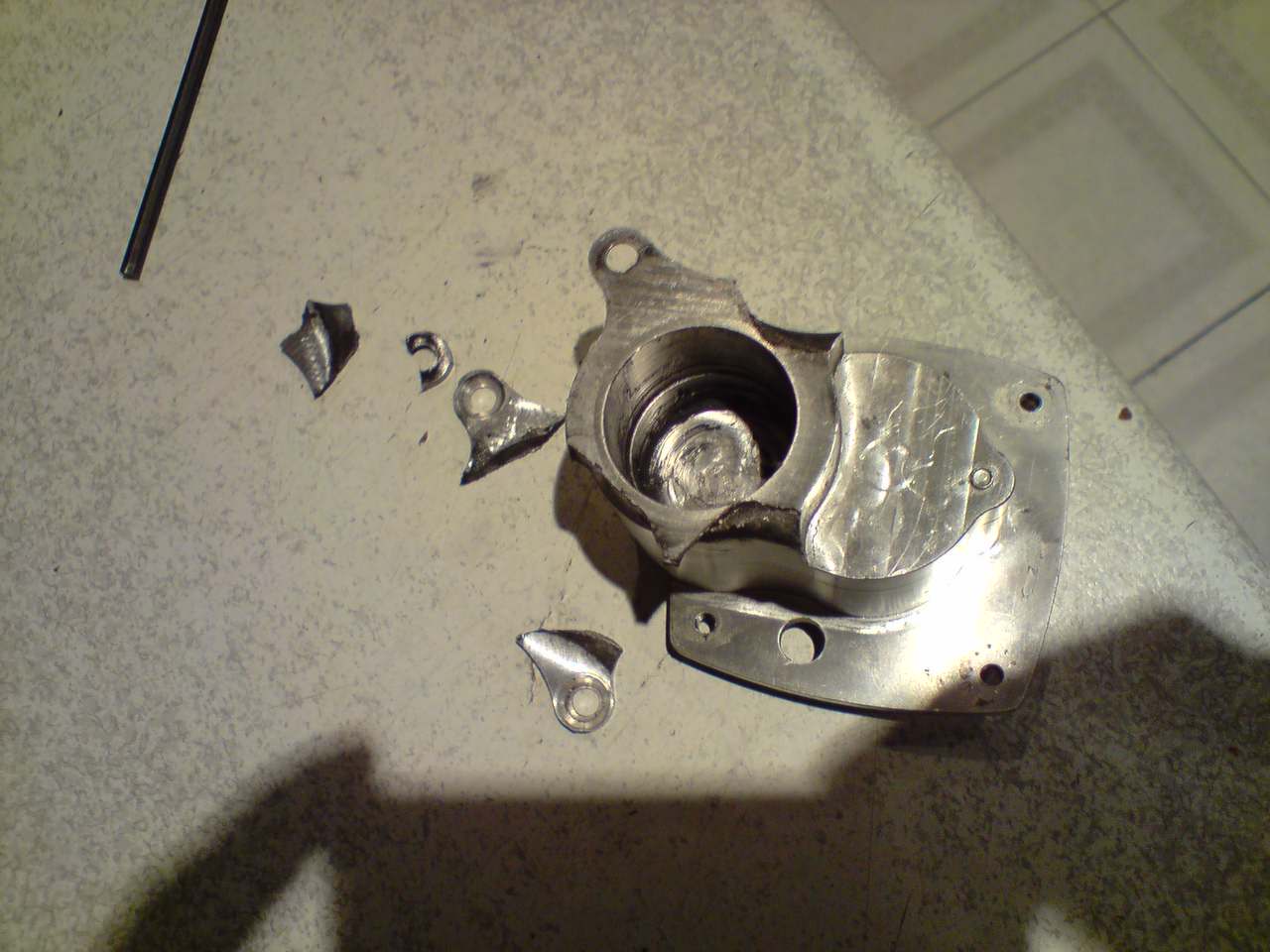

i do check all the bolts often & do also thread lock them they were all tight still holding the broken lugs on ..typical i was ment to be out today at a organised event :cry:

marc replied the topic: Re:reverse pullstarter kit from bonzi 2nd one broken in the same place
That's bad! Do you have a link to these on their website...I don't think I've ever seen these before...would like to see how they fit on and how they work.

wayneuk01 replied the topic: Re:reverse pullstarter kit from bonzi 2nd one broken in the same place

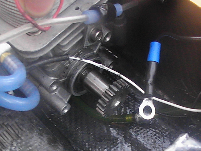

The stock pull start fits on the unit above & when pulled it engages on to a gear fitted inside the unit wich in turn spins the gear the wrong way thats connected on the crankshaft on the reverse engine

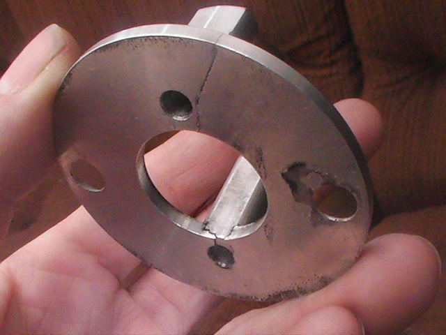

more pics I dont think they advertise them on there site its there reverse pull start kit they also built the mhz boat ....Between this one breaking & the previous one the reverse clucth arbour also broke cracking exactly the same they have revised that part as it was too weak but ive still the old style one as it would involve redoing the engine location & i dint want to tear it apart..

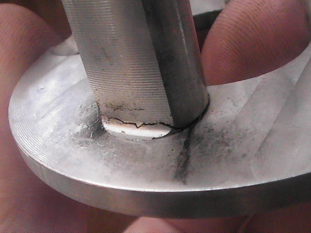

reverse clutch arbour
#6135
pic 2 reverse clutch arbour
