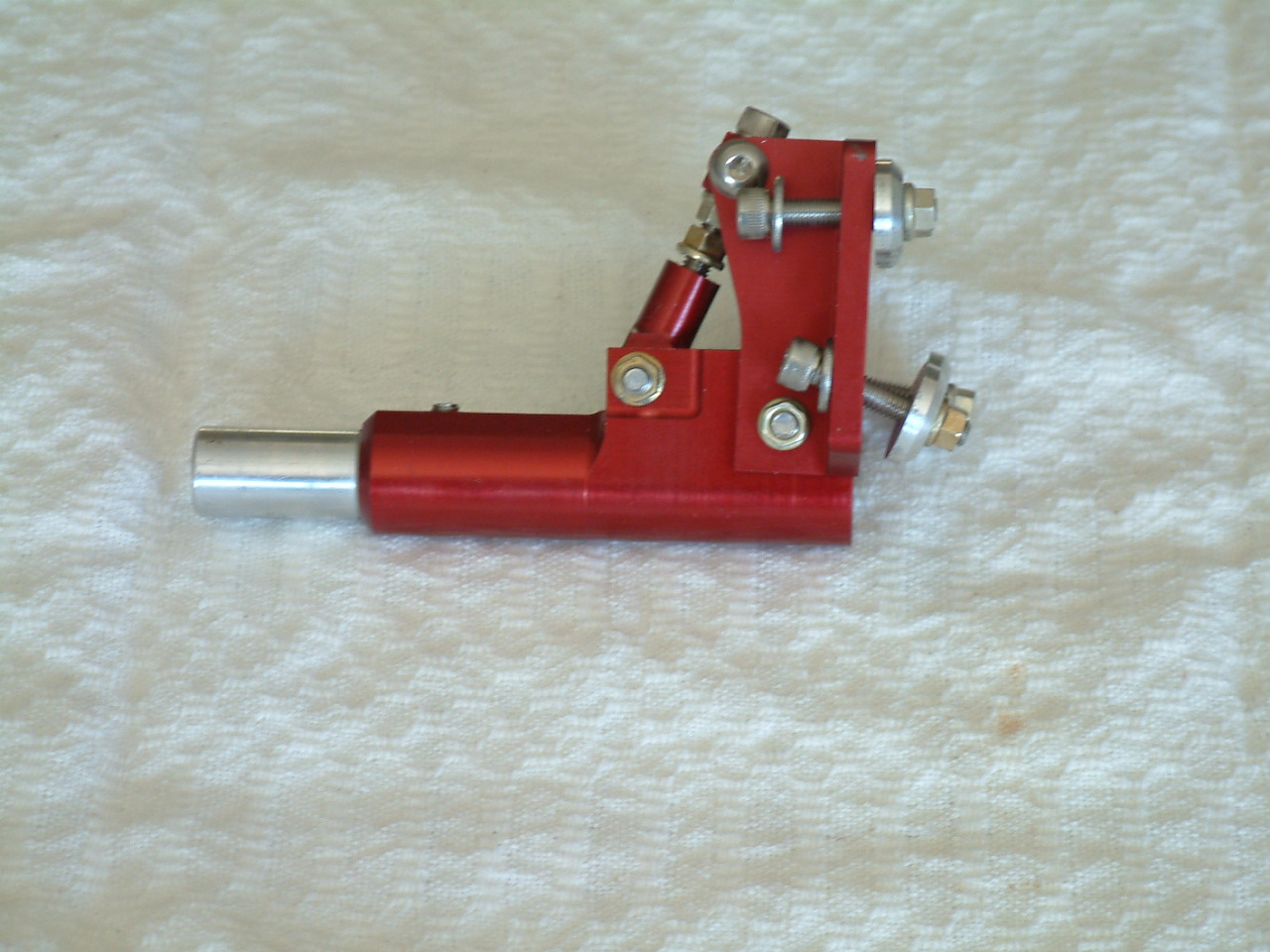

In terms of handling and getting the prop out far enough to find cleaner water too bite into, the Stinger drives excel :dance2:
They are the preferred racers set-up.
As to cost and just keeping it simple, a typical strut and brackets Get-R-Done good enough for play boats.

One definite advantage to some stinger drives is the use of a "Cartridge" type extension. In these types the stub shaft stays with the cartridge and is used with a flex ferel type connector using a soldered on square drive cable.
A single set screw is all that holds the assembly in place.
a VERY quick and easy too service & lube cable set up !!
Another advantage of Stinger drives is the the ability to hold trim adjustments. There design offers much greater BEEF within the assembly and holds up better in rough surface drive applications.
Weather a Single turn buckle or Twins holding the output housing, the accuracy and strength is much greater than a strut blade squeezed between two brackets IMO.

The stinger is a lot easier to adjust especially if tou want to move the angle 1/4 or 1/2 degree. With a strut, you can eyeball it and tell yourself that is about right where with a stinger, all yoi need is a 1/4 inch wrench and a 5/32 allen wrench and you're good to go.
