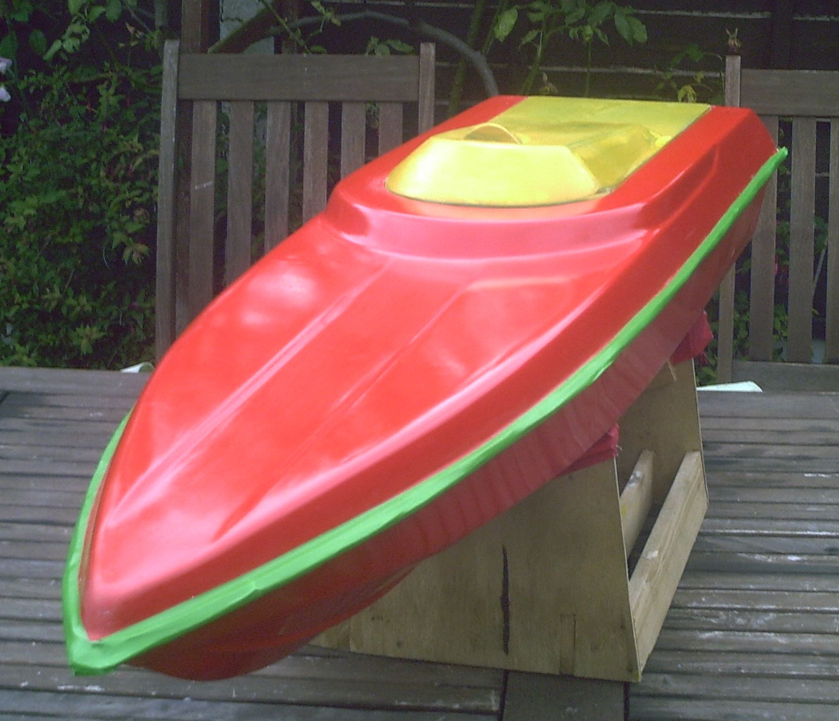

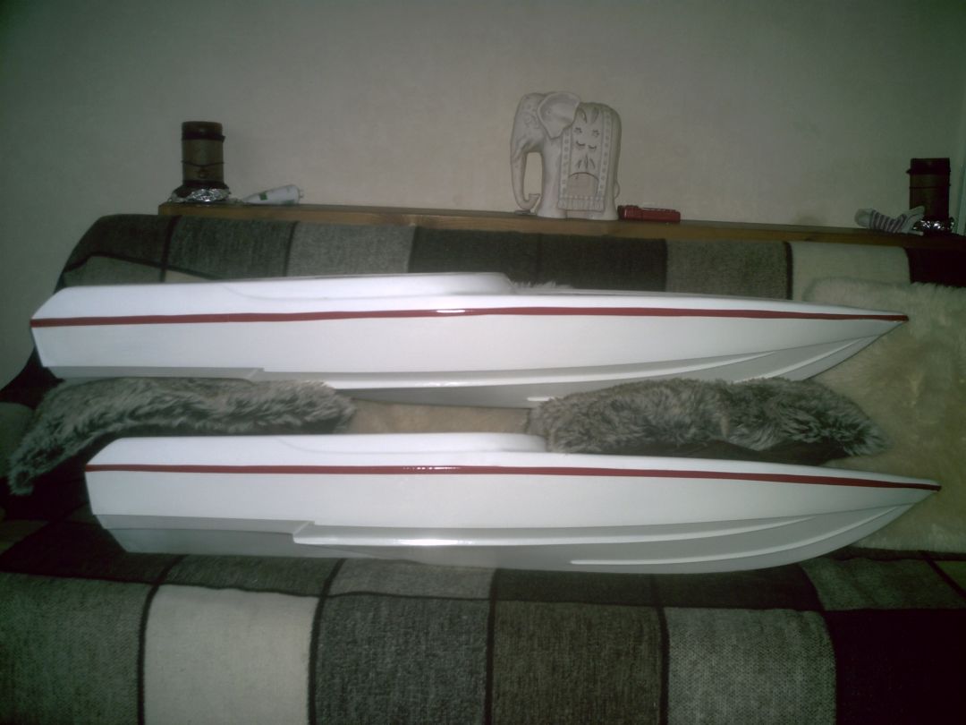

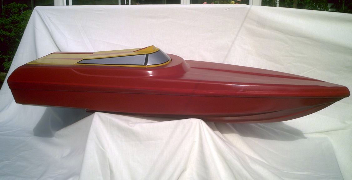

Hi guys some might know last year i started building my own deep vee hull,i took an old discontinued hull i had ,made some alterations to the design and made it a plug then a mould and heres some pics of the finnished hull.After some more thinking i decided i could make the boat even better by making her more sleaker and lowering the height as shes a very big boat height wise.I removed 2" of height on this design at the back made the hull a tad longer by 1" and reduced the step by 1/4".I designed a new hatch as my old one never really had one.Main reason behind it was i liked the orriginal but could see it had more potential with a few changes to its basic design and seeing as it was discontinued i thought why not.Ive since sold a few, more as a way of funding the hobby than as a buisness.So far ive had good feedback from those who have them,heres a few videos i was sent by one guy who i sent two to.Also a few pics of the larger style and the sleaker version so you can see the changes i made.

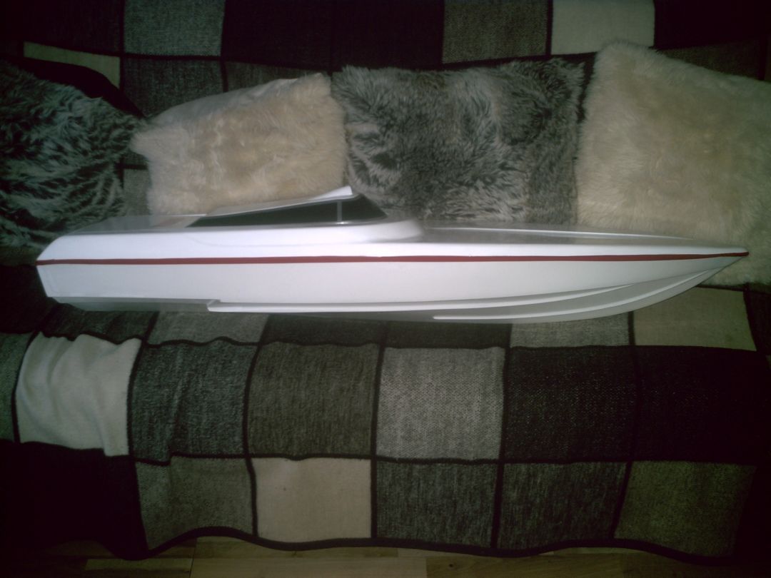

Heres the newer sleaker versions i sent him when he sends me the pics of what hes done to them ill post a cpl.

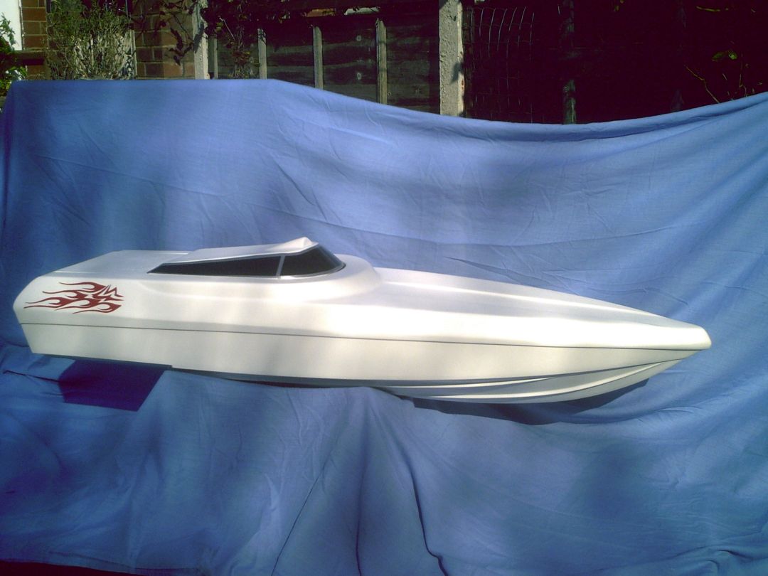

Heres one with a hatch ,pure white gelcoat on these apart from windo decals and vinyl stripe to cover the seam which is smooth but rather than paint over i used vinyl.
