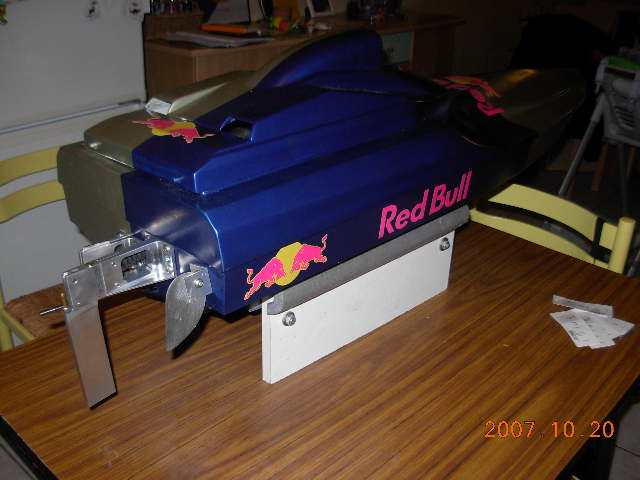

i put an picture of the rear of the hull
the hull do 8kg RTR
normaly , the engine is including with the tunned pipe , hanson put an line in yellow paint to show the good setting.
the picture to show you, and know what propeller can i use.
i looking this evening were is the C.G and a say you.
thanks.

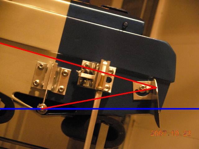

furet88 replied the topic: Re:need help to adjust my hull
another

marc replied the topic: Re:need help to adjust my hull
How big is the boat and what is the engine? Zenaoh modified?

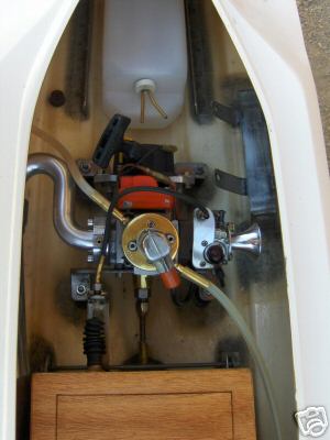

the boat is 1200 mm of lenght with rudder.
the engine is a zenoah g230 pum modified by hanson with pipe hanson too.
hanson call this modification " gold" the top (water circuit)of the cylinder is in gold colour.
this modification was made between 5 or 6 years ago.
i don't have the number part of the carburetor in head but i look this evening.
can see the engine on a picture when i have bought the boat.
#4709
I would probably leave the engine where it is then...or make sure not to go much more than 30% with CG. I would thing some of the following props should work ABC G20, Prather 270, Octura 470, 472, 670. These should be in the ballpark...

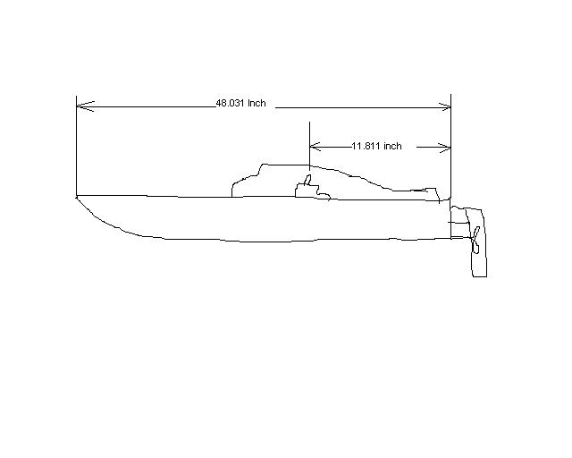

also , the carburator is a walbro WA 167 A
the hull lenght without rudder , is 48.031 Inch and the canter of the engine is at 11.811 Inch of the back board.
this make 24,6% It is a little bit just not?
i join a litle draw (don't laught!) :lol:
#4713
Here is a good article on finding the CG of your boat: www.modelgasboats.com/Magazine...er_Balance.html
Find out where yours balances and let us know. I would shoot for about 30% to start. The distance of engine to transom really means nothing. You have to know where the entire boat balances...that is your CG. :)
