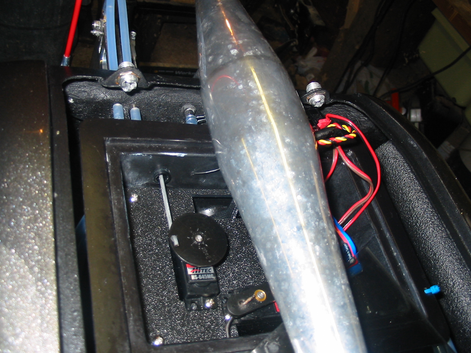

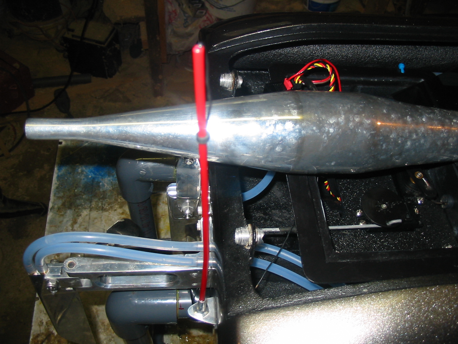

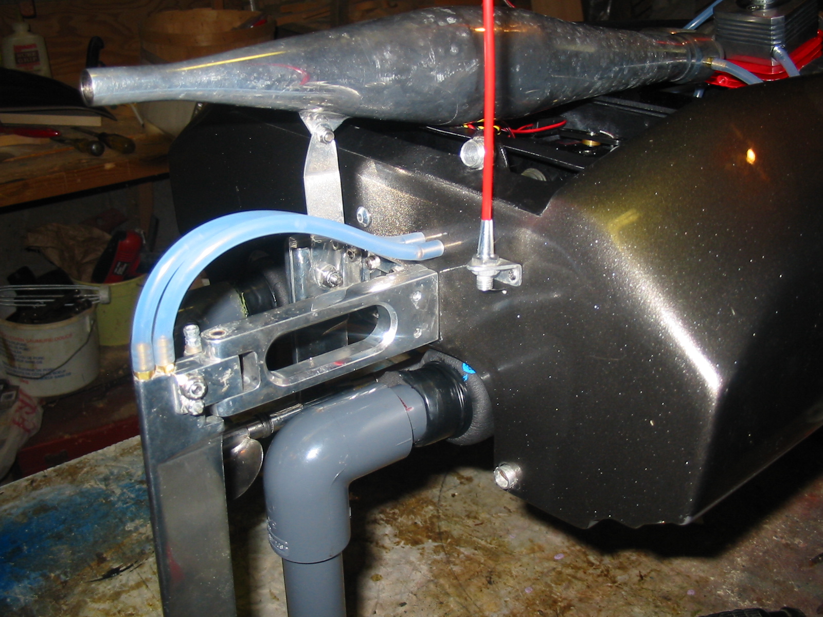

rc_gas_boats replied the topic: Re:sterring problem
heres some pictures of it

golfvits replied the topic: Re:sterring problem
Try to avoid the Z bend from the servo and replace the sterring rod it is not strong enought make one more thiker 3mm (1/8).

marc replied the topic: Re:sterring problem
What is the voltage of your receiver battery pack? You stated 1.2 volts above but that can't be correct...should be 4.8 or 6.0 volts. I checked the specs of that servo and in my opinion it's not strong enough, especially if used on 4.8v. It produces only 107 oz. of torque at 4.8v. At 6v it produces a little more at 133 oz. It would be acceptable at 6.0v assuming your linkage is done correctly to take advantage of mechanical forces...ie: linkage attached close to servo shaft at servo end and furthest away from rudder at rudder end. This will make the servo use more of it's throw for rudder movement and will give it mechanical advantage. I typically try to use 1/4 scale servos with about 200 oz of torque for steering.
As mentioned, get rid of the Z bend. Also I would suggest a steering arm on the servo instead of the wheel...will allow for linkage setup as mentioned above. Use a heavy duty clevis on the rod, ideally soldered. Keep linkage straight to the rudder, no bends. Use another heavy duty clevis or ball link at rudder. A 4-40 rod has always been sufficiently strong in all my builds. If you want Stainless, a bicycle wheel spoke works!
