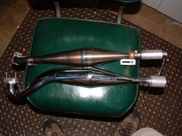

Scott replied the topic: Re:Who makes a muffler for Profession (China) pipe
Another pic
I had originally left enough of the 1/2 O.D. stinger hanging out to attach a TYSON muffler. After running it found the muffer was over kill and not even required to be sub 90 DBa

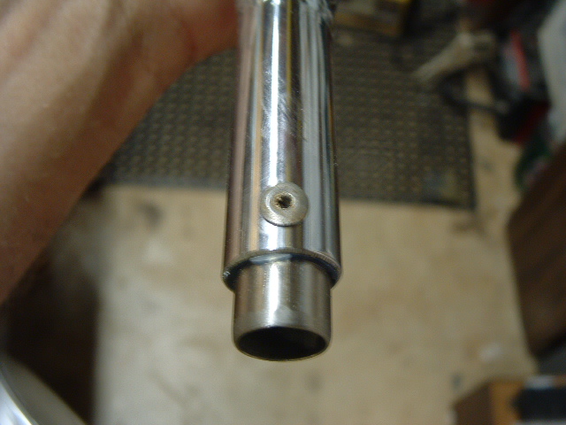

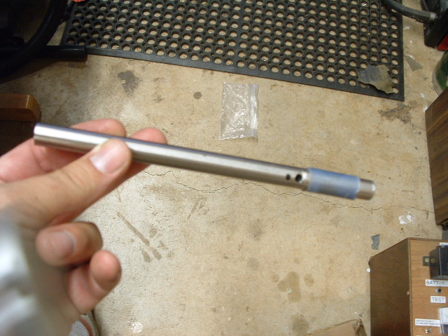

Ronald Olson replied the topic: Re:Who makes a muffler for Profession (China) pipe
Thanks for the help Scott. I made up an internal stinger for it from 2 pieces of brass tubing, one sleeved over the other for a better fit then JB Welded into place. The larger outer one only goes as far as the stinger does.
Now ot see how it works when the boat shows up later this week and I get time to hit the water, probably the holiday weekend.

Ronald Olson replied the topic: Re:Who makes a muffler for Profession (China) pipes?
I followed what Scott told me. Inside the stinger it stops a few inches inside (a weld or something in there). I used the 1/2\" brass tubing then the next size larger and it was a god fit. Some JB Weld took care of what little gap was left. I driled a hole near where the two pieces met for oil drainage.
After finally getting it fired up it does sound loud yet but once I hit the water and see what my dB meter says then I'll know if it's going to need more muffling. It should be easy to put just about any popular muffler on it if I need to. The internal stinger should come out fairly easily then I can add some extra to fit one on.
